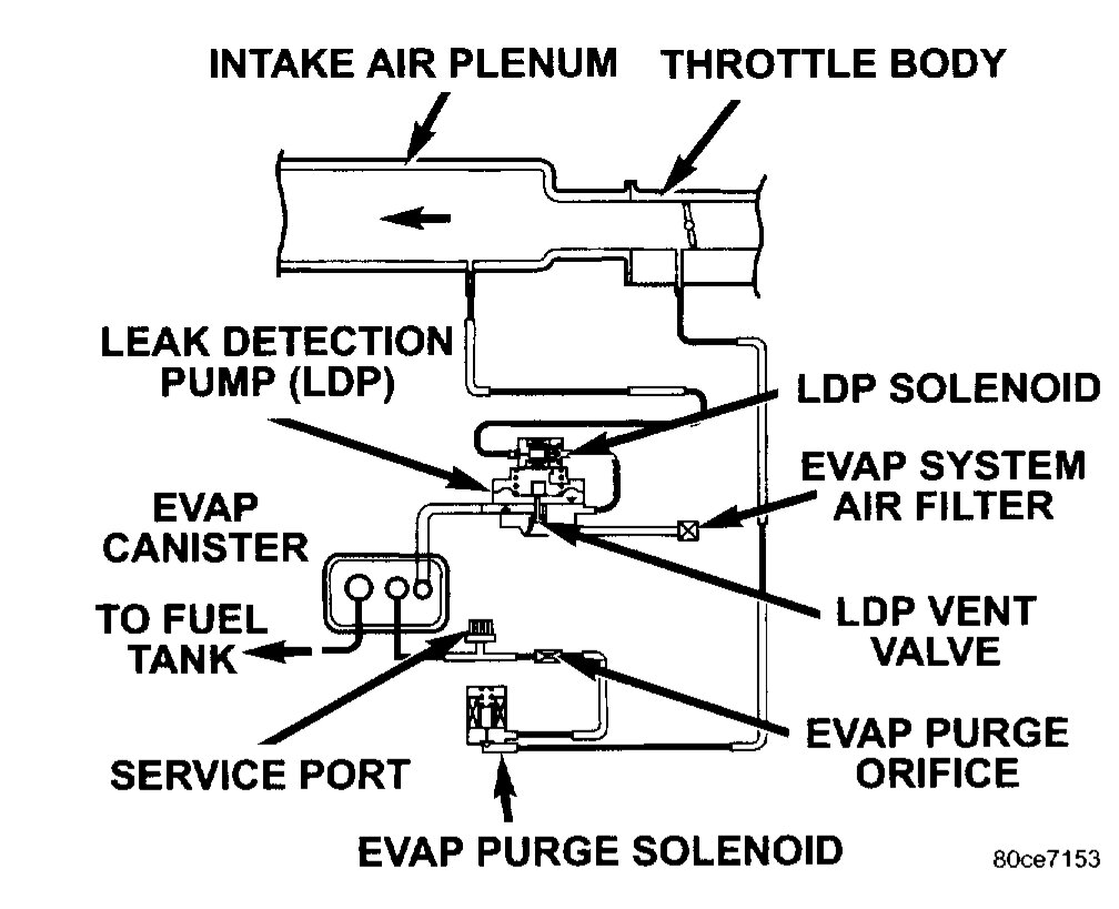

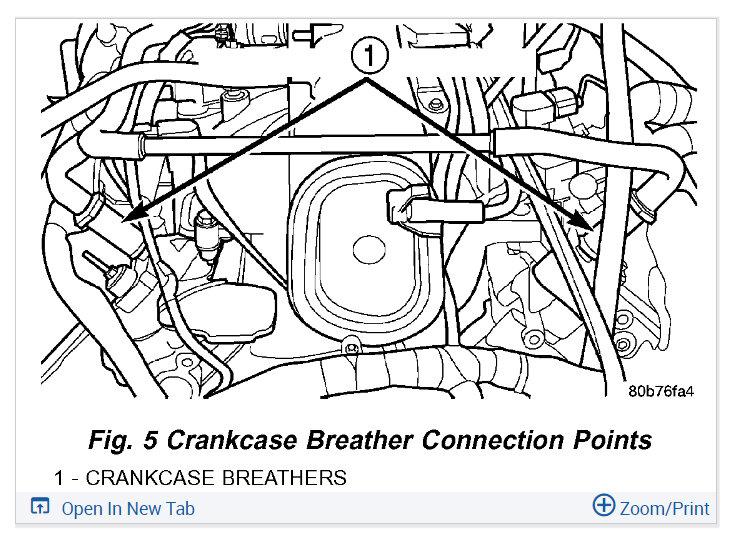

I'm in desperate need for the vacuum hose diagram for my 2002 4.7L. Can't find one online anywhere.
Sep 25, 2024 at 2:06 PM
  • 55,433 POSTS
Yep, they are hard to come by the dealer does not release useful information on this, here is what we have. Sorry we were not more help. Check out the images (below). Let us know if you need anything else.
