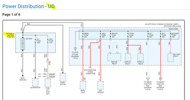

Diagram for the cables to hook to the Battery Terminal needed
2013 HYUNDAI ELANTRA
142,000 MILES • 0.5L • 4 CYL • 2WD • AUTOMATIC
AGC11003
Diagram for the cables to hook to the Battery Terminal Junction Box Wire Fuse diagram.
Apr 28, 2022 at 12:27 PM
  • 110,244 POSTS

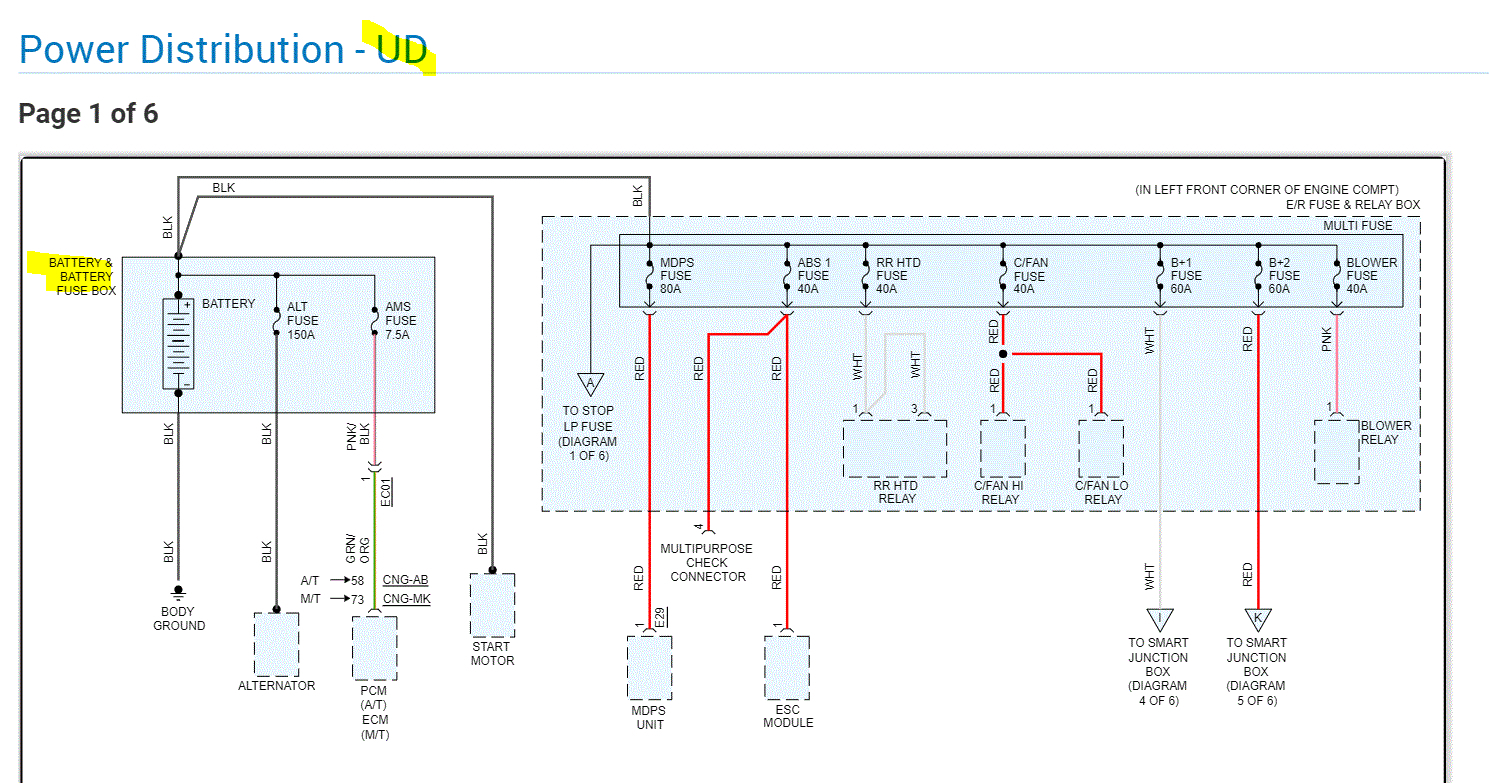

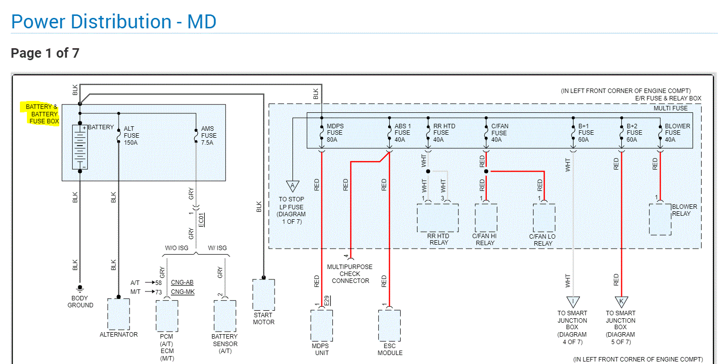

I'm not certain I completely understand what is needed. However, I attached two pics below showing the battery fuse box.
Note there are two different ones based on where the vehicle was built. They are identified as UD indicates made in America and MD indicates it was made in Korea.
Manufacturer information will be indicated under the hood on a label either on the radiator support or the underside of the hood.
