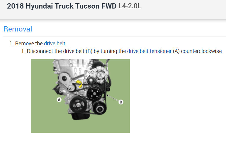

Needing Diagram for serpentine Belt?

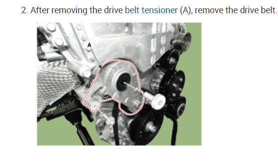

Sure, here are the serpentine belt replacement instructions with the belt routing as requested. Check out the images (below). Let us know if you need anything else.
