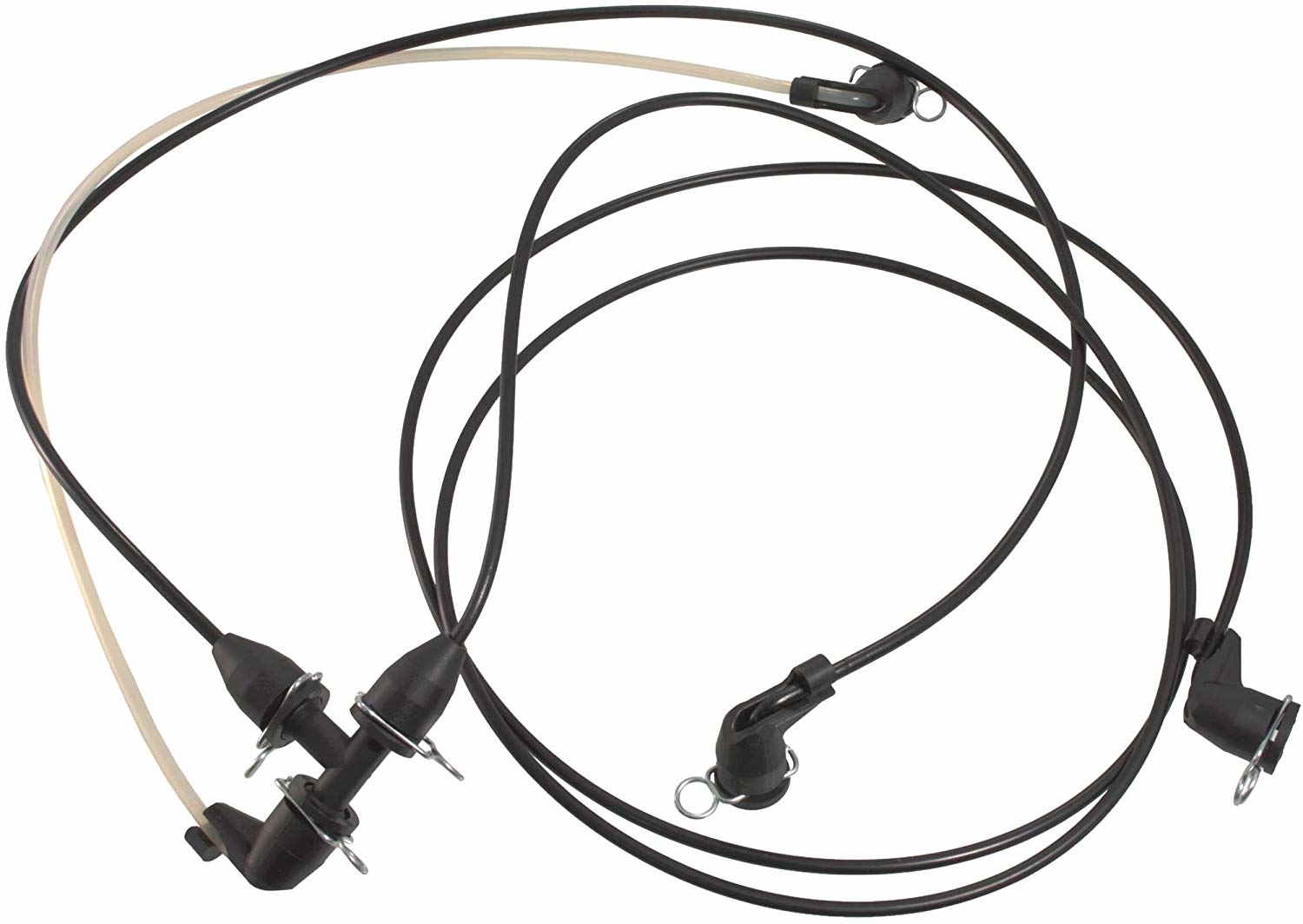

Looking for diagram to run new air lines from compressor to rear shocks.

I cannot find any diagram of the routing that would actually help, they just show the rear shocks and the compressor, nothing in between, however it is easy to follow once you can look at the system, the lines are run through in the same locations as the wiring harness and the same type of poly-loom. You can get a complete line kit at many parts stores and just follow the lines from the compressor out to the shocks. You can also buy just repair connectors for the line as well if you have a leak. For those you just cut the line at the leak with a sharp blade and the line just pushes into the connector. Is yours leaking down or some other issue?
