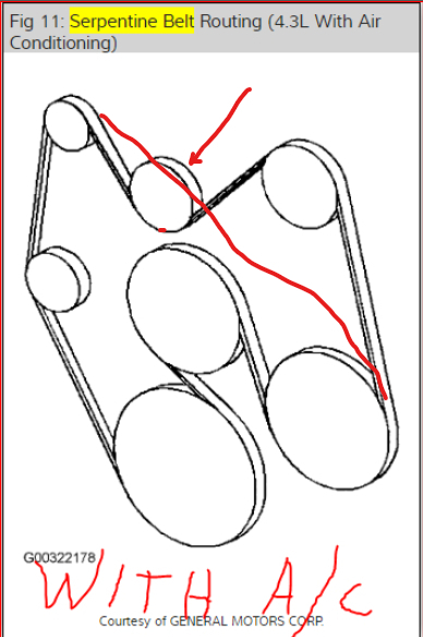

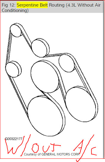

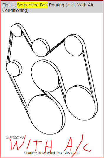

Replacing belt by bypassing the A/C.
Dec 17, 2018 at 9:49 AM
DANNY L
Experienced Mechanic
5,648 POSTS
Hello, I am Danny,
I've attached two pictures of the belt diagrams one with A/C, and one without.
I've also attached a tutorial show how to replace a serpentine belt.
Usually if your car is equipped with factory air the compressor has to be removed and an idler pulley put in its place.Hope this helps and thanks for using 2CarPros.
