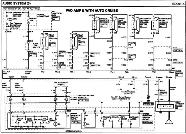

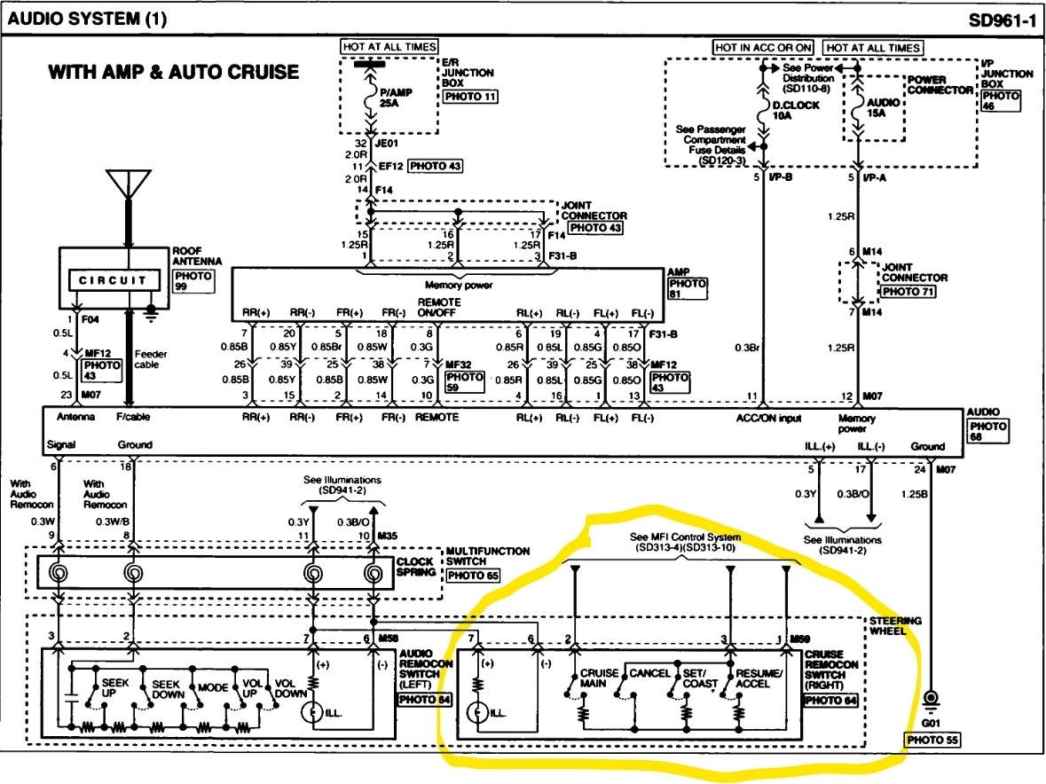

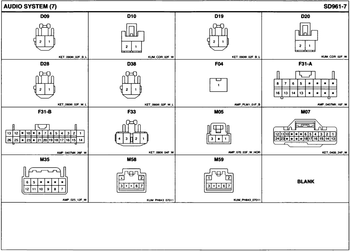

Can you help with the wiring diagram for this car radio.

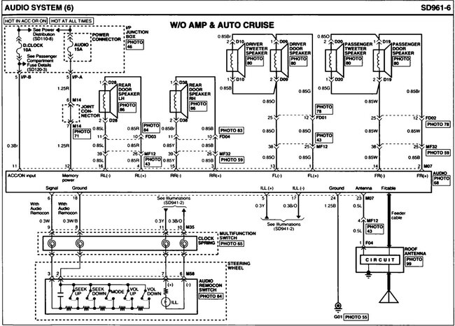

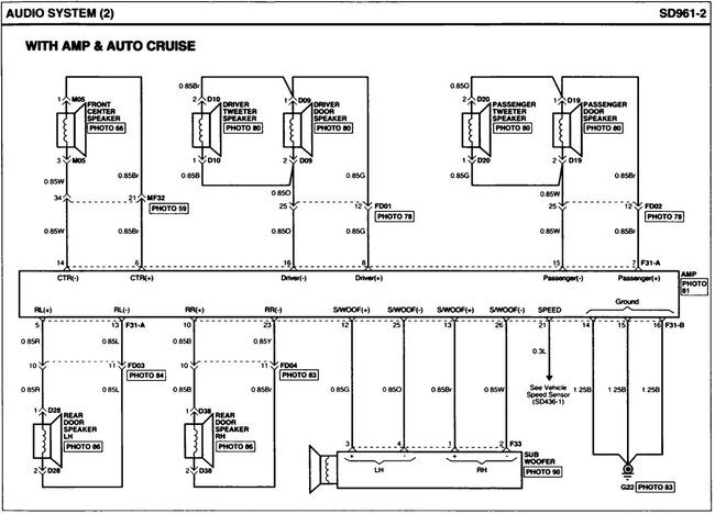

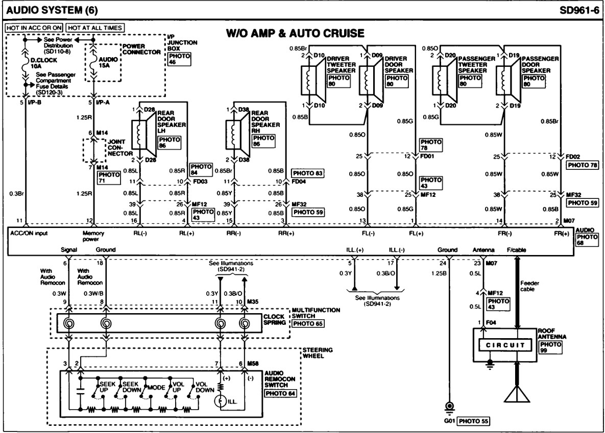

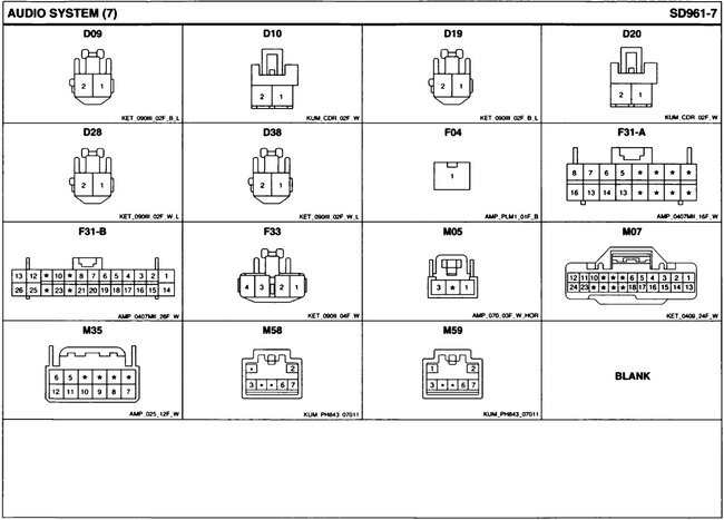

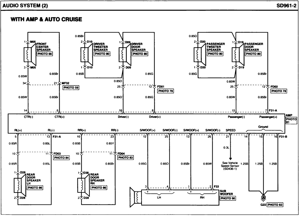

Looks like there are a few versions for that car, both with and without the amp and with and without the auto-cruise. These diagrams cover all 4 systems. The first ones are the connectors and then the units with an amp. The only difference if it doesn't have cruise is the steering controls because it uses the lamp circuit in the steering wheel. The last 2 are the ones without the amp which eliminates the controls for the amp or cruise depending on the options. Hope these answer the question. I'm guessing you want to replace the OE unit. If so, be careful as the factory amp doesn't turn on or off with the radio, it turns on and off with the key.

Hi, sorry, I should have stated that it's a 2008 Kia rondo Ex, 7-seaters fully loaded with 8 speakers and with an infinity amp under the driver's seat. Thanks, and sorry again.

No problem. That would be the first three images then.
