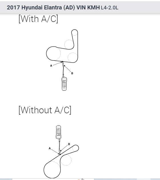

I need a diagram for the serpentine belt?
2017 HYUNDAI ELANTRA
109,000 MILES • 2.0L • 4 CYL • 2WD • AUTOMATIC
NIKKISMARTS
MEMBER
1 POST

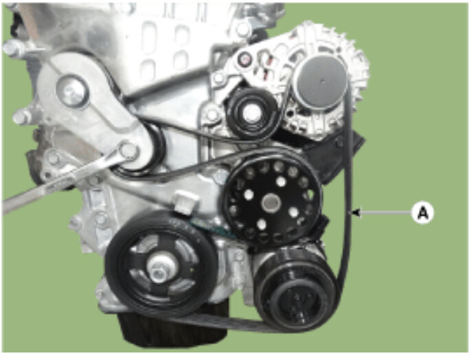

Can the A/C compressor be bypassed? I cannot find a diagram that shows if it can. I also need belt sizes for both with and without compressor.
Sep 15, 2023 at 5:50 AM
Experienced Mechanic
110,248 POSTS
There are two possibilities. One is with air conditioning and the other is without.
If you look at pic 1 below, it shows both routing diagrams. Pic 2 is a clearer picture of one with AC.
