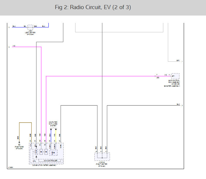

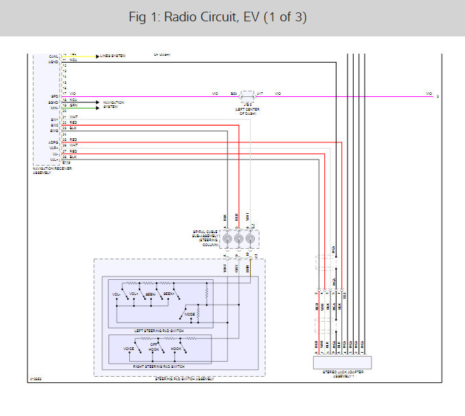

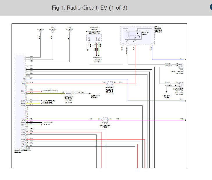

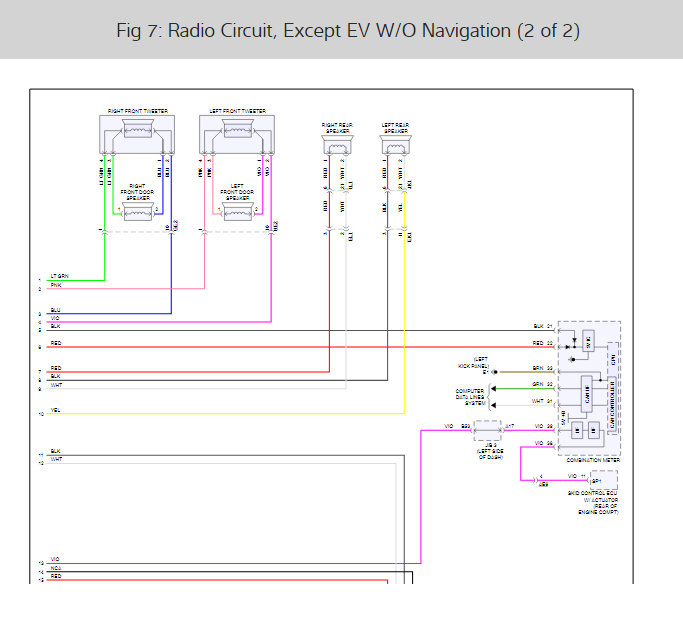

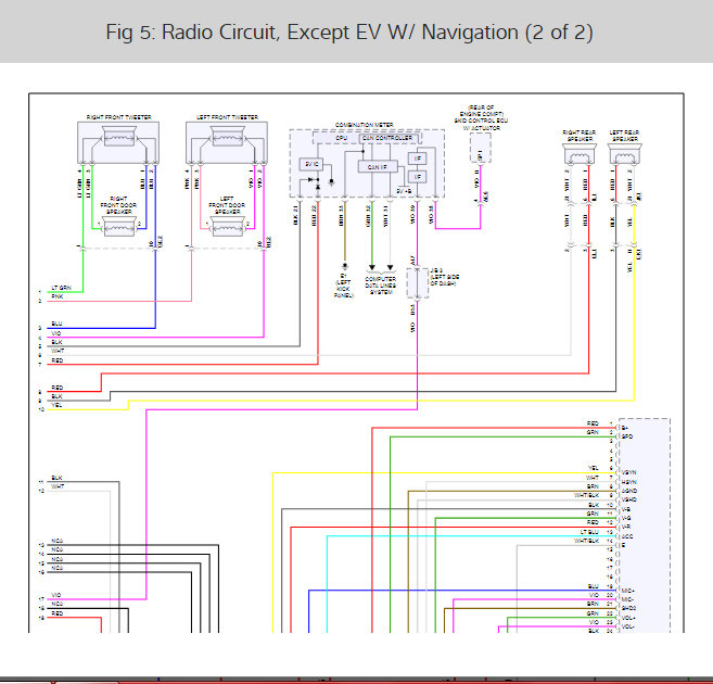

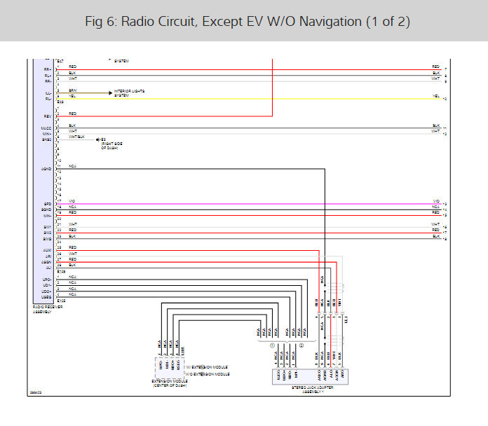

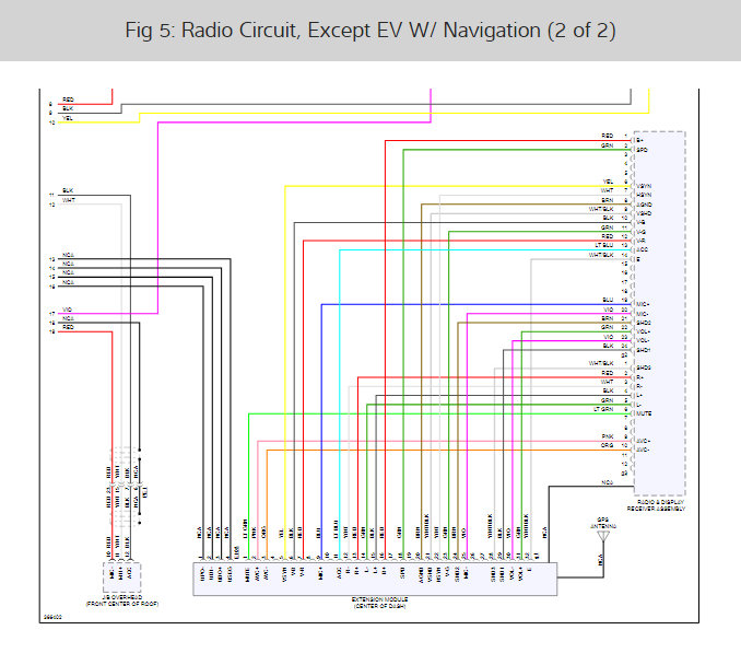

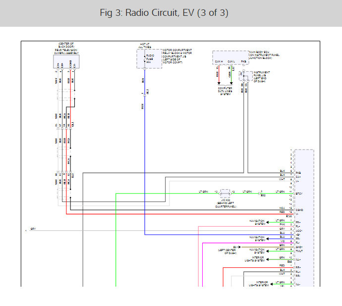

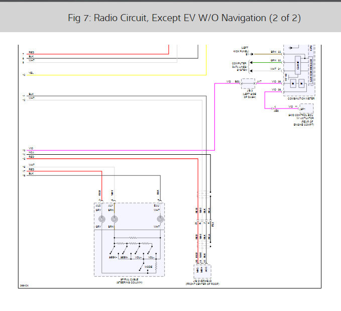

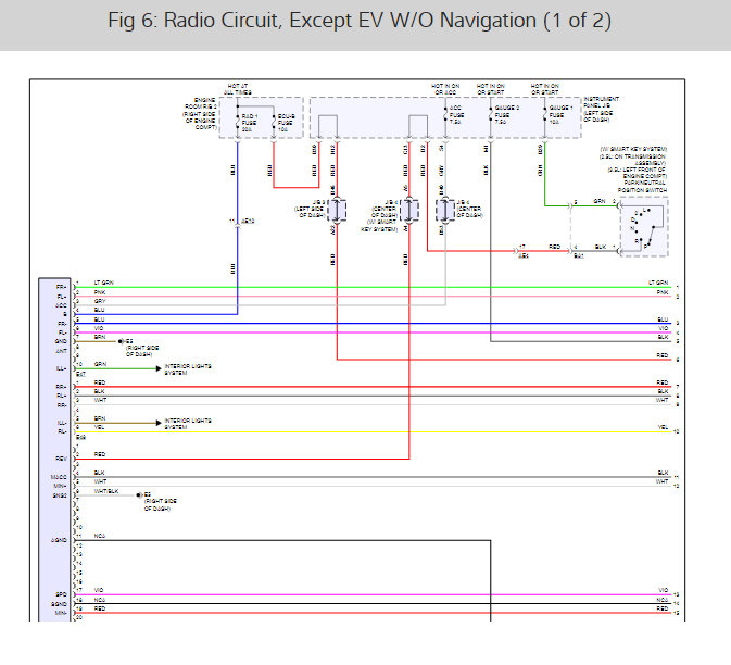

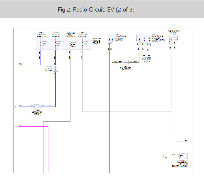

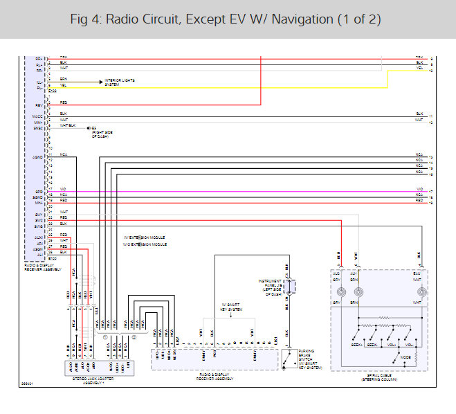

I have seen in this site about diagram for the 86120-0R130 OEM radio which fit the model RAV 4 2012.
Could you send to me, in high resolution, please?
Thank you so much.
Ricardo
Sep 16, 2019 at 2:21 AM
SCGRANTURISMO
  • 4,897 POSTS
There are three different stereo options in the 2012 Rav4, so I have included all three in the diagrams down below. If the diagrams are two small, right click your mouse and open the diagram in a new page and it will become bigger and legilable. Please get back to us with how everything turns out, or if you have more questions.
