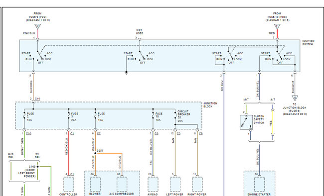

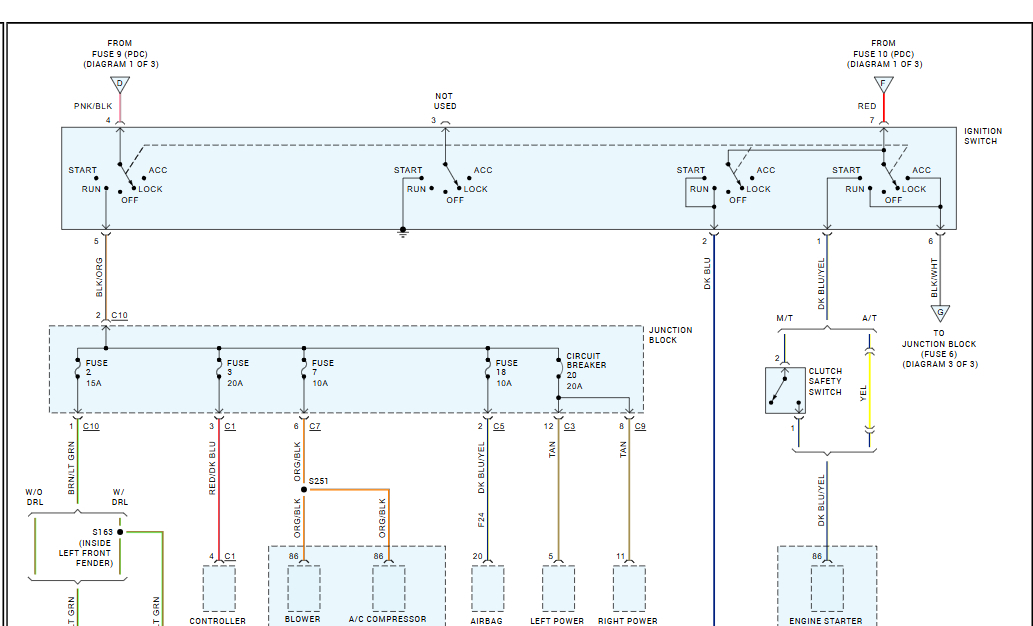

Need key ignition wiring diagram

Yep, here are the wiring diagrams for the ignition switch.
