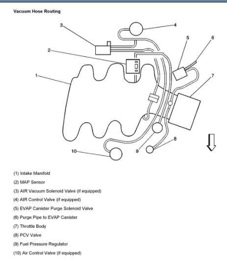

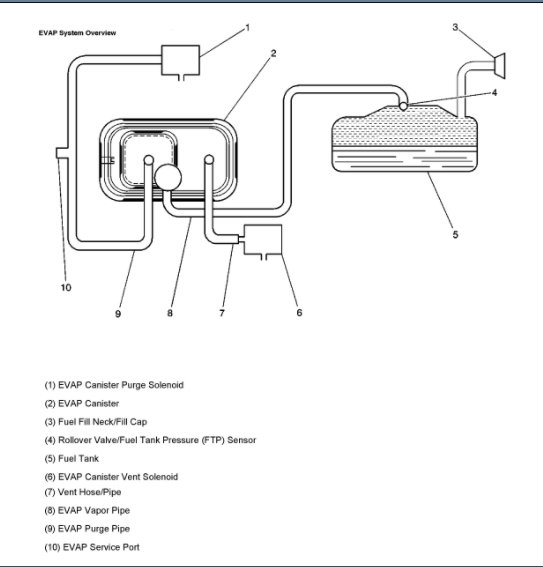

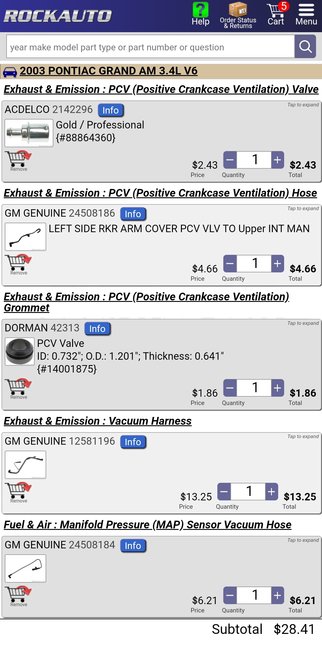

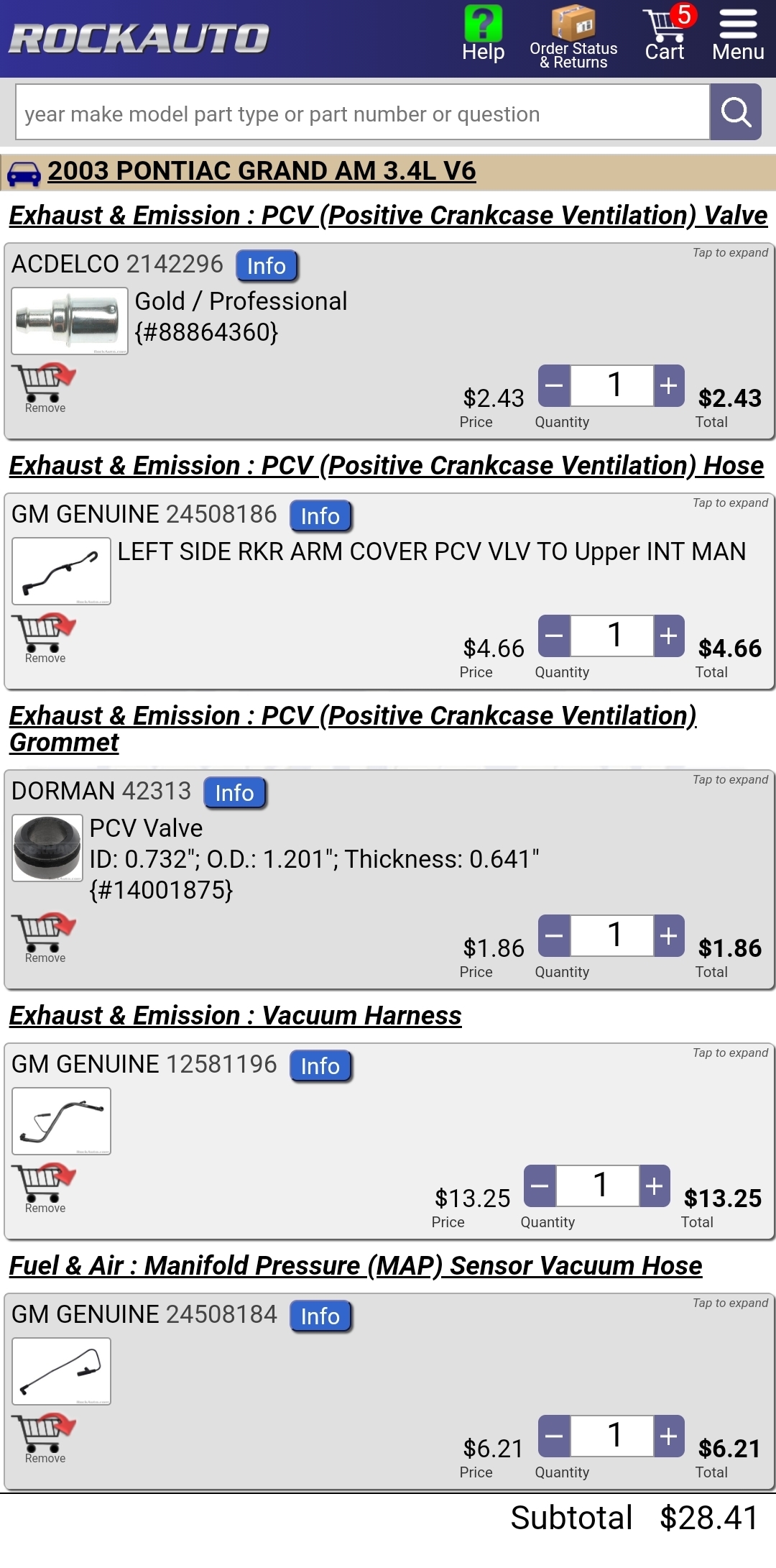

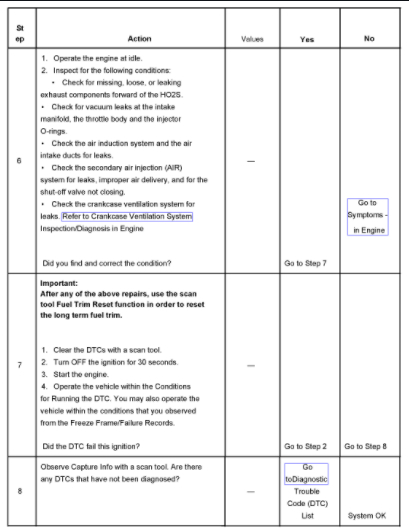

I'm getting a p0171 code, new intake manifold gasket, wires and iridium plugs are new. Going to order all vacuum hoses from Rock Auto. PCV valve, PCV hose, PCV grommet, mass airflow sensor, vacuum hose, vacuum harness. Also need a vacuum diagram. please.

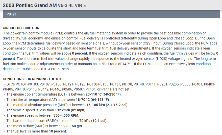

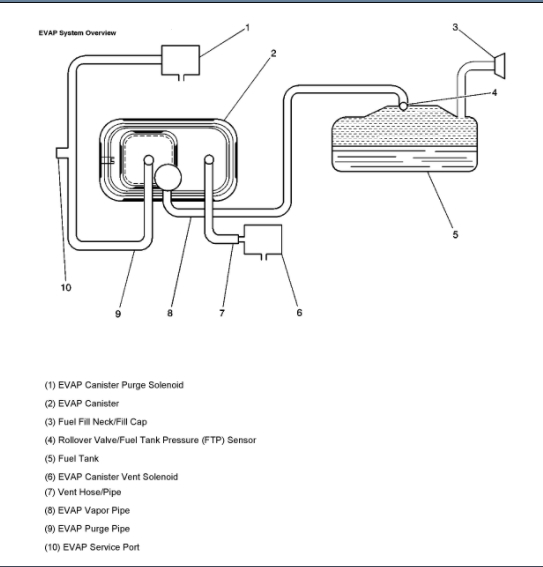

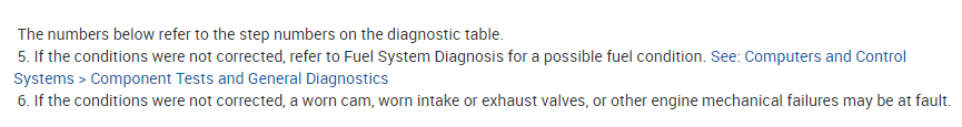

Hello, I'm Danny.

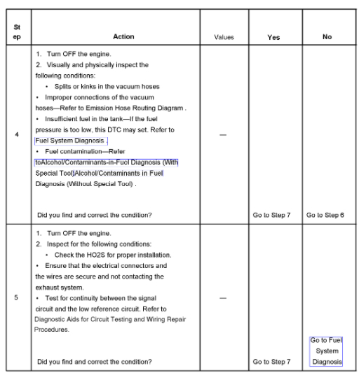

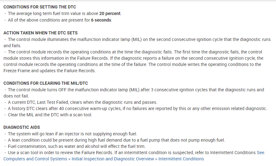

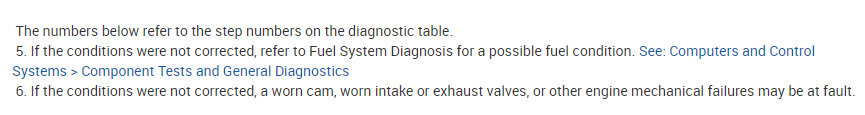

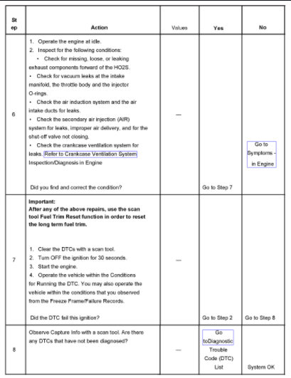

Here is the diagram you requested. I've attached below diagnostic steps relating to code P0171 as well as the emission hose routing diagram for your car. Hope this helps and thanks for using 2CarPros.

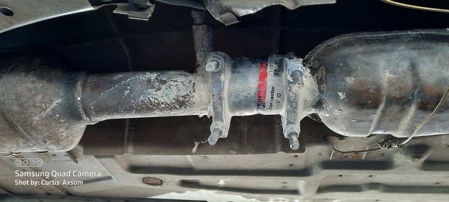

Okay, I replaced all vacuum hoses, new PCV valve. I cleared the code. I noticed it had more power and shifted a little harder. I'm guessing the computer needs to adjust. Then the came back on. I do have a brake in the exhaust. It's where the resonator pipe connects to the pipe coming out of the catalytic converter. Could this be the lean fuel in bank ¹?

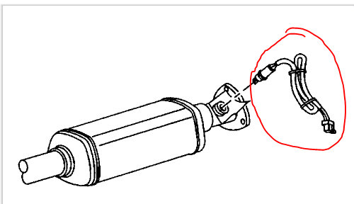

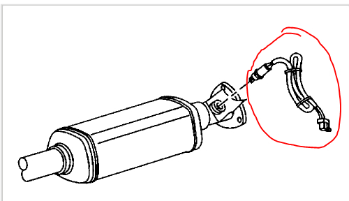

Can you take a picture of where the exhaust leak is with your cell phone and upload it here? Depending where the leak is it might be giving your downstream oxygen sensor a false reading due to leakage. That could be giving a lean code. I would definitely have the leak fixed. I've attached a picture below of the downstream oxygen sensor. Hope this help and thanks again for using 2CarPros.

I used exhaust cement. that stuff got everywhere because it was so sticky. But it doesn't leak. I cleaned the MAF sensor and no more codes. Idles and runs great.
