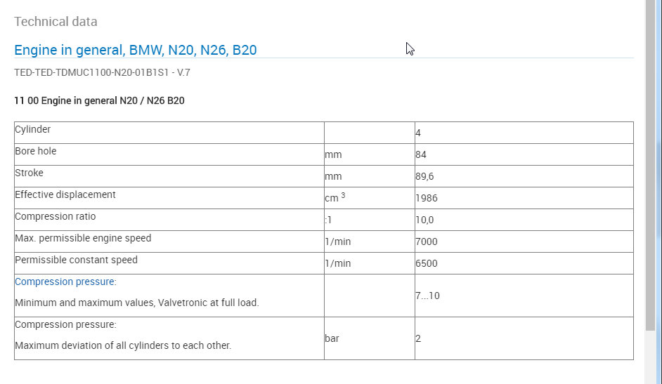

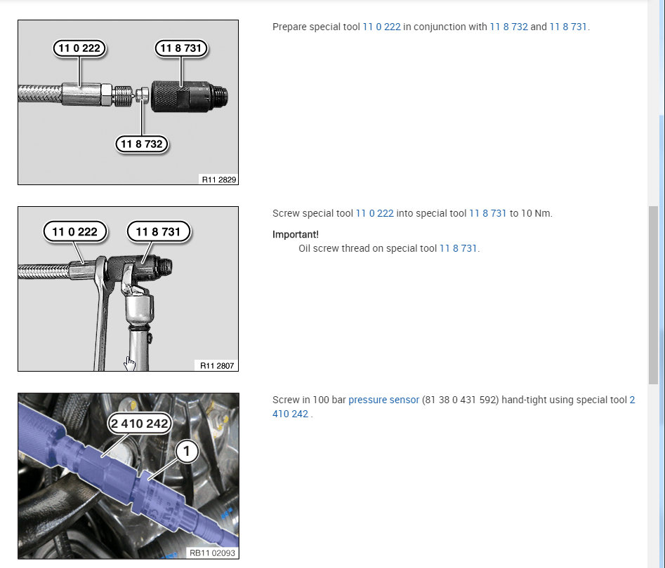

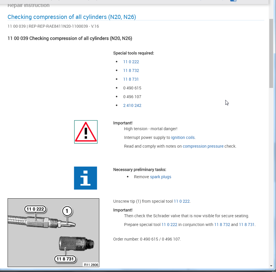

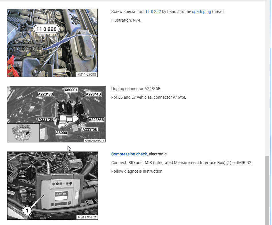

Looks like you have multiple serious misfires which means the engine is probably running pretty poorly.
Let's start with doing a compression check and going from there.
Also, please let us know what has been done and what happened to cause this issue. Did the engine overheat?
