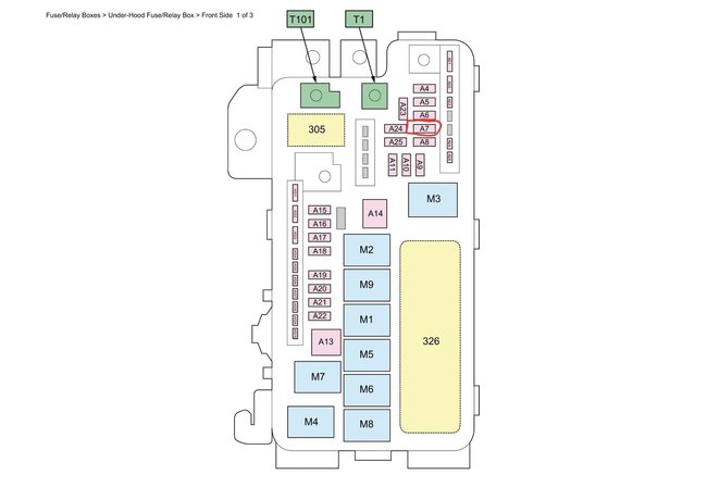

I was adding Freon to A/C system.. after I replaced the A/C clutch kit- I check the pressure with the gauges and good chance I mixed high and low pressure-
Next thing I know the engine light comes on and scanner says:
P-0135
P-0155
P-0498
Some pending/permanent with in the code screens.
I replaced all the emission sensors (4 in total).
Multi test question.
What did I do wrong? does A/C system need to be vacuumed and refilled? I believe the spacers weren’t 100% correct in the clutch kit. new A/C compressor as well?
Should I purchase new vent valve?
I’m at a loss for words.. any information would greatly be appreciated.

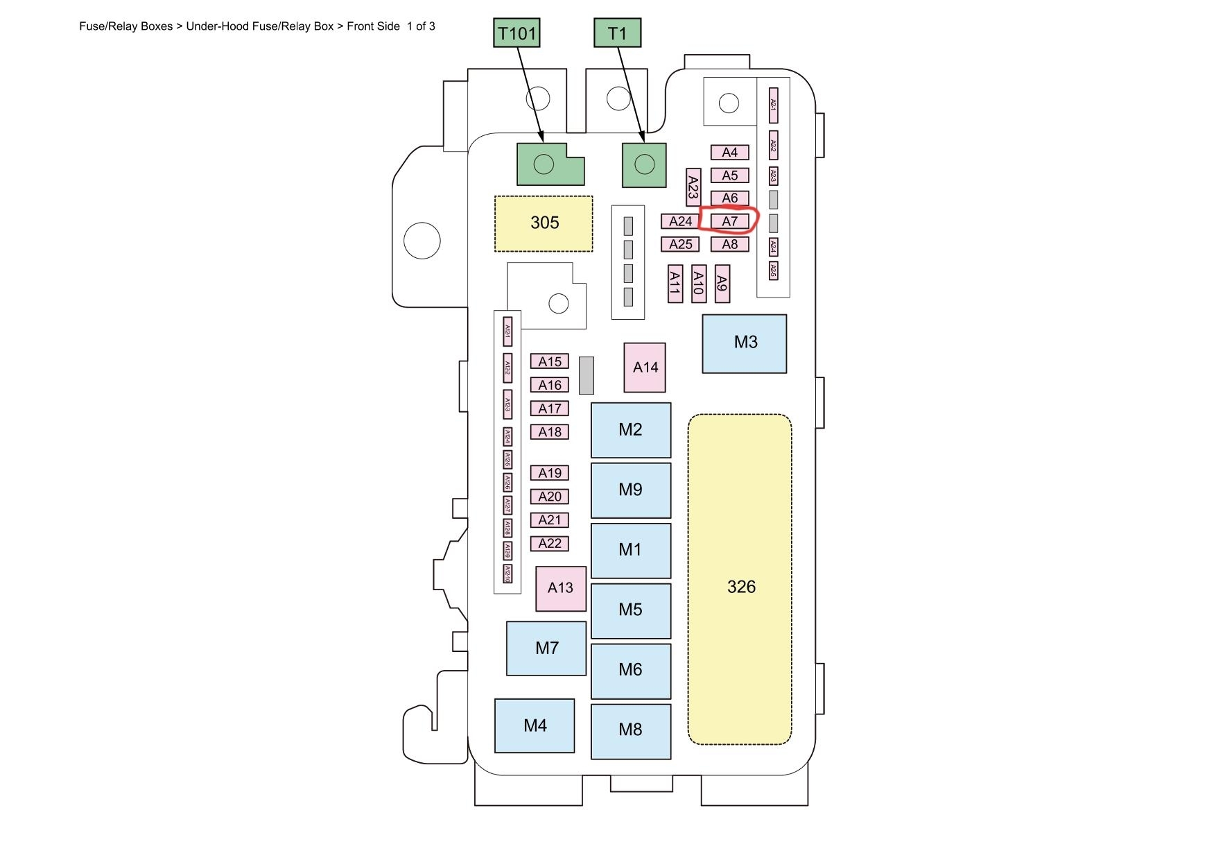

Hello and welcome to 2CarPros. All those fault codes lead to one fuse. A7 the A/F sensors and evap canister.
A7
15 A
PGM-FI subrelay,
A/F sensor (sensor 1) (via PGM-FI subrelay) *11,
Front A/F sensor (Bank 2, sensor 1) (via PGM-FI subrelay) *12,
Front secondary HO2S (Bank 2, sensor 2) (via PGM-FI subrelay) *12,
Rear A/F sensor (Bank 1, sensor 1) (via PGM-FI subrelay) *12,
Rear secondary HO2S (Bank 1, sensor 2) (via PGM-FI subrelay) *12,
EVAP canister vent shut valve (via PGM-FI subrelay) *13,
No. A23 fuse (via PGM-FI subrelay)
Replace that fuse evan if it looks good and let us know if that takes care of the issue.
