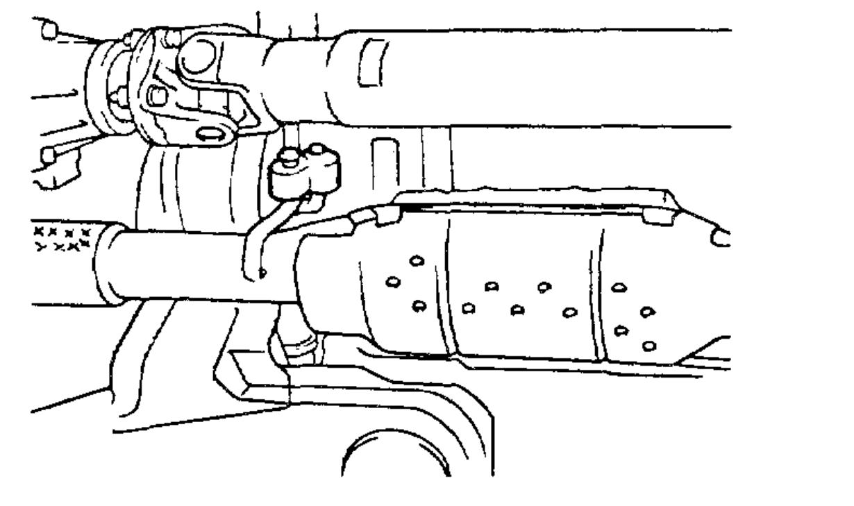

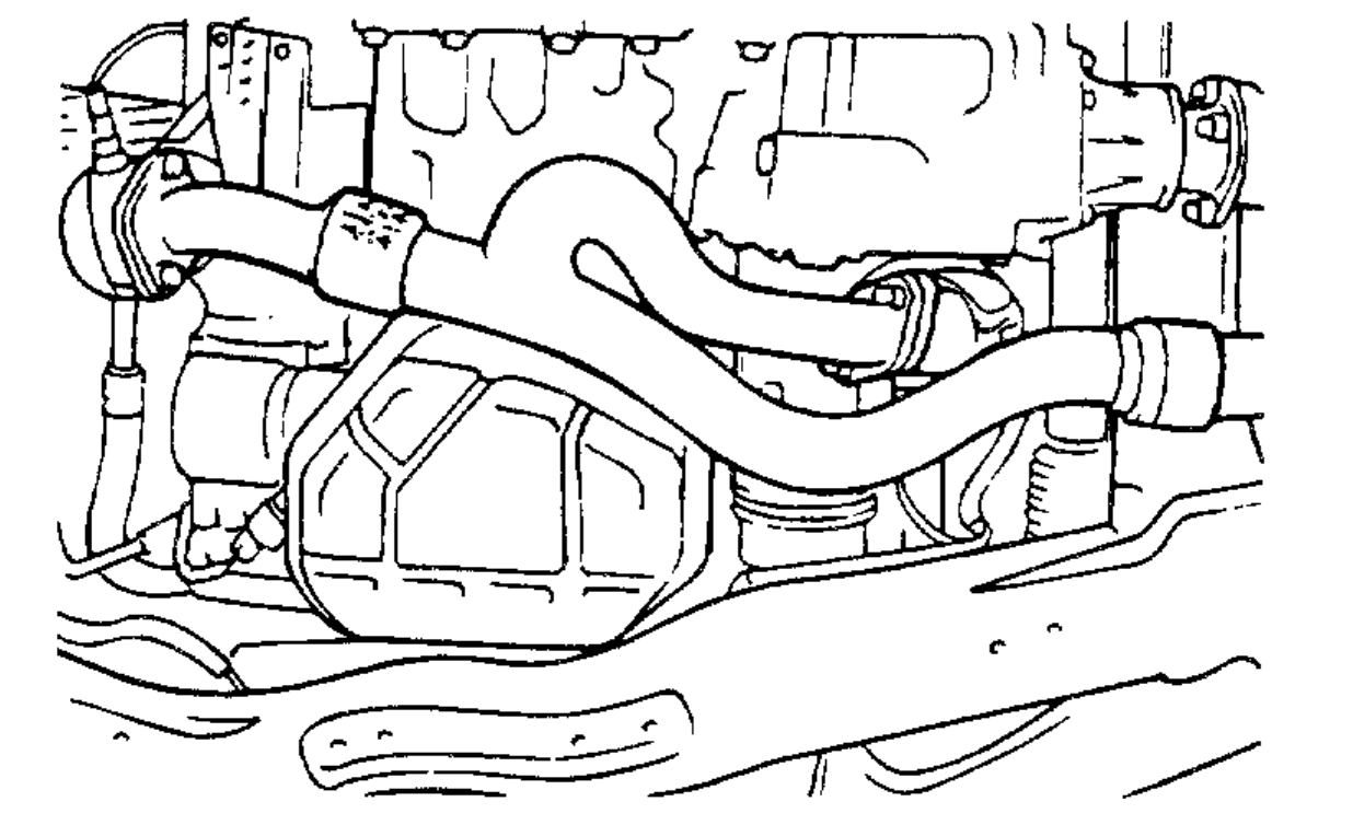

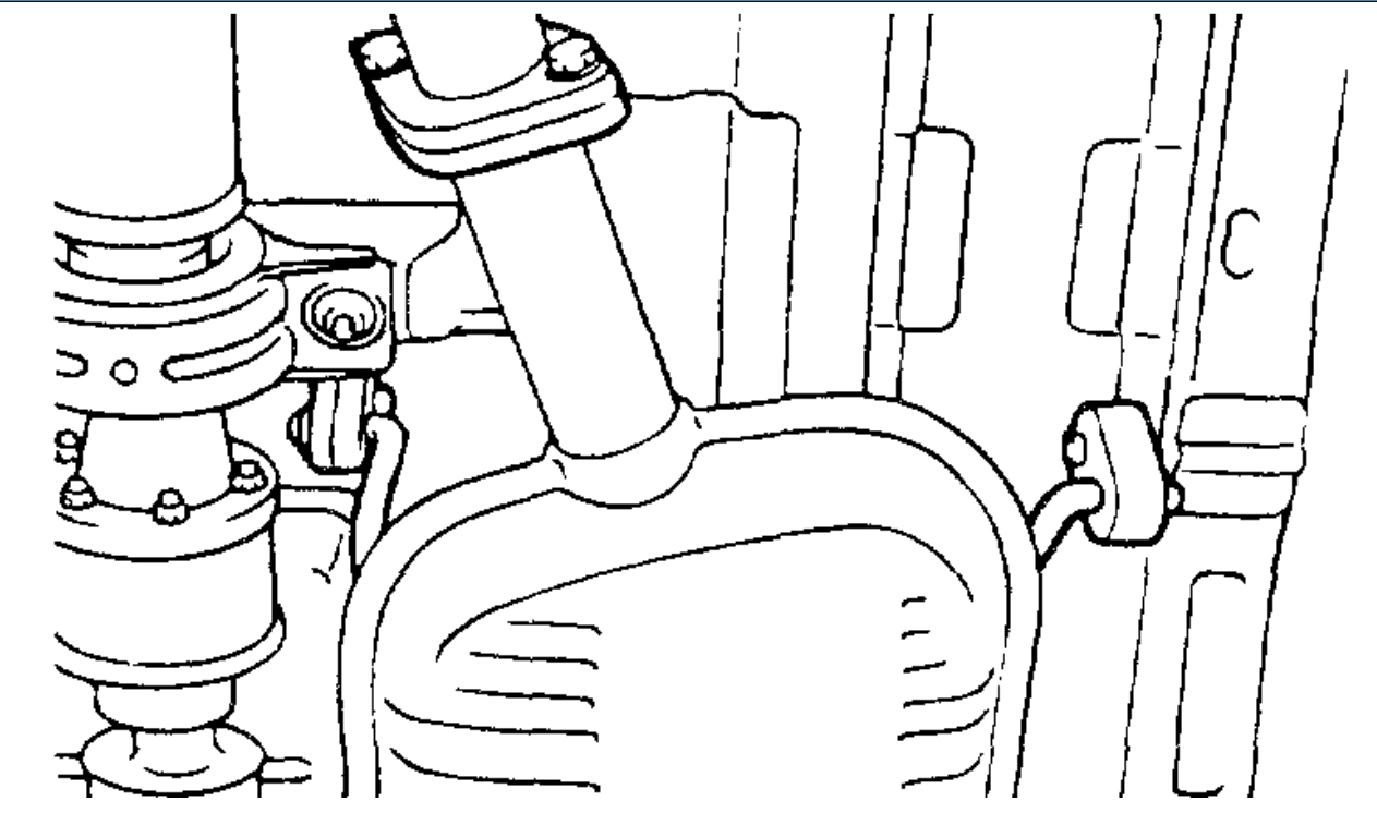

FRONT EXHAUST PIPE (INCLUDING CATALYTIC CONVERTER)
1. Remove the front exhaust pipe from the center exhaust pipe.
2. Remove the front exhaust pipe bolt and the exhaust manifold pipe mounting nuts.
1 of 2
2 of 2
3. Remove the front exhaust pipe from the rubber hanger.
INSPECTION
1. Check the mufflers and pipes for leaks, corrosion and damage.
2. Check the rubber hangers for deterioration and cracks.
INSTALLATION
1. Temporarily install the front exhaust pipe, the catalytic converter assembly, the center exhaust pipe and the main muffler, in this order.
2. Install the rubber hangers so that they hang equally left and right.
3. Tighten the parts securely and then confirm that there is no interference with any components.
