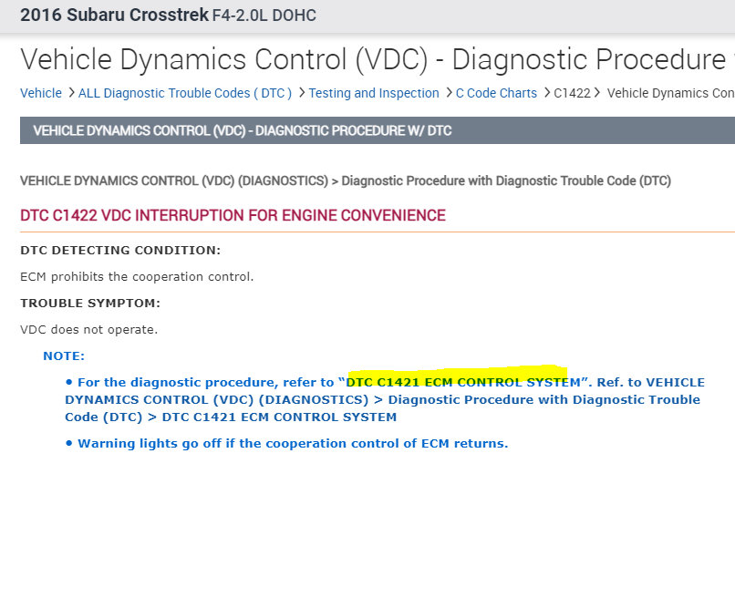

What does this mean?
Anti-Lock Brake System produced primary trouble code:
C1422 VDC Interrupted Due to Egi Reason
Additional Code details
Anti-Lock Brake System Secondary Trouble Codes:
C1422

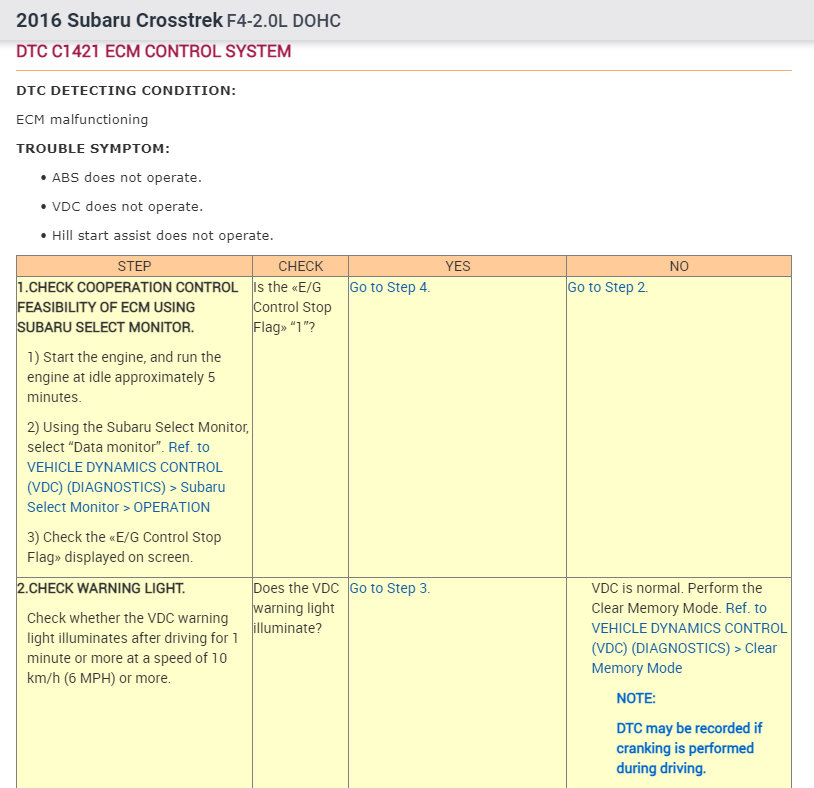

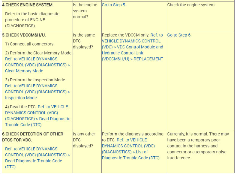

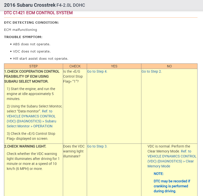

The code
DTC C1422 VDC Interruption for engine convenience.
This typically gets generated due to the ECM not communicating properly.
It will usually make the ABS, VDC not to operate.
I have attached the troubleshooting guide below for your reference.
Let me know of any questions.
