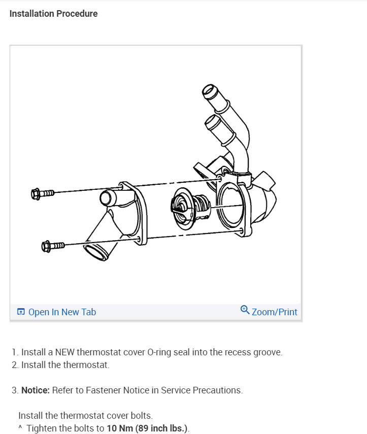

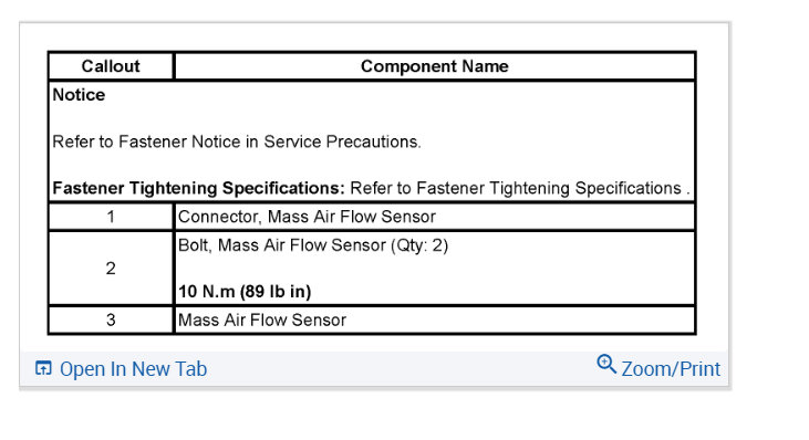

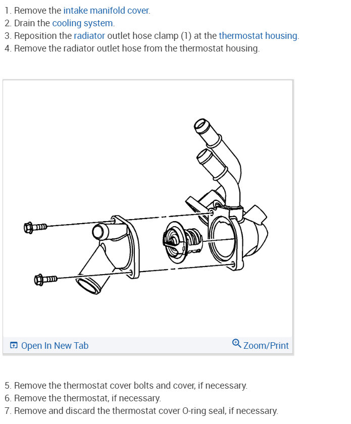

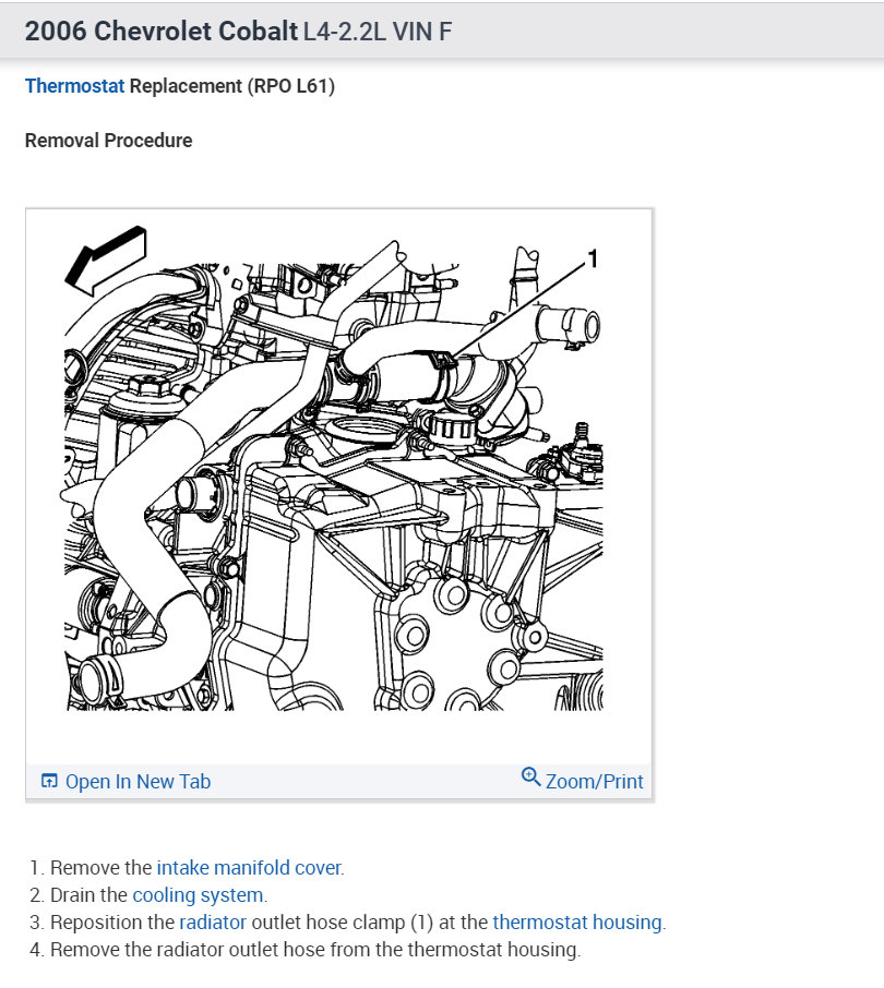

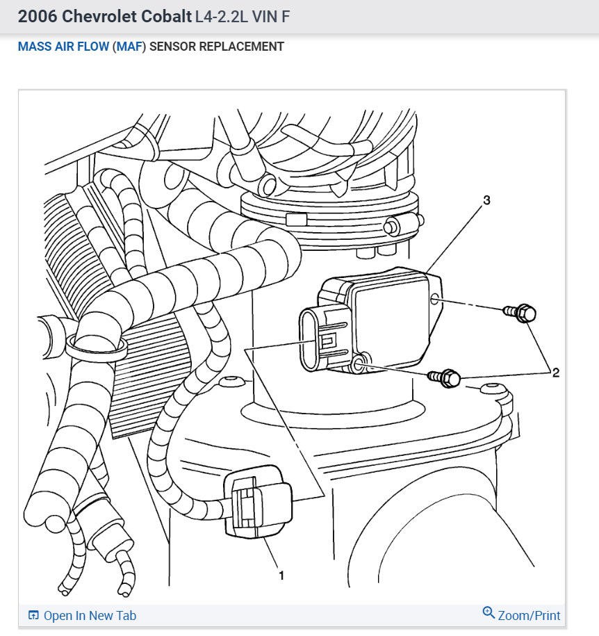

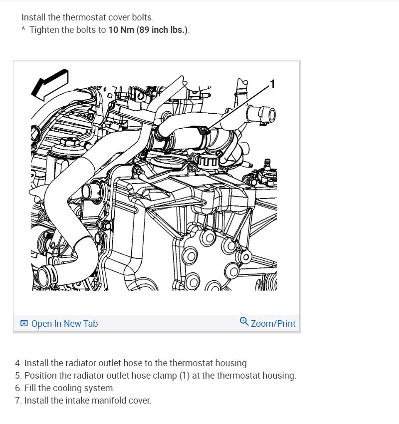

So, the p0128 code is the clue, the engine is not getting up to temperature so the computer does not know what to do, this is the first thing I would fix. Next, I would replace the MAF sensor because cleaning them doesn't work most of the time. Does the engine seem to have good power? Then I would not worry about the fuel pressure. Here is how you can change the thermostat out and the MAF sensor in the images below so you can fix the problem. Check out the images (below). Let us know what happens and please upload pictures or videos of the problem.

Finally, was able to get a thermostat and MAF sensor. I checked my old thermostat by putting it in boiling water. It is working just fine. So, I put it back on. Put the new MAF sensor on and no change. I even made sure to clear the codes before I put it in. I'm still getting the same bad performance. Same code (p0300 is the code that is constant every time I run the diagnostic. Sometimes when I do it, I will get the p0128 and a couple of others. But like right now for instance it's only showing the random misfire). So, I don't know man I'm at a loss. I'm hoping I'm just missing something simple. Any ideas?

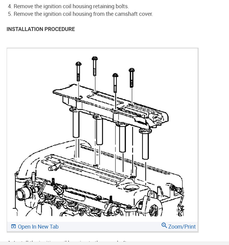

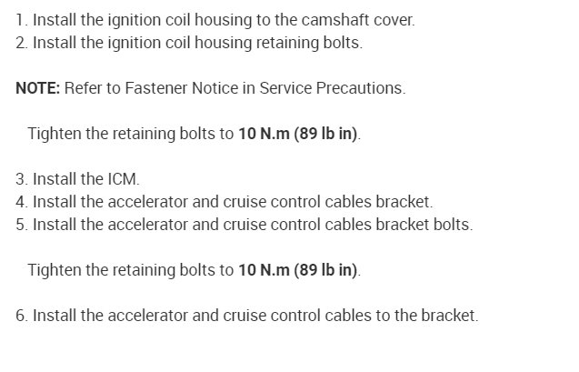

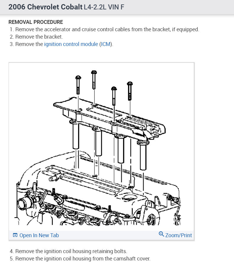

Yep, it could be the coils if they are arcing to one another or internally. Here is how to replace the coils. Check out the images (below). Let us know what happens and please upload pictures or videos of the problem.

Well, I decided to go ahead and buy a new coil pack and that did the trick! Car is running better than it ever has. That p0452 code (fuel tank pressure sensor) I was also able to fix just by unplugging it and cleaning it with contact cleaner. So, thank goodness no more working on that friggin car! Lol. Just wanted to let you know and wanted to thank you for all of the advice.
