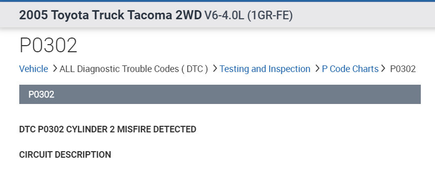

Thanks, I didn't realize I'd get a response so quickly and haven't started that list yet.
If this changes things my OBDII scanner popped a P0302 code. It didn't trigger the dash as cylinder 2 must have self corrected quickly. I guess if 2 doesn't misfire in the next 40 miles the pending code.on the OBDII will reset itself.
Anyway I'll get on that list and see what I can rule out. Thanks again

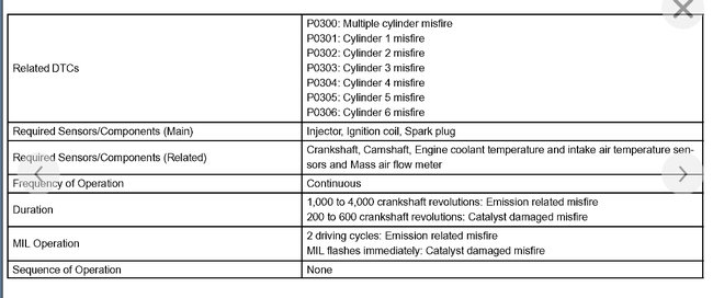

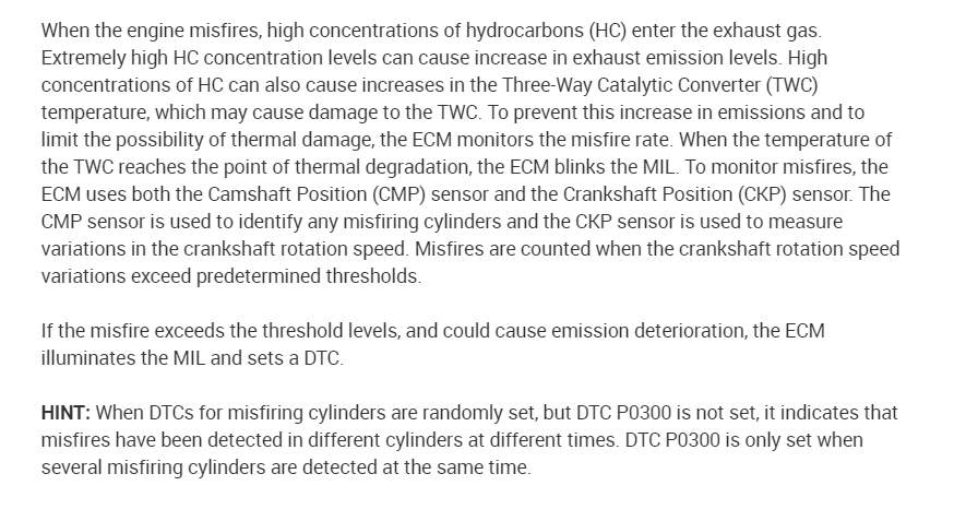

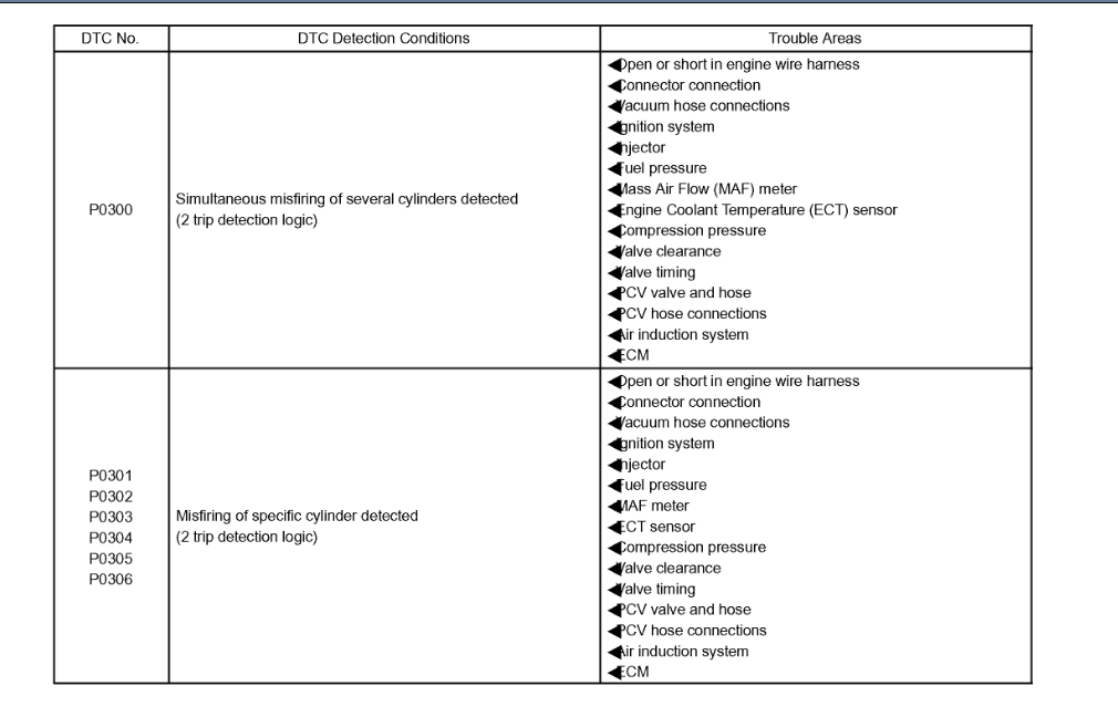

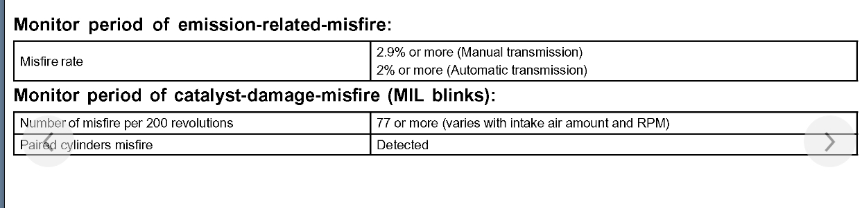

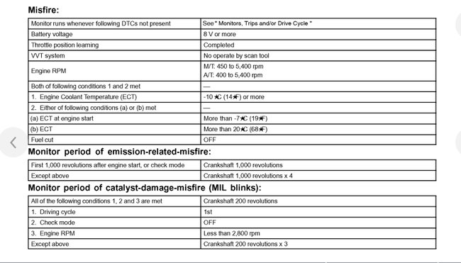

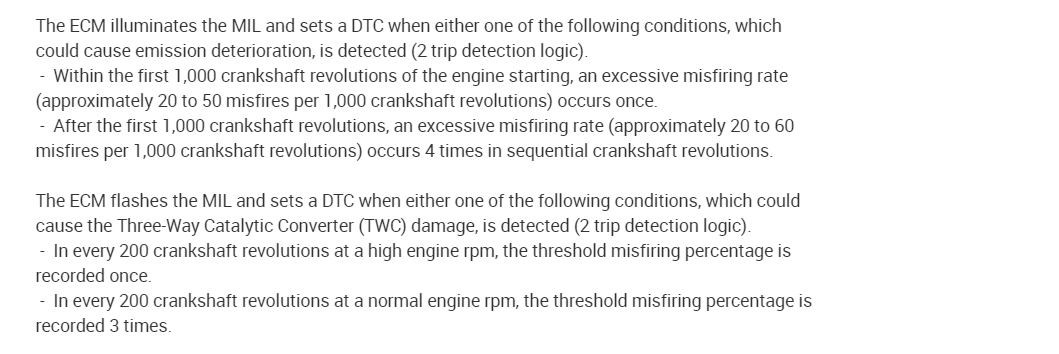

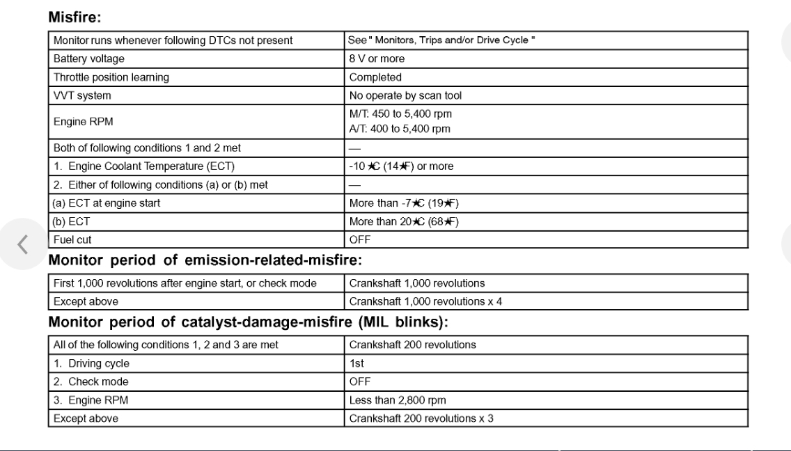

Hello again,
I have sent along some information that might be helpful to you on misfire DTC's in the diagrams down below. This guide is from the vehicle manufacturer and should help you as you go through the previous diagnostic troubleshooting guide by understanding why you are looking at the things the guide asks you to look at. I hope this helps ad please get back to us with what you find out.
Thanks,
Alex
2CarPros
