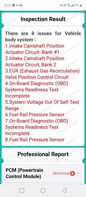

What does power train control module abnormal and also restraint control module abnormal, ABS/TCS mean?
DODGERS
  • 2004 LINCOLN LS
  • 3.0L
  • V6
  • 2WD
  • 239,000 MILES
I did a diagnose it report power train control module abnormal and also restraint control module abnormal, ABS/TCS (Anti-lock braking system traction control module) this is first time doing this so what does it mean?
Wednesday, April 28th, 2021 AT 5:00 PM
7 Replies
Can you provide the report so that we can look at it just to be sure?
More then likely it means these modules have codes in them but we need to see it just to be sure.
Also, I would suggest we stop by a parts store and scan for codes just to see if there are any there.
I suspect the ABS/TCS issue is a wheel speed sensor but again we need to see this to be sure what is happening. Thanks

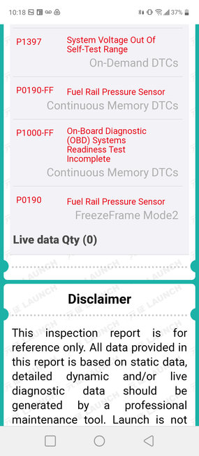

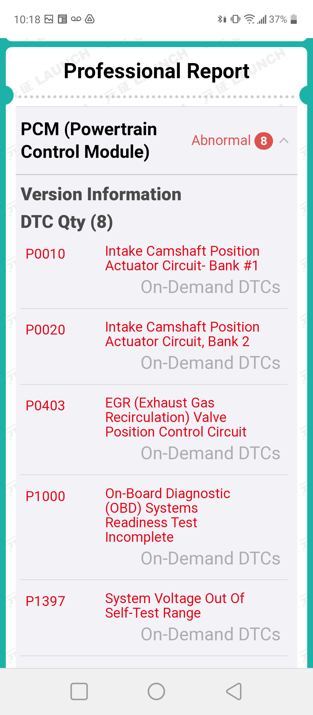

Here's the report that I have I hope that this images will help.
Sunday, May 2nd, 2021 AT 10:27 PM

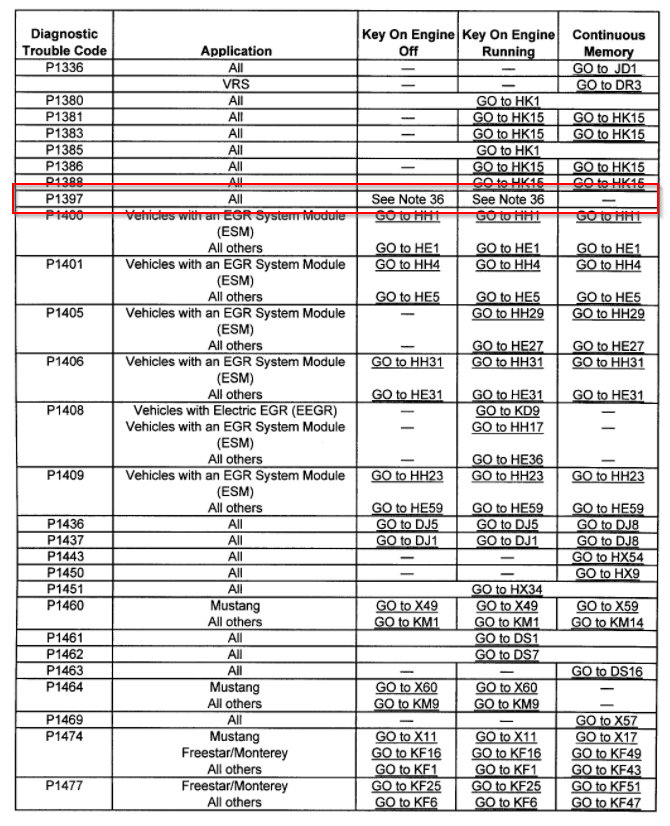

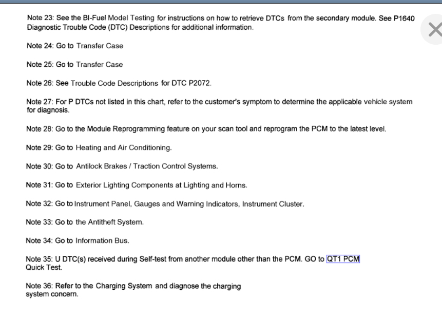

Okay. Does the vehicle even start and run? These codes would not necessarily cause an issue like this so I think we are missing something or I am not understanding the issue.
I would suggest addressing the voltage code that you have which if the battery is weak we need to replace it. I attached that info below.
Maybe if you get a video of the issue of the vehicle not going that will help explain this.
