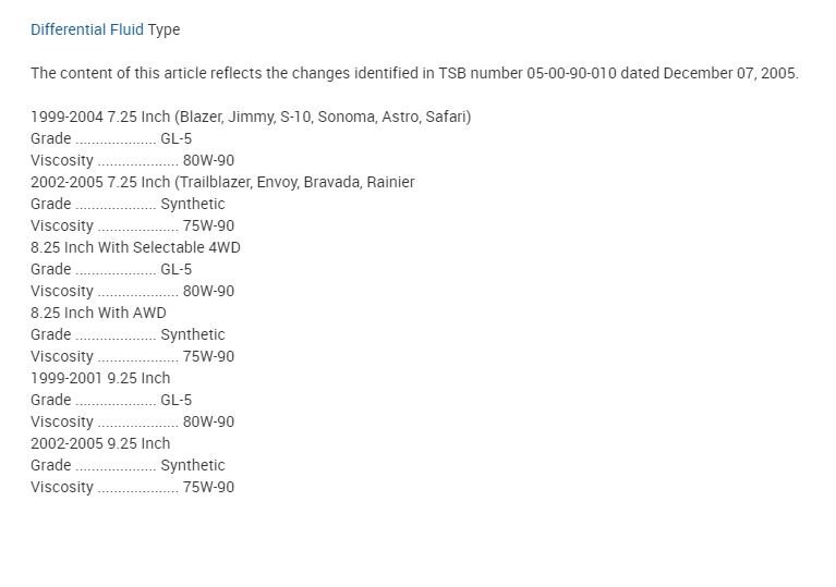

I only want to use AC/delco oil but not sure to get the SAE 80w-90 GL-5 (not synthetic) or the SAE 75w-90 GL-5 which is synthetic. Also, if I get the synthetic to I need additive too?
Feb 17, 2020 at 2:29 AM
Good afternoon,

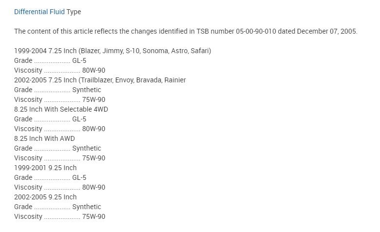

I posted the specs for you for both differentials. The second one is for the front.
No, to the additive.
Feb 17, 2020 at 3:14 AM
GROVER333
Thanks. This is helpful. I have the 1999 old body Tahoe... the years lead me to believe these specs are for newer model Tahoe. Can you please confirm?
Feb 17, 2020 at 3:36 AM
The 1999 to 2001 is for your truck.
