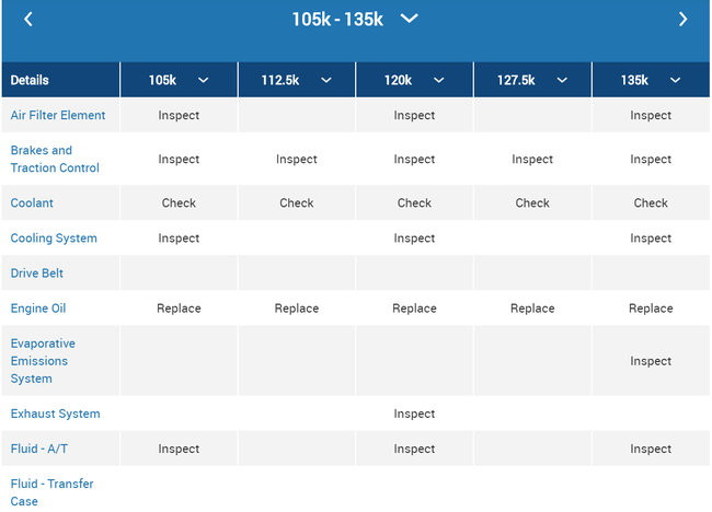

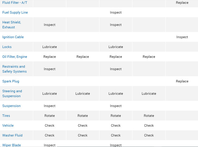

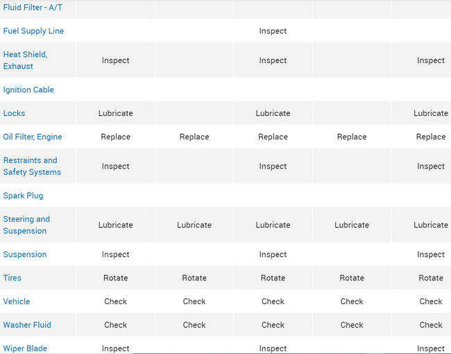

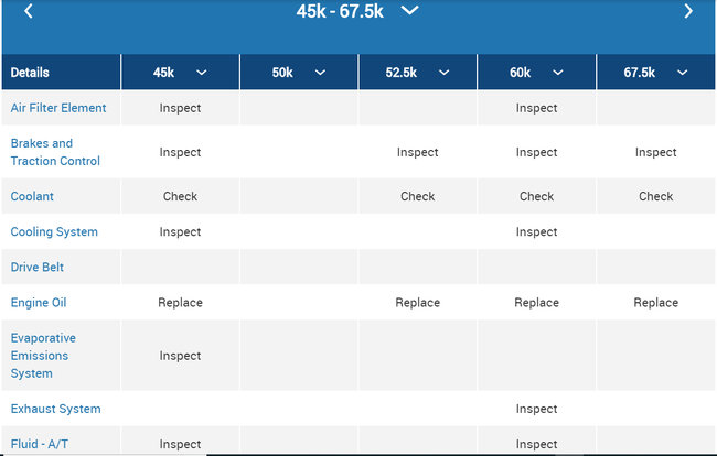

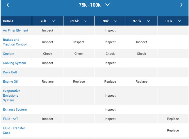

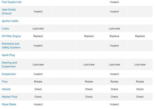

I think you are going to be just fine by driving it once a week. I was asking where you live because if you live next to the coast I would watch that the salt in the air from the ocean might make the body of your truck rust a little bit faster. Here are the maintenance recomendations for your truck. Follow them and you should have a dependable running truck for a long time. Thanks.
