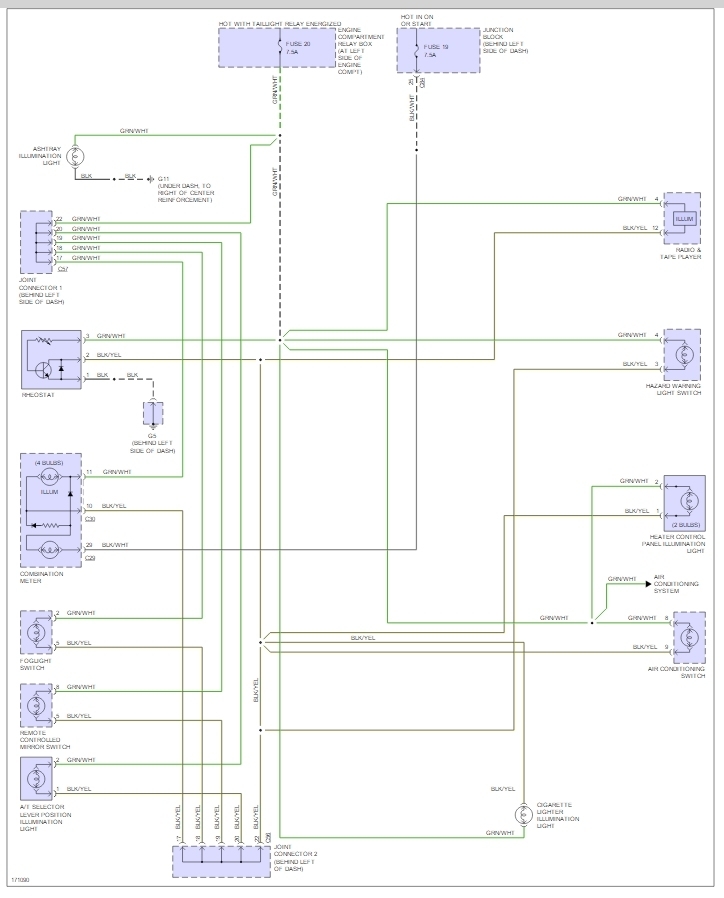

I've been doing some hardcore Googling for almost a week now on top of using my Haynes manual and can still only piece about 40-50% of this wiring together.
Parts Affected:
A-18x MFI Relay (Reading a crazy fluctuating ground between 40-60ohm)
A-19x AC Compressor Relay (Same as MFI relay)
A-17x A/T Control Relay (Getting hot)
A-09x Fan Control Relay (Getting Hot)
Under Hood Fuses #9 (ECU) and #15 (A/T)
Interior Fuse #13 (ECU) [Reading a ground at it at 50ohm]
Getting a lot of audible electrical interference coming from the A/T control unit itself when its harness is plugged in. (Though unplugging it doesn't change any warning lights or the weird readings from the relays)
So far I've gotten the wiring for MFI Relay to Fan Control Relay, To PCM and a couple other small things. I have more detailed diagrams, but they're off-yea,r so I'm not sure if I can trust them completely.
Does anyone know where I should check for a failure first? Is there anything that's a common weak-spot? Also, all of this is possibly due to a sudden jump in amperage going through the system.
I've eyeballed a few plugs related to the circuit and checked the relay pins, nothing is looking burnt/bare so far.

Please try unplugging all alternator wires, please don't let them touch ground, I'm thinking it could be internally shorted.
Also check the battery ground (to frame and from engine) and power cables for corrosion and lose connections.
Mar 14, 2016 at 12:50 PM
  • 54,840 POSTS

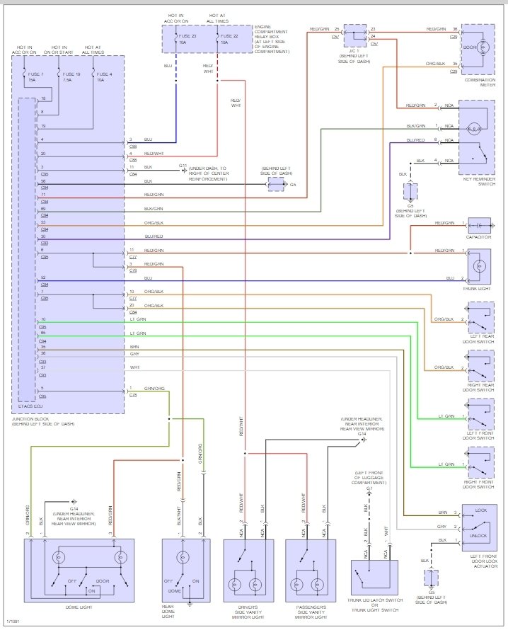

I forgot the wiring diagrams, let me know what you find.

Ah! Thank you! Just noticed the diagrams. I'll do some scribbling and mapping tonight and check them out tomorrow.

Forgot to mention that swapping around the grounds didn't change anything. Thanks again for the diagrams, they give me a little more information than I already had.
Mar 14, 2016 at 5:01 PM
  • 54,840 POSTS
With the amperage surge it could have knocked out the BCM. Let me know what you find
