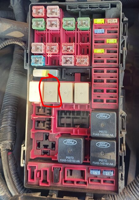

Do I pull this to depressurize the fuel system in this 2003 Mercury grand marquee?

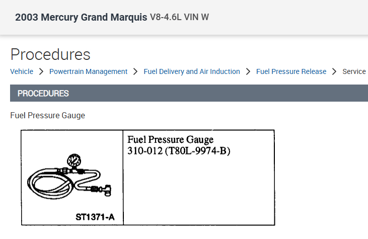

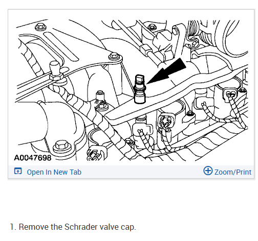

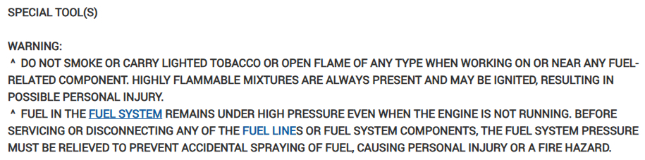

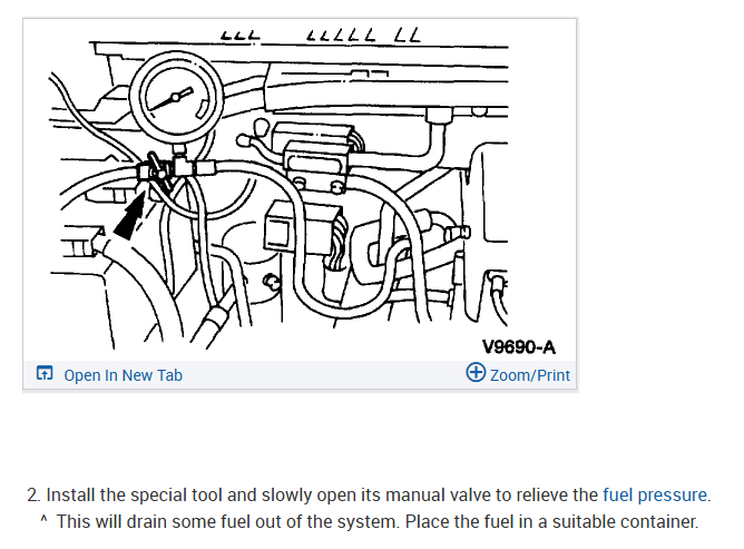

Hi:
According to my manual, there is no need to depower the pump. Instead, they recommend using a fuel pressure gauge with a manual valve. Once it is connected, you open the valve and allow the fuel and pressure to evacuate into a fuel container.
I attached the directions I have and the pictures. Take a look and let me know if this helps.
See pics below. Note: If you don't have a pressure gauge, many of the parts stores will lend one to you.
