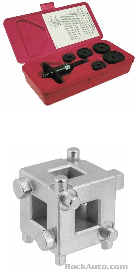

Can't get the piston to move.

With nothing else to go on, I have to assume the caliper has the parking brake mechanism built in. If it does, you need a special tool to rotate the piston to retract it. This photo shows two different versions of that tool.
Image (Click to enlarge)
