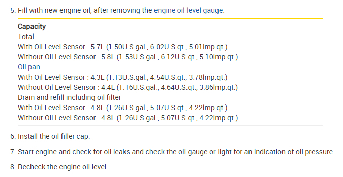

Is it okay to delay oil change by 200 or 300 km? I need to change the oil
Sep 27, 2017 at 4:26 PM
DANNY L
  • 5,648 POSTS

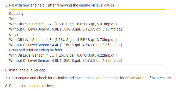

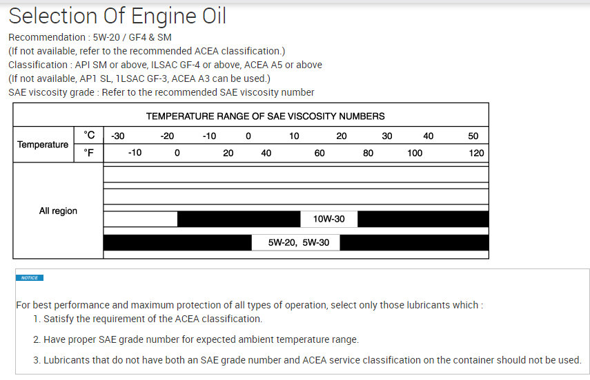

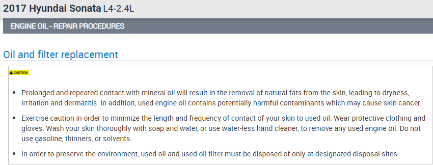

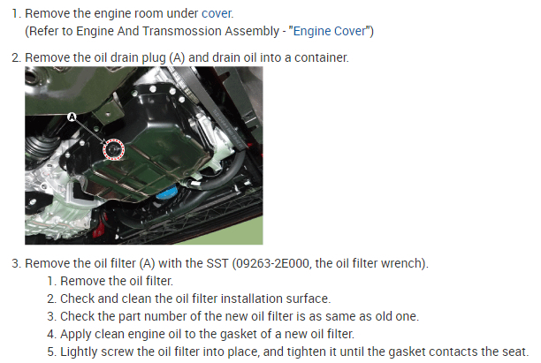

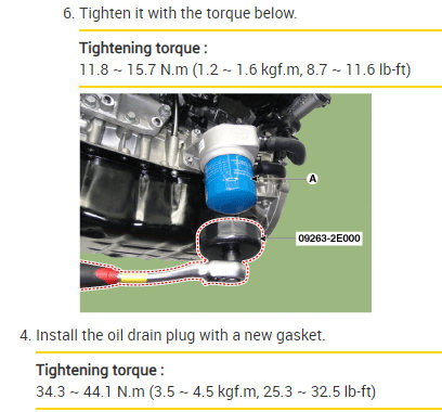

Hello, I'm Danny.
The amount of mileage between oil changes is determinative on the type of oil that is being used in your vehicle. Here is a tutorial on how to change the engine oil in your car:
https://www.2carpros.com/articles/how-to-change-engine-oil-and-filter
I've attached picture steps below on how to change the engine oil and oil filter on your vehicle. Hope this helps and thanks for using 2CarPros.

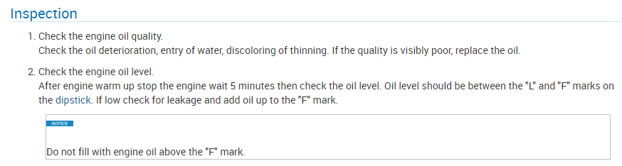

HADDIX61
Need to change the engine oil and filter can you help me please?
Feb 24, 2021 at 3:49 AM (Merged)
  • 110,241 POSTS
Changing engine oil and filter isn't hard to do. It should be done based on the manufacturer's recommended maintenance schedule.
First, here is a link that explains in general how it's done. You can use this as a guide when doing it.

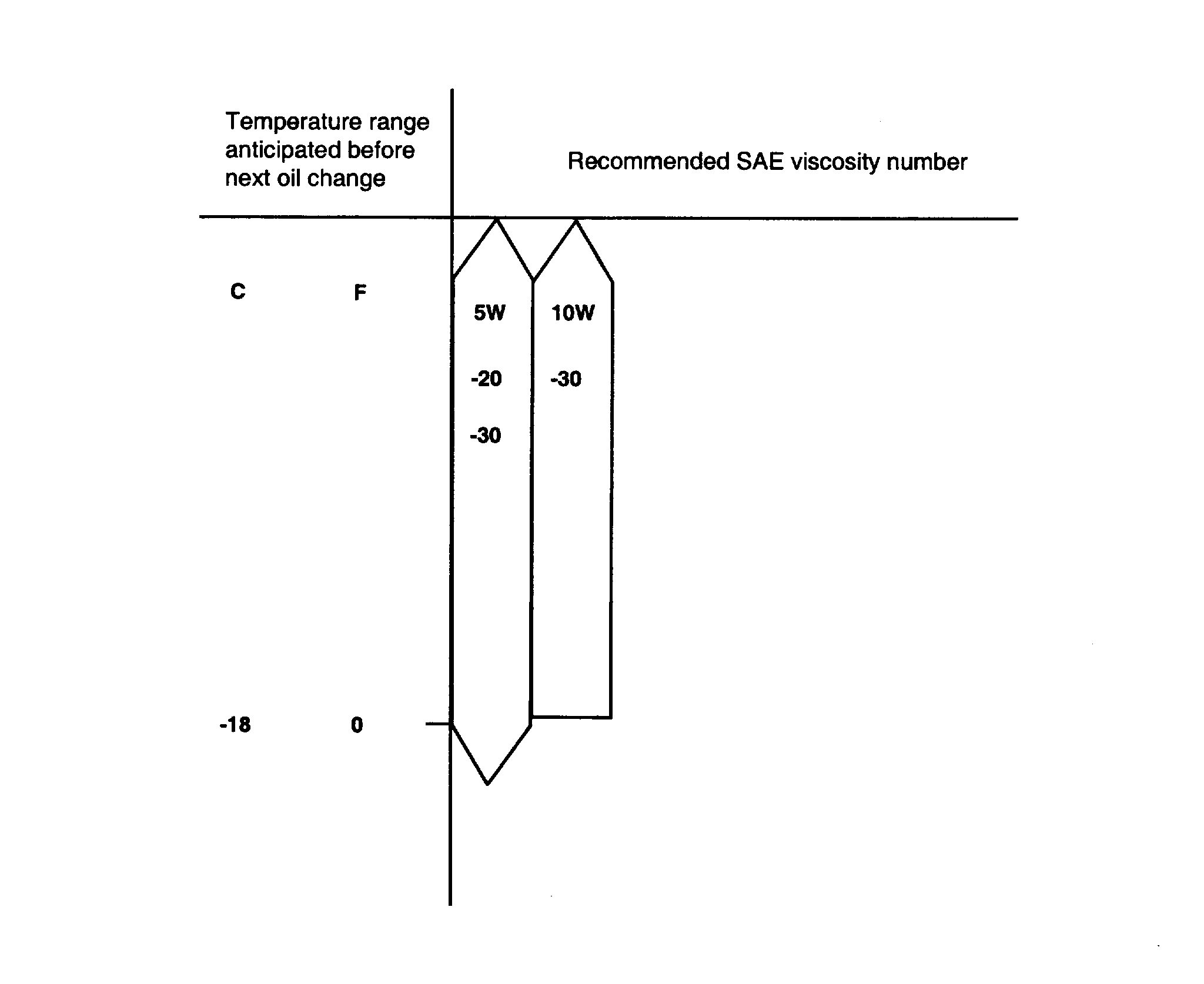

Here are directions specific to your vehicle. The attached pic correlate with the directions.
__________________________________________
2006 Hyundai Sonata L4-2.4L
Procedures
Vehicle Engine, Cooling and Exhaust Engine Engine Lubrication Engine Oil Service and Repair Procedures
PROCEDURES
OIL AND FILTER
CAUTION:
- Prolonged and repeated contact with mineral oil will result in the removal of natural fats from the skin, leading to dryness, irritation and dermatitis. In addition, used engine oil contains potentially harmful contaminants which may cause skin cancer.
- Exercise caution in order to minimize the length and frequency of contact of your skin to used oil. Wear protective clothing and gloves. Wash your skin thoroughly with soap and water, or use water-less hand cleaner, to remove any used engine oil. Do not use gasoline, thinners, or solvents.
- In order to preserve the environment, used oil and used oil filter must be disposed of only at designated disposal sites.
1. Drain engine oil.
a. Remove the oil filter cap.
b. Remove the oil drain plug, and drain the oil into a container.
2. Replace oil filter.
a. Remove the oil filter.
b. Check and clean the oil filter installation surface.
c. Check the part number of the new oil filter is as same as old one.
d. Apply clean engine oil to the gasket of a new oil filter.
e. Lightly screw the oil filter into place, and tighten it until the gasket contacts the seat.
Tightening torque 11.76 - 15.68 Nm (1.2 - 1.6 kgf.m, 8.67 - 11.57 ft. lbs.)
3. Refill with engine oil filter.
a. Clean and install the oil drain plug with a new gasket.
Tightening torque 39.2 - 44.1 Nm (4.0 - 4.5 kgf.m, 28.9 - 32.5 ft. lbs.)
b. Fill with fresh engine oil
Capacity Drain and refill
W/Oil filter change: 4.01 (4.23 U.S. quarts, 3.52 Imp quarts)
W/O Oil filter change: 3.71 (3.90 U.S. quarts, 3.26 Imp quarts)
c. Install the oil filter cap.
4. Start engine and check for oil leaks.
5. Recheck engine oil level.
INSPECTION
1. Check engine oil quality.
Check the oil for deterioration, entry of water, discoloring or thinning.
If the quality is visibly poor, replace the oil.
2. Check engine oil level.
After warming up the engine and then 5 minutes after the engine stop, oil level should be between the L" and " F" marks on the dipstick.
If low, check for leakage and add oil up to the "F" mark.
NOTE: Do not fill with engine oil above the " F" mark.
SELECTION OF ENGINE OIL
Recommended API classification: SJ OR ABOVE
Recommended SAE viscosity grades: 5W-20
If 5W-20 engine oil is not available, secondary recommended engine oil can be used for the corresponding temperature range.
NOTE: For best performance and maximum protection of all types of operation, select only those lubricants which:
- Satisfy the requirement of the API classification.
- Have proper SAE grade number for expected ambient temperature range.
Lubricants that do not have both an SAE grade number and API service classification on the container should not be used.
