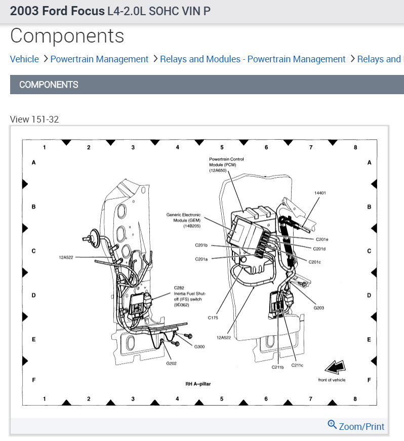

Great, I would get a used PCM and plug it in to see what happens. My thinking is the computer is slow to boot which keeps the car from starting. Here is the PCM location.
