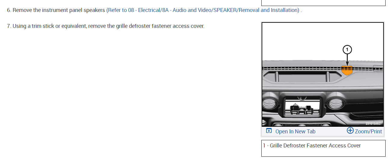

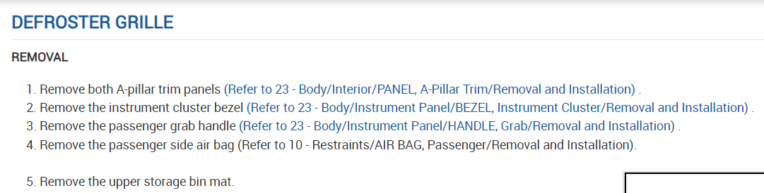

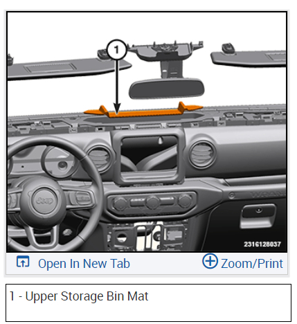

I dropped a necklace in the defrost vent, how can I remove it?
2024 JEEP WRANGLER
7,500 MILES
KATMATUTE
I dropped a necklace down my defrost vents how can i get it out?
Oct 21, 2024 at 11:41 PM
  • 55,432 POSTS

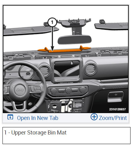

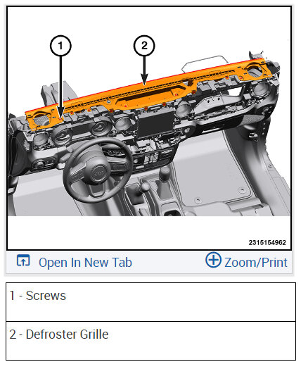

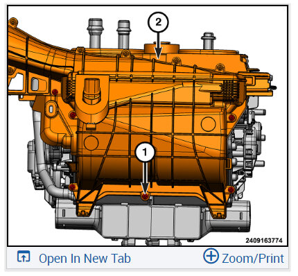

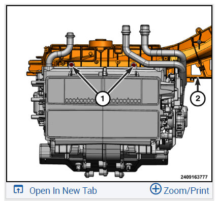

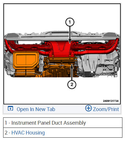

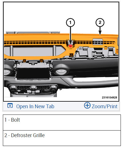

Hmm, I am sorry to hear that, this problems happens and there is no correct answer to help this but I would remove the defroster grill to see if it is there and has not dropped further down, if so, the HVAC system will need to be disassembled to do exploration until the necklace is found. Here is what you are in for when doing the job. Check out the images (below). Please upload pictures or videos in your response of any problems so we can see what to help you with.
