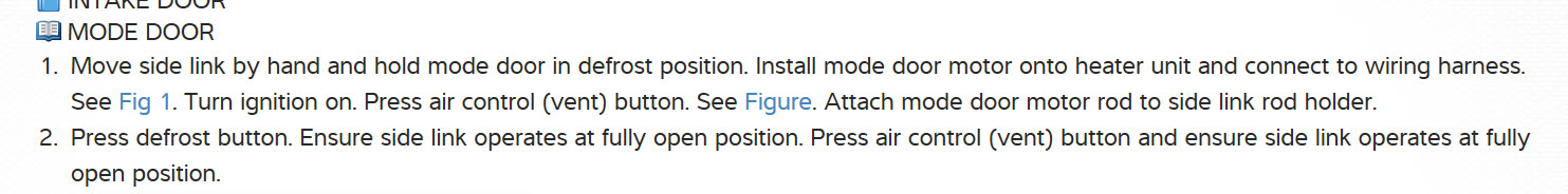

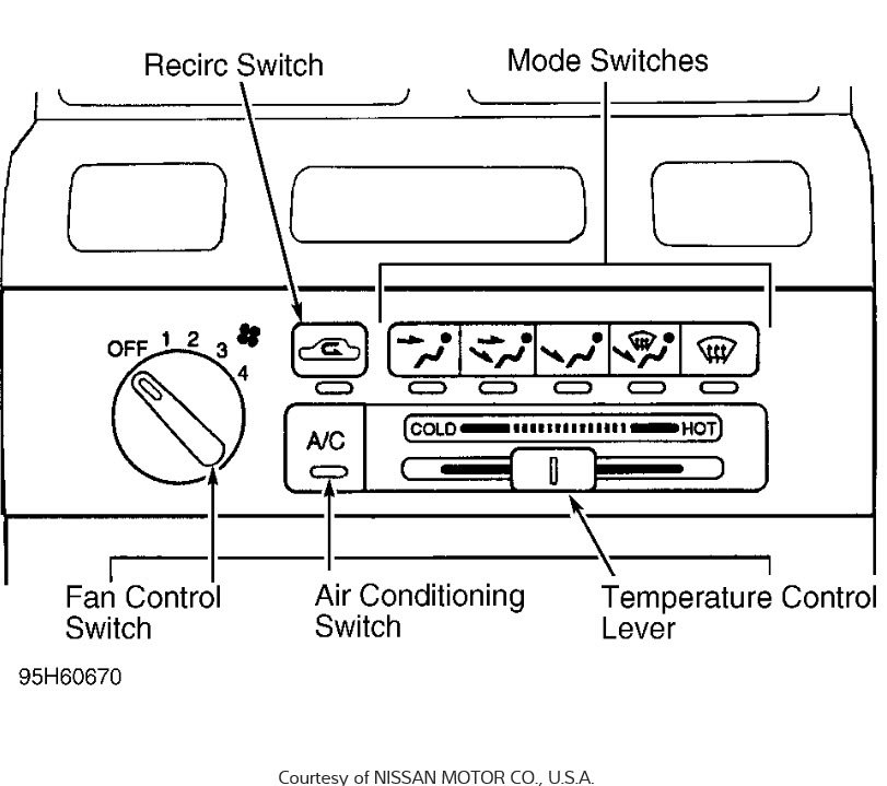

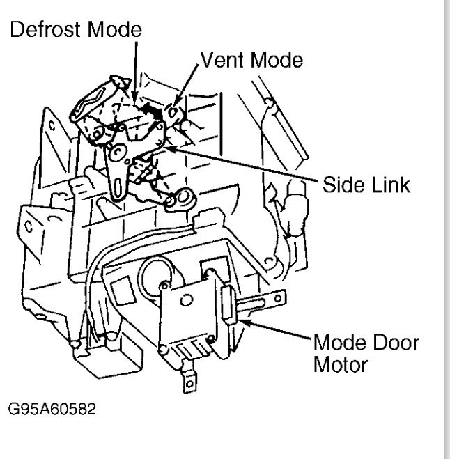

Where is the defroster relay located on my car?
Thursday, November 10th, 2016 AT 3:13 PM
HMAC300
MECHANIC
48,601 POSTS
There is no relay it is a mode door and motor or linkage is messed up. See pictures on how to adjust or replace it.
