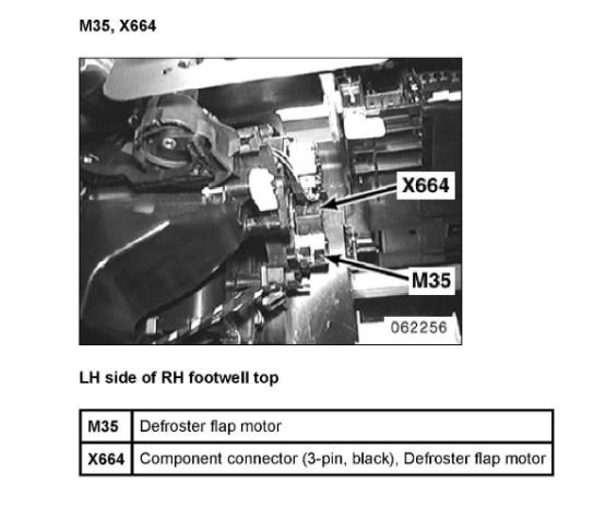

The defroster for my windshield does not work, so when I drive in windy/cold/rainy weather, it gets all foggy, which makes me have to drive with my window down or else I won't be able to see through the windshield. Every other vents in the car works, both with cold and warm air. So it's only the vent for the windshield that is malfunctioning.I do not know if this has to anything to do with the problem, but when I turn on the my car, there seems to be a knocking sound for maybe 1 minute or so from the vents in the front/radio unit. Do you have any idea what that could be about?

I have been told that it possibly could be the blend door actuator, but where is that located on my BMW E46 318i from 2001? Please I need help.

Good afternoon,
There is a defroster flap door motor that controls the opening of the vent. It sounds like that motor is bad.
I attached the location of the motor for you on the heater case.It is under the dash and not much involved in changing the motor. Remove the connector and the screws that secure it to the case.

I changed the motor and now it is fresh. Thank you for you help!
