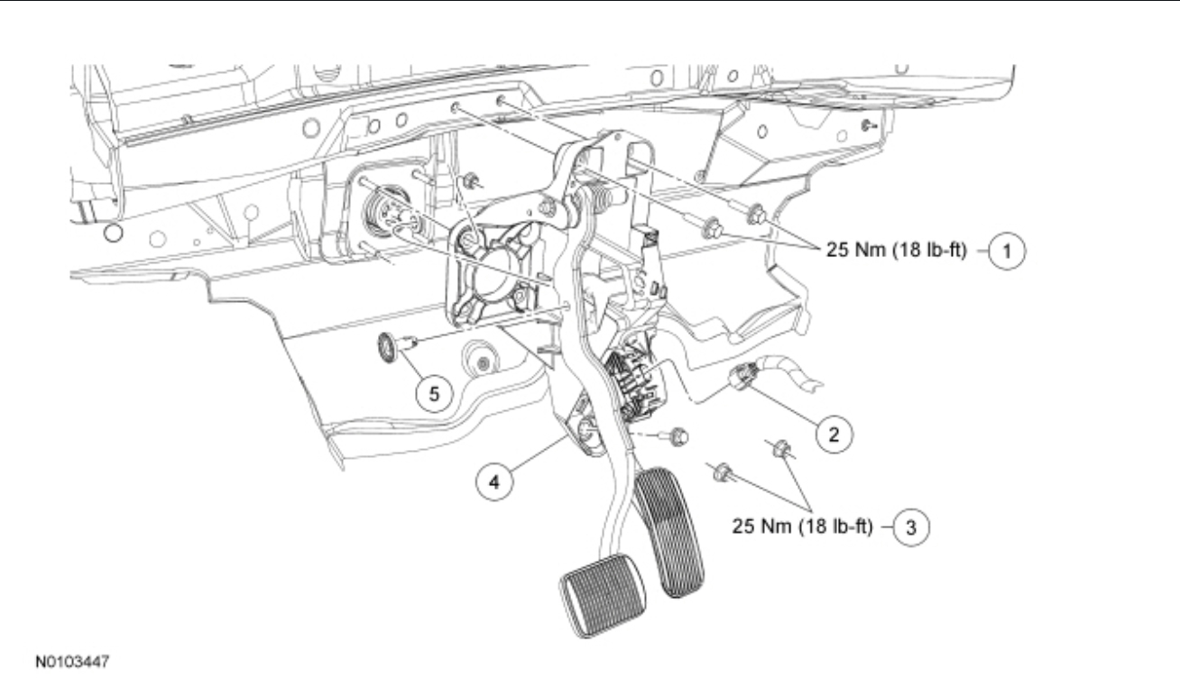

Exploded View
pic 1
Item Service Part Number Description Torque Material Name Notes
1 W709633 Brake pedal bracket bolts (3 required) - - 25 Nm (18 lb-ft)
2 - Accelerator pedal sensor electrical connector (part of 14401) - - -
3 W520112 Brake booster nuts (4 required) - - 25 Nm (18 lb-ft)
4 9F856 Brake pedal and bracket assembly - - -
5 2L523 Brake booster push rod clevis pin - - -

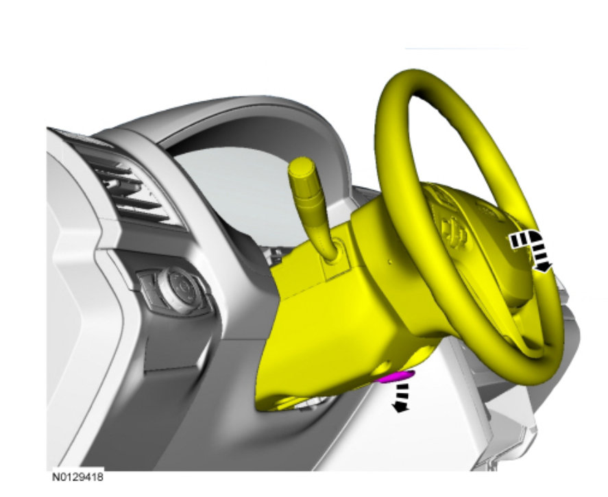

Removal
If equipped with adjustable pedals, make sure they are in the full forward position.
Remove the steering column. REFER to Section 211-04, Steering Column
Disconnect the accelerator pedal sensor electrical connector and detach the wire harness from the brake pedal assembly.
NOTICE: Do not service the brake pedal or brake booster without first removing the stoplamp switch. The switch must be removed with the brake pedal in the at-rest position. The switch plunger must be compressed for the switch to rotate in the bracket. Attempting to remove the switch when the plunger is extended (during pedal apply) will result in damage to the switch.
Remove the stoplamp switch. REFER to Section 417-01, Stoplamp Switch
NOTE: The booster push rod clevis locking pin is a one-time use only part. Any time the pin is removed, a new one must be installed.
NOTE: An 11 mm, 12-point socket or wrench can be used to compress the 2 tabs on the locking pin.
Remove and discard the booster push rod locking pin.
Remove the 4 brake booster nuts.
Position the brake booster forward enough to allow the brake booster studs to clear the brake pedal assembly.
If equipped with ambient lighting, remove the retainer and position aside the LF footwell lamp.
Remove the lower brake pedal bracket bolt, under the accelerator pedal, from the brake pedal bracket assembly.
Remove the upper 2 brake pedal bracket bolts from the brake pedal bracket assembly.
Disconnect the vehicle electrical harness locators and remove the brake pedal bracket assembly from the vehicle.

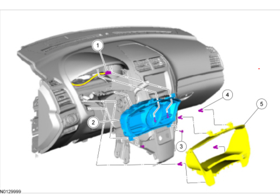

Instrument Panel Cluster (IPC)
Exploded View
NOTE: Steering wheel shown removed for clarity.
pic 2
1 - IPC electrical connector (part of 14401) - - -
2 10849 IPC - - -
3 W707628 IPC screws (4 required) 3 Nm (27 lb-in) - -
4 W710338 IPC trim panel clip - - -
5 78044D70 IPC trim panel - - -

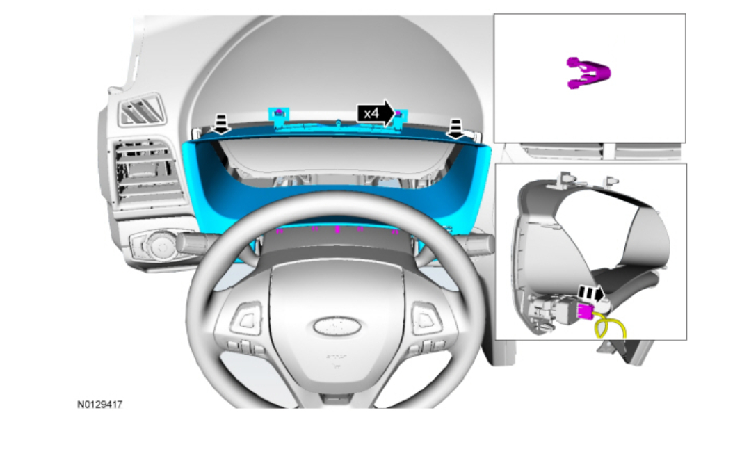

pic 3
Unclip the gap hider from the upper steering column shroud.

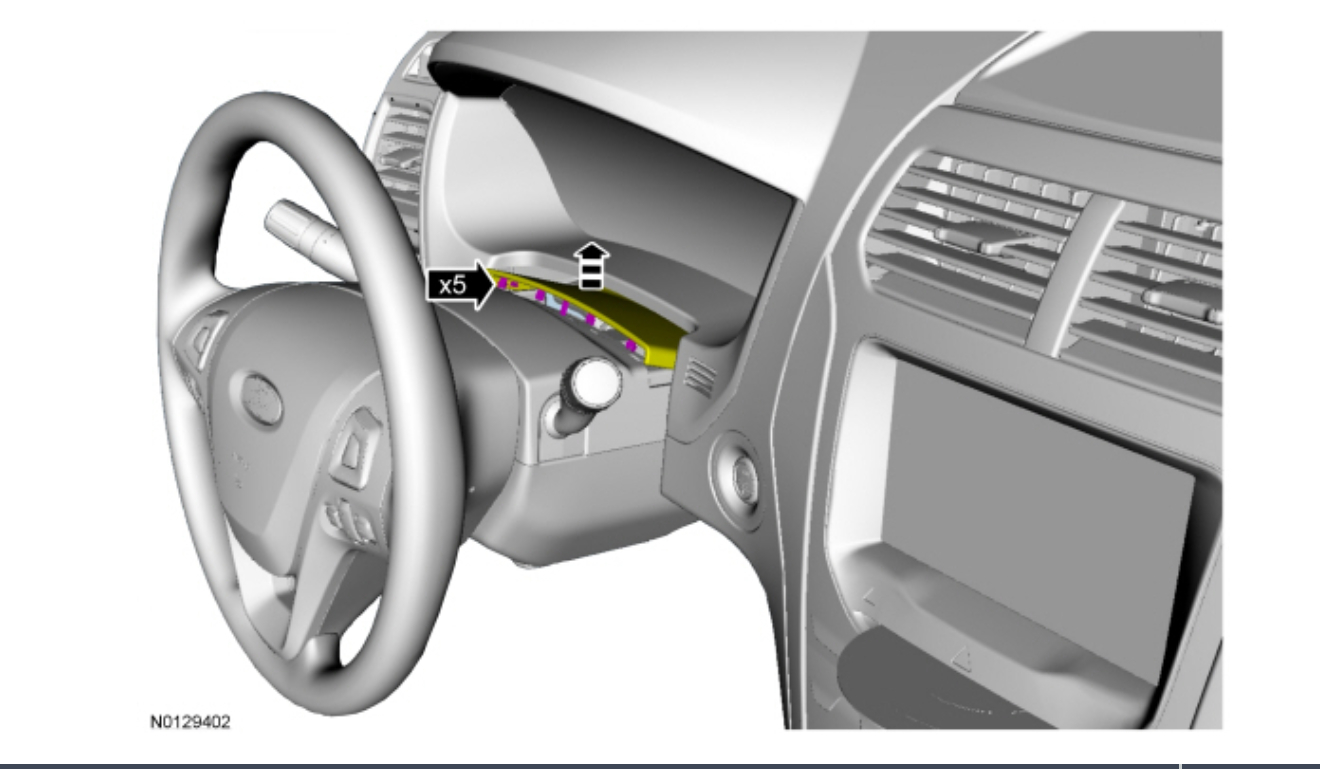

pic 4
Release the 4 clips and remove the IPC bezel.

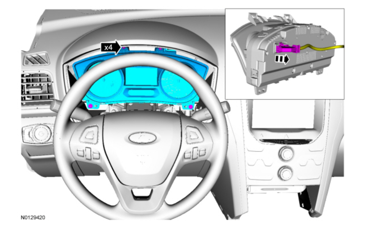

pic 5
Remove the 4 IPC screws and remove the IPC .
To install, tighten to 3 Nm (27 lb-in).
