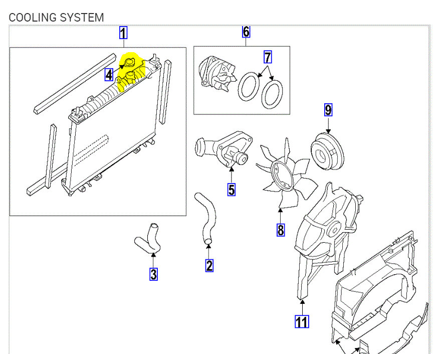

for the past few weeks, in the mornings when it's really cold and the windshield is icy and needs to be defrosted, only cold air comes out. i let it run for 15 minutes or so, and nothing. but when i drive it, it takes only one mile to clear the windshield to clear and hot air blowing. what could this be? Thanks, Tarp

The first thing that it sounds like is the engine coolant is low. Have you checked it? In addition to the coolant reservoir, when the engine is cold and if you have a radiator cap (it should) on the radiator, check the level in the radiator also. However, only open it when the engine is cold.
Let me know what you find.
See pic below.

Thank you, Joe. i went to two auto repair shops and they said it could be the heater core. went to a parts store, and the lady asked when the last time i checked the coolant. After a few seconds, she said, never mind, check the coolant and then come back to me. checked it this morning and sure enough, it's low and none in the reservoir. Thanks for responding.

I had a feeling that was the issue. Did you refill both the radiator and the reservoir? Also, pay attention to see if you notice any leaks or excessive white smoke from the exhaust. It went somewhere. LOL
When the car was at an idle, there wasn't enough coolant to circulate. Once the engine speed was increased, the water pump spun faster and got some to the heater core.
