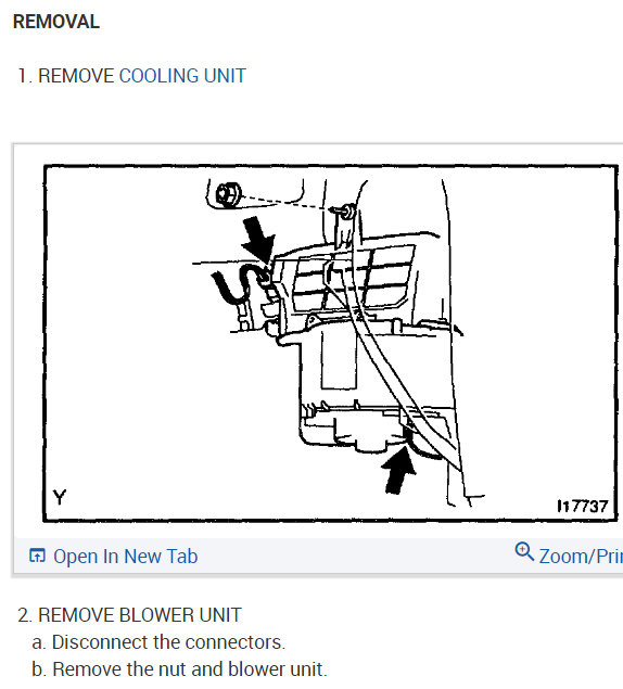

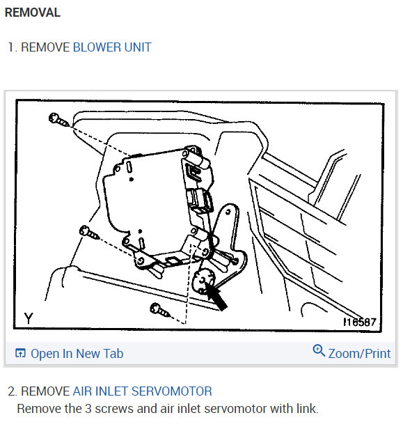

No air goes to windshield. When I close the vents for face I hear screech noise.

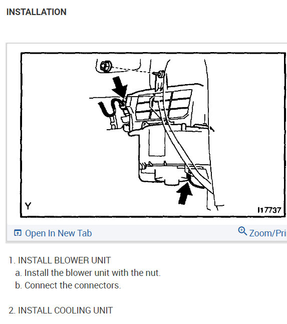

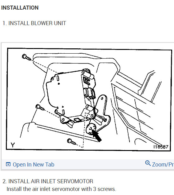

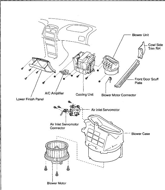

It sounds like you might be having a problem with the air door - blend door actuator. It is a small electric motor that opens up the duct doors to route air throughout the various ducts. Here is a tutorial showing what is involved for its replacement:
I've attached picture steps below on replacement for your car. Hope this helps and thanks for using 2CarPros.
