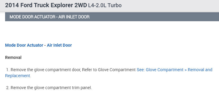

Hello again.

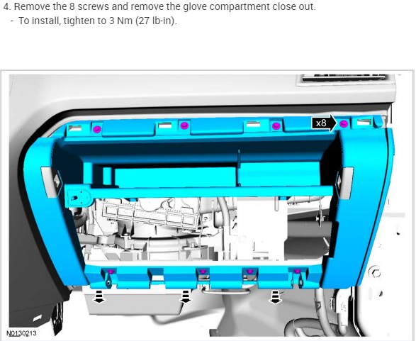

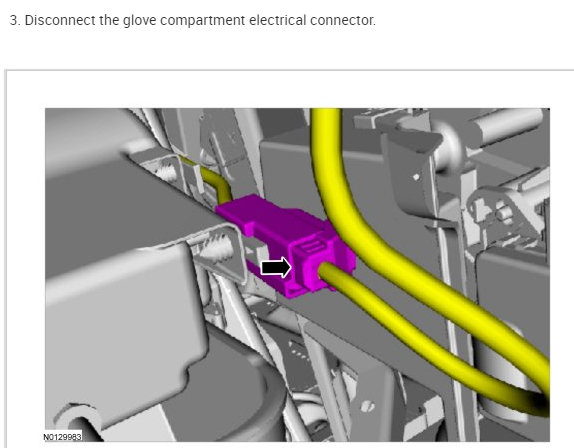

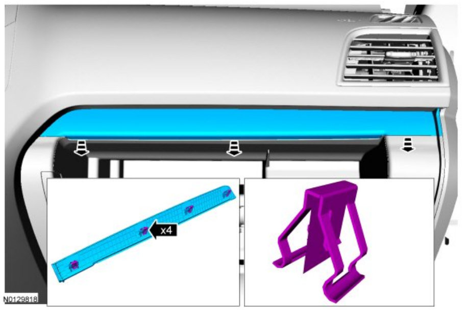

Here is a tutorial showing what is involved for the blend/mode door actuator:
I've attached step-by-step instructions pictures below.Hope this helps and thanks again for using 2CarPros.
Danny-
Images (Click to enlarge)
