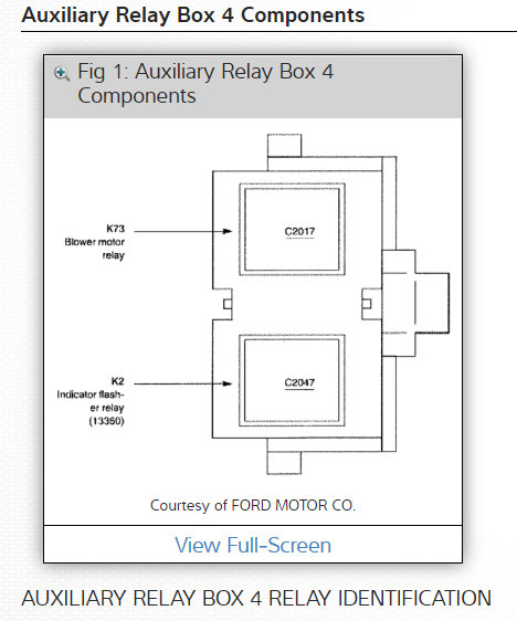

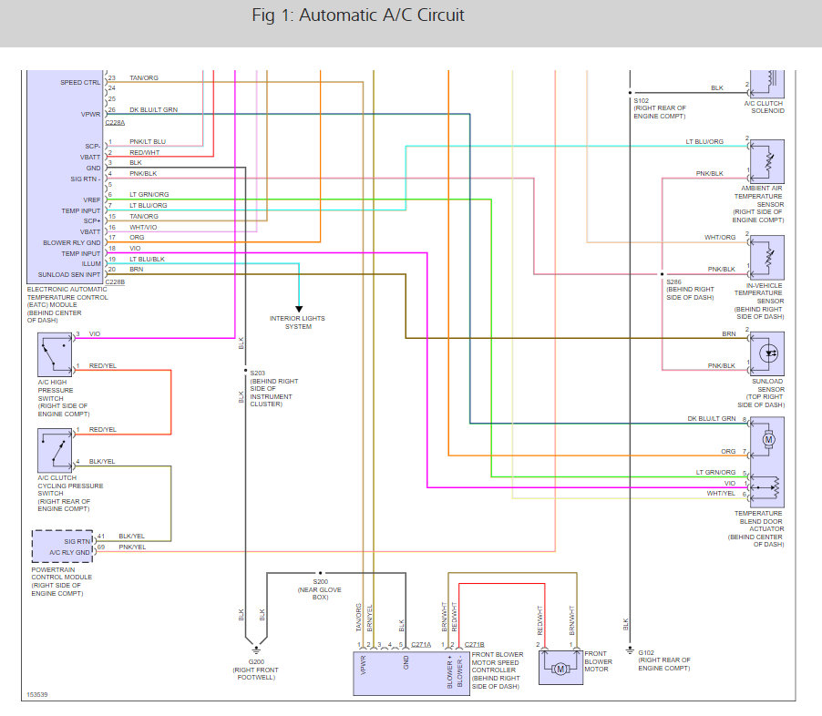

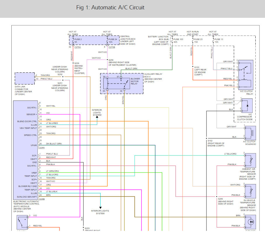

Will not stop until I disconnect battery and reconnect. All controls work when truck is running. Radio turns off sporadically. Rain seems to cause the trouble.
Oct 6, 2018 at 3:41 AM
  • 55,746 POSTS
It sounds like the blower motor relay is stuck on. Here is a wiring diagrams so you can see how the system works and a guide to help you test the relay with the relay location as well:
