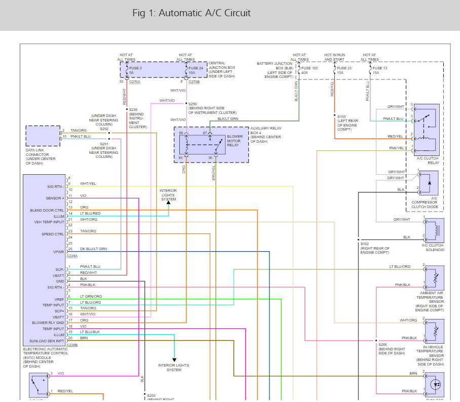

blower motor will not stop until I disconnect battery
2002 FORD F-150
209,000 MILES • 5.4L • V8 • 4WD • AUTOMATIC
RICK WATZ
Will not stop until I disconnect battery and reconnect. All controls work when truck is running. Radio turns off sporadically. Rain seems to cause the trouble.

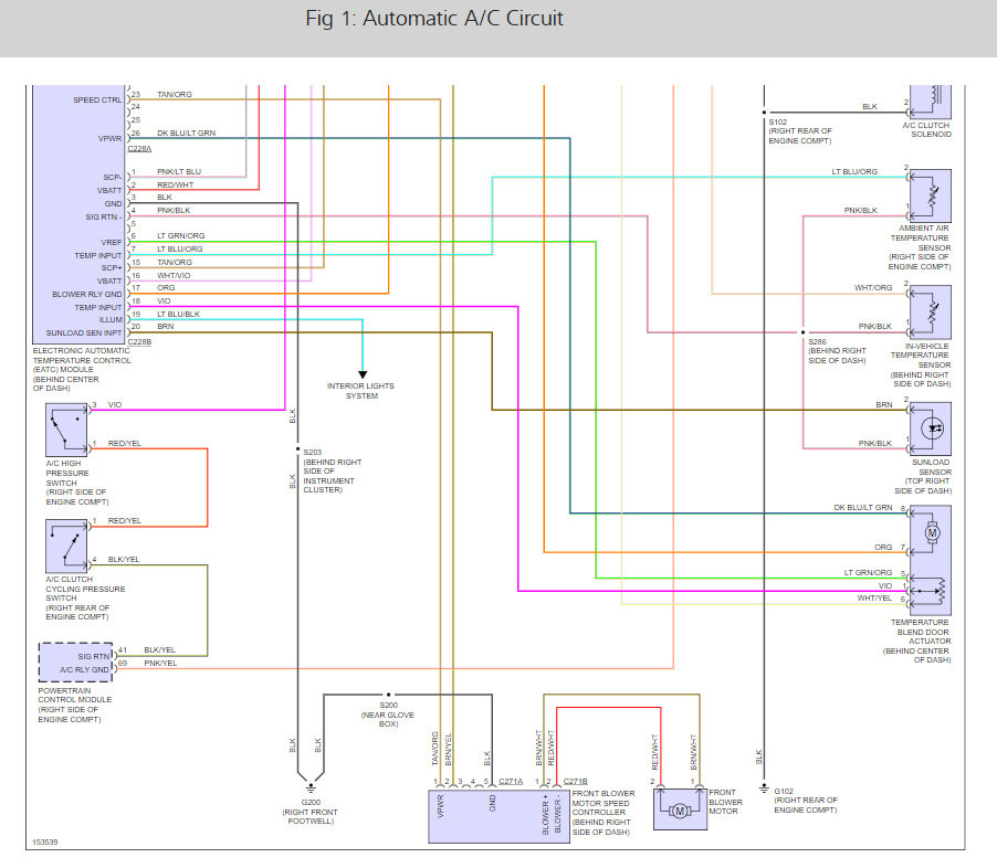

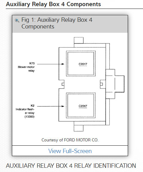

It sounds like the blower motor relay is stuck on. Here is a wiring diagrams so you can see how the system works and a guide to help you test the relay with the relay location as well:
