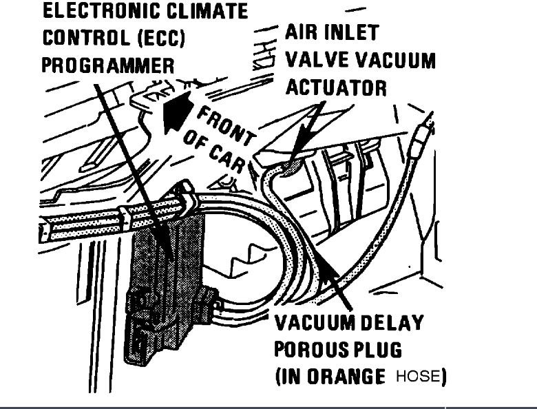

Car blow heat from the vent but not from the floor board and defrost vent.
Jan 22, 2019 at 5:37 PM
Good evening
The most common cause for this is the programmer for the AC. It is the box behind the glove box that has the rod coming out that moves the door for air flow.
Can you hear or see it moving when you command defrost and floor?

OK, good chance the programmer is not commanding the door positions to change.

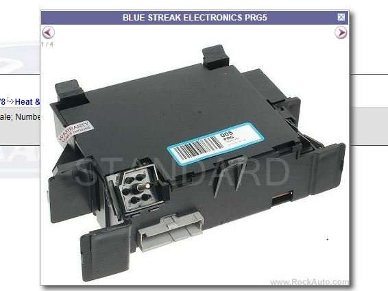

So what is the name of the part I need to look for?
Jan 22, 2019 at 8:34 PM
Ac programmer. I showed you the part from rock auto
Jan 22, 2019 at 8:37 PM
NALLS
  • 15 POSTS
My year doesn't call for a programmer. 91 cadillac brougham 5.7 engine
Jan 22, 2019 at 8:48 PM
NALLS
  • 15 POSTS
My bad found it
Jan 22, 2019 at 8:53 PM
Yes, they changed that system in 93.

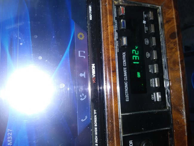

I also noticed I'm pulling a code 132 and 141
Jan 23, 2019 at 5:02 AM
Where did you get those codes from?
Jan 23, 2019 at 5:04 AM
NALLS
  • 15 POSTS
From my ecc
Jan 23, 2019 at 5:05 AM
Did they have a E or F in front of them?
Jan 23, 2019 at 5:22 AM
NALLS
  • 15 POSTS
Neither just numbes
Jan 23, 2019 at 5:52 AM
NALLS
  • 15 POSTS

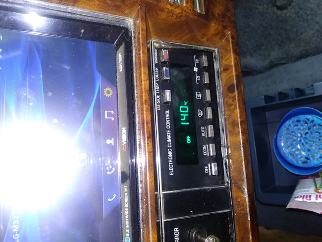

Error I mean 140 and 132
Jan 23, 2019 at 5:54 AM

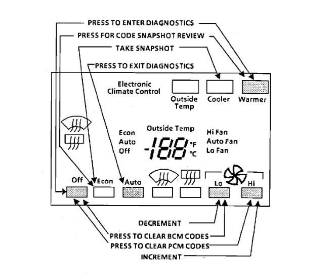

They are not codes.
When you hold the off and warmer buttons at the same time, it will go into diagnostic mode.
The codes with start with the letter E and then numbers. When that is completed it will list F and then numbers.
When that is complete then it will display 7.0.

OK, then follow the instructions I sent you and the on-screen picture I sent and take a screenshot of your results and upload it here for me to see.

Readings
Jan 23, 2019 at 10:20 AM
They are not codes. Did they appear right after putting it into diagnostics?
This may be the programmer sending bad info. With the replacement, it should show the correct format.
Jan 23, 2019 at 10:23 AM
NALLS
  • 15 POSTS
Yes once I pressed both buttons it started showing these codes. So are you saying the programmer may solve this ?
Jan 23, 2019 at 10:30 AM
Yes, that is the incorrect format.
The programmer controls this.
