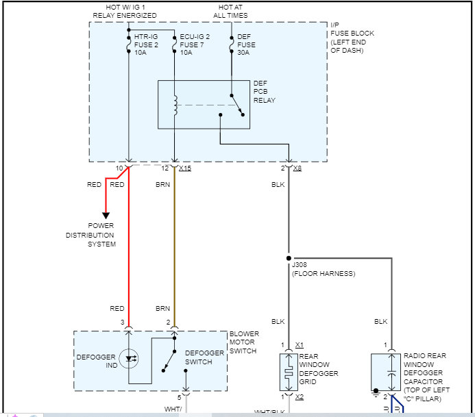

I want to add heated mirrors in my car.
My only problem now is identifying defrost rear window wires and then tap in there.
Thanks
Aug 31, 2022 at 12:08 PM
  • 110,240 POSTS

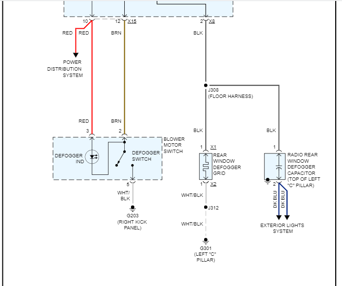

I attached the wiring schematic for the rear window defogger below. The pic was only one page long, but I cut it in half to make it readable for you.
I do have concerns about doing this. You are placing a heavier load on the circuit. It may cause the fuse to fail and more importantly, the defogger relay.
The relay isn't a traditional relay. It is not replaceable. It is part of a printed circuit board. If it fails, the only repair is the replacement of the box. That can get expensive.
However, that is your call. I just wanted to let you know about that.
Take care and let me know if you have questions.
