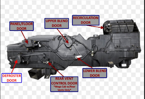

The passenger side defrost door must not be closing quite all the way. If I’m on anything except the defrost, there’s an annoying whistling coming from there. Is that an actuator or something else and how do I access whatever I need to repair/replace?
Jun 17, 2022 at 7:33 AM
I just responded to the other question and asked you to get a new one posted.
Thanks for already doing that.

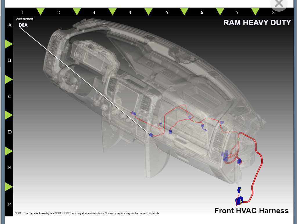

Can you do a test for me? Can you get the whistle to start and then press the recirc button and see if it goes away?
If it does, then this is a fresh air/recirc door issue. Also, the fact that this is only on one side and a dual zone temperature truck means we need to suspect it is one of the passenger side actuators or doors that is not sealing.
Based on what happens when we try to narrow this down, I am sure we will be able to target it.
However, the other way that may be quicker is to access the side that is making the noise and remove the actuators one at a time and manually move the door to see if it will seal. If it does, then the actuator is the issue. If not, then we have a cracked door.
Below is the location of the actuator for the recirc but let's start with this and see what we can figure out. Thanks

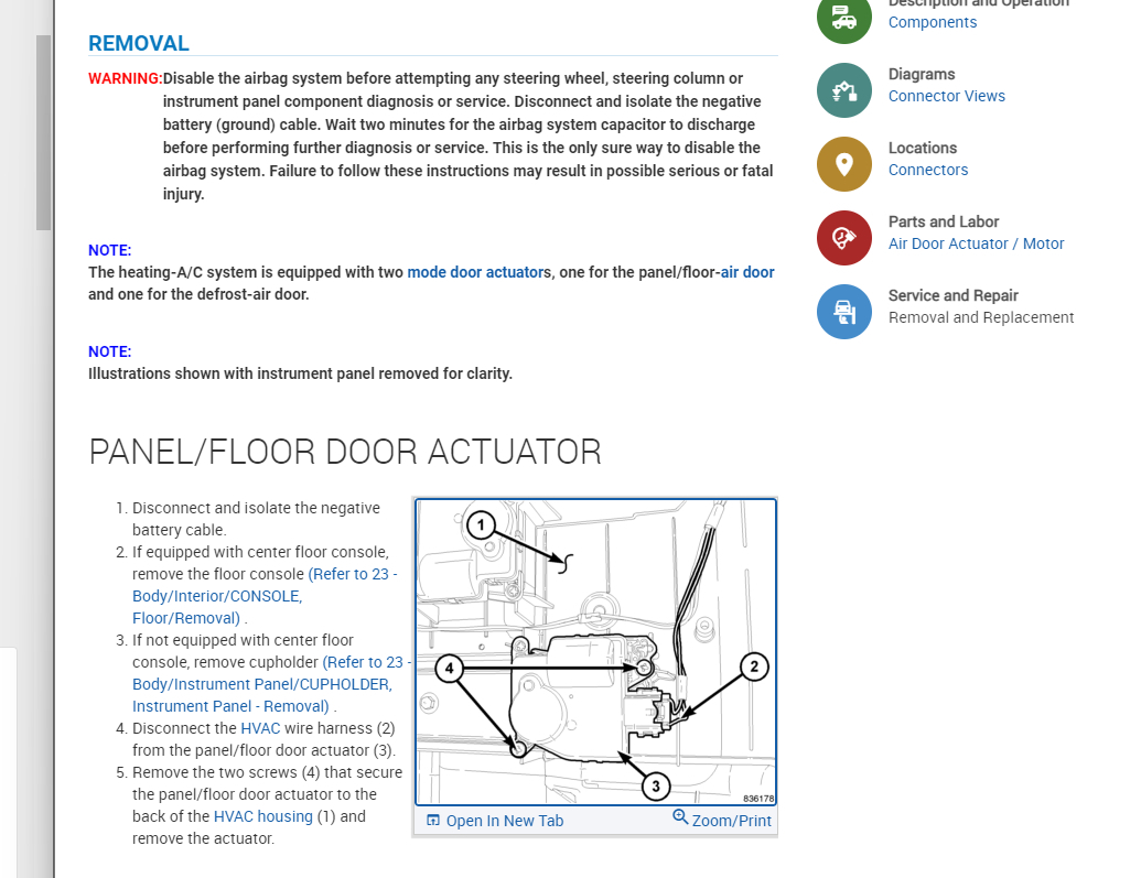

Okay. So, this is most likely going to be a mode door issue.
Basically, if you are putting it in defrost and the issue stops then that means all the air is being routed to the windshield and it is not even getting to the mode door which distributes the air to the vents or floor.
So, what I would do is remove this actuator and manually move the door and turn the system on so that it makes the noise. This is going to tell us if we have an actuator issue or not.
I attached the info below for this.

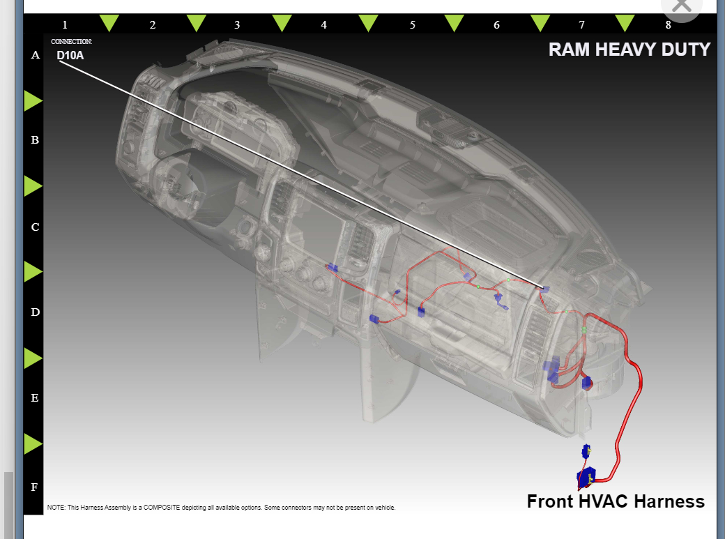

Well, that makes me a little nervous but if this only makes the noise when you are moving then that has to be related to the recirc/fresh air door.
So based on all this, if it were me, I would replace that actuator and see what happens.
Jun 18, 2022 at 5:30 PM
18RAM2500
  • 10 POSTS

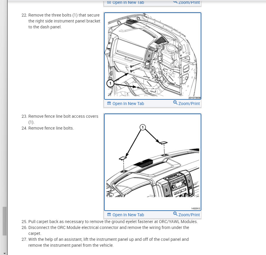

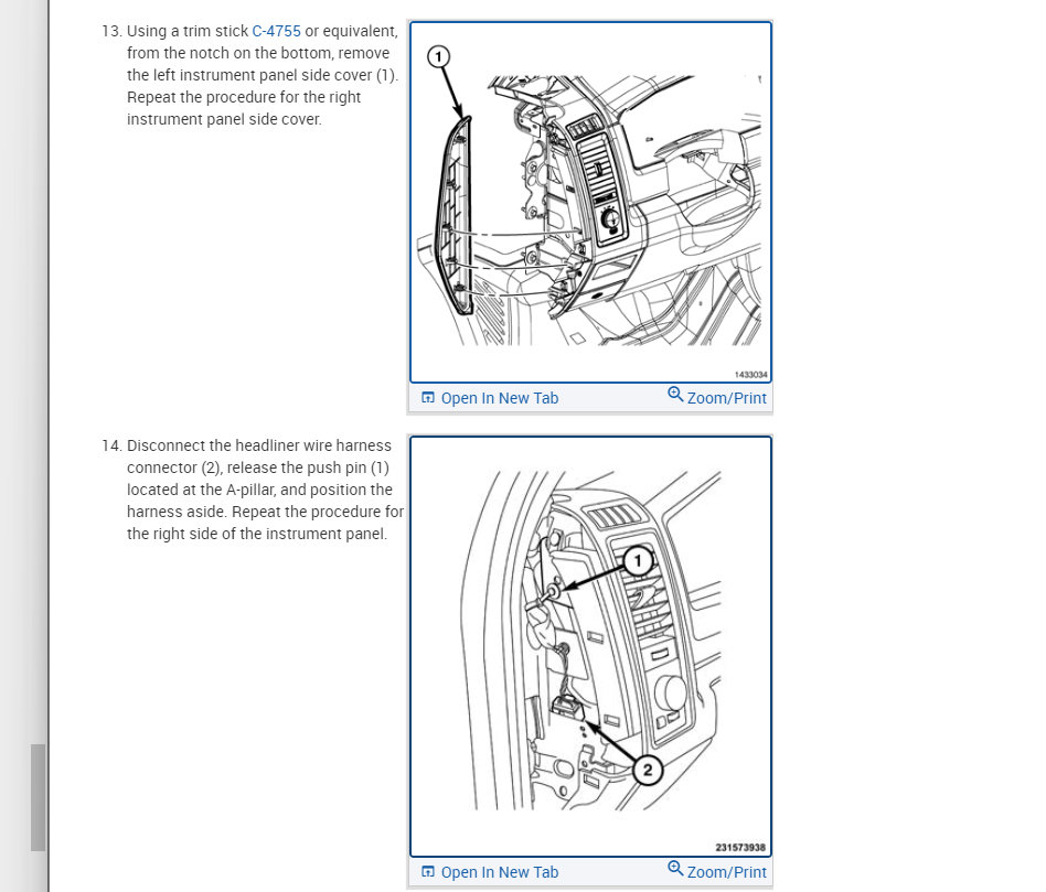

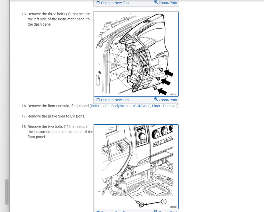

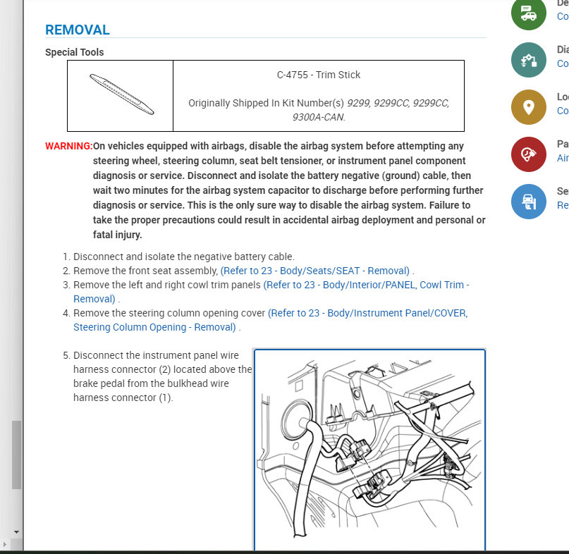

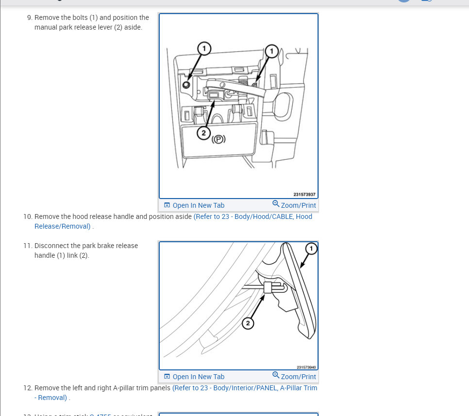

Where was that one located? Looked like it might be behind the upper glove box or something. Is it accessible that way?
Jun 18, 2022 at 5:36 PM
Sorry. I thought I included that before. However, I didn't give this detail. I was sure this one was, but the instructions say you have to pull the panel down.
I attached that process as well. It is more work, but it is not terrible.
Jun 18, 2022 at 5:56 PM
18RAM2500
  • 10 POSTS
Oh, wow, that looks like a big job!
