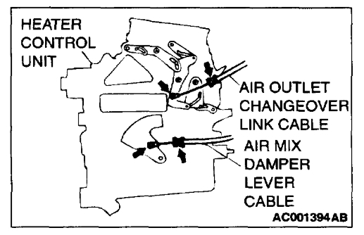

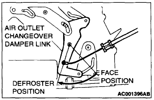

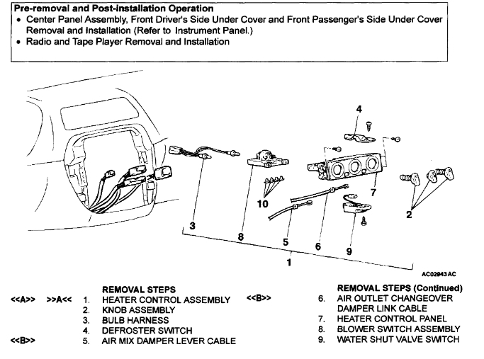

I have a 2002 Mitsubishi galant and the defrost will not work every setting wants to blow out of the vents and out the floor. Fan works the dash is broken and a piece is gone but that doesn't seem to matter I also have a 2001 galant same car dash is broken but it will still change to defrost
Jul 22, 2026 at 7:26 PM
  • 55,766 POSTS
So the mode cable sounds like it is broken or the mount for it is broken, here is what I would check to fix the problem. Check out the images (below). Please upload an image or a short video in your response
