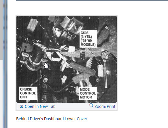

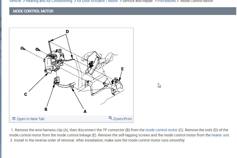

My HVAC will not blow air from the side vents (passenger/driver) or the little side window defroster vents, the center vents work fine. All settings seem to work fine. What could be wrong?
Dec 17, 2020 at 4:48 AM (Merged)
This is due to the mode door actuator not functioning correctly. Here is a guide that will help:
https://www.2carpros.com/articles/air-vents-stay-in-the-defrost-position
Also, I am attaching the process from the manual that will show how to replace it. Let's run through this material and let us know if there are questions. Thanks
