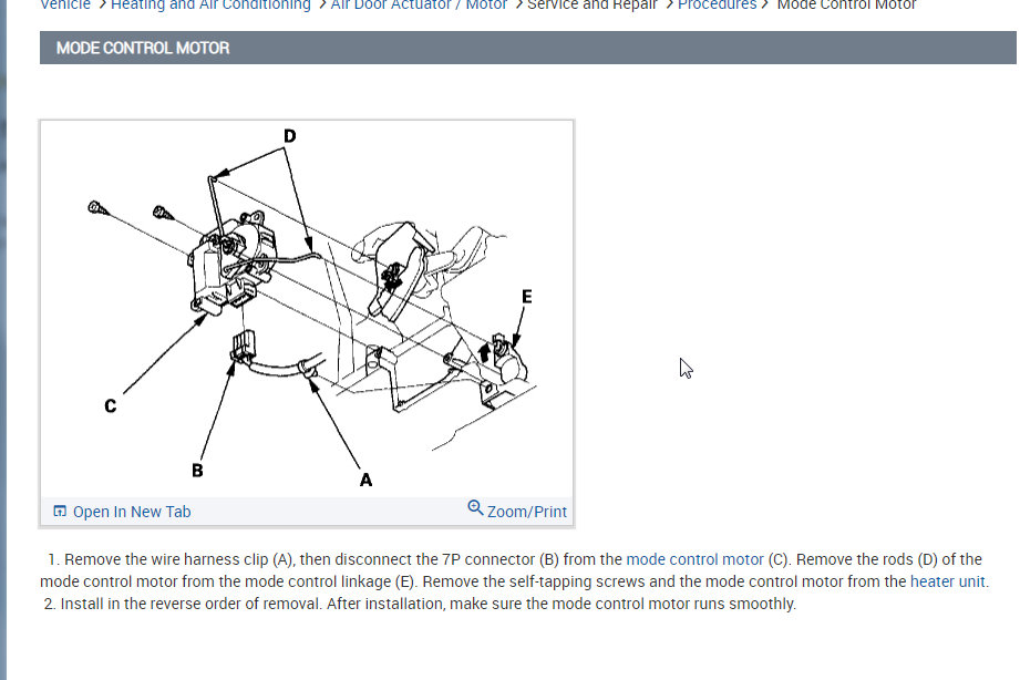

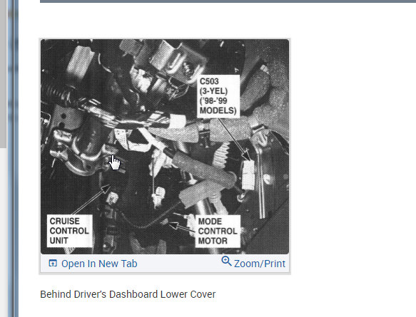

This is due to the mode door actuator not functioning correctly. Here is a guide that will help:
https://www.2carpros.com/articles/air-vents-stay-in-the-defrost-position
Also, I am attaching the process from the manual that will show how to replace it. Let's run through this material and let us know if there are questions. Thanks

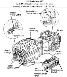

Im trying to figure out why my car defrost is not doing the job. The back window defrost a little, but the front window when I cut the defroster on it begins to fog the window up more. My heater also doesnt work that well. It blows air out but the air is not hot. I really need to know whats going on with it and hopefully its not all that expensive to fix the problem. But its so dangerous driving around and can barely see out my widows.
Dec 17, 2020 at 4:49 AM (Merged)
KHLOW2008
  • 41,814 POSTS
Hi bneal09, Check the air mix cable adjustment. If the air mix door is not functioning correctly, heated air would be affected. Check the coolant level in radiator.
https://images.2carpros.com/forum/automotive_pictures/192750_HeaterAssy92AccordFig01_1.jpg
FUNCTION CONTROL CABLE Slide function control lever to defrost position. Move heater control arm to defrost position in door link slot. Connect heater control cable to heater control arm, and gently eliminate any slack. DO NOT allow heater control arm to move. Snap cable housing into clamp.
