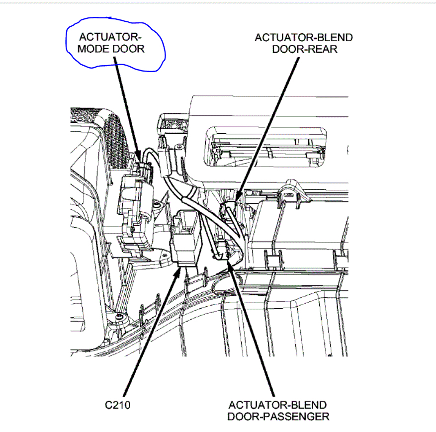

There is just a tiny little bit of warm air coming out in the driver's side in the area for feet while there's super much hot air coming through at the passenger's side. The three smaller defrost heaters directly at the windshield don't work at all, there's no air coming through. The two larger heaters just a little further away from the wind shield work perfectly fine. As it is very cold right now, my windshield would freeze while driving. I tried to find hoses that have leaks but I couldn't. Is this a well known problem with the van listed above is the SE model and can I fix it by myself? What parts would I need and how expensive is it going to be? Unfortunately, I had to replace lots of things already and I just have the car for three months... Would be so grateful for your help!! Thank you very much!

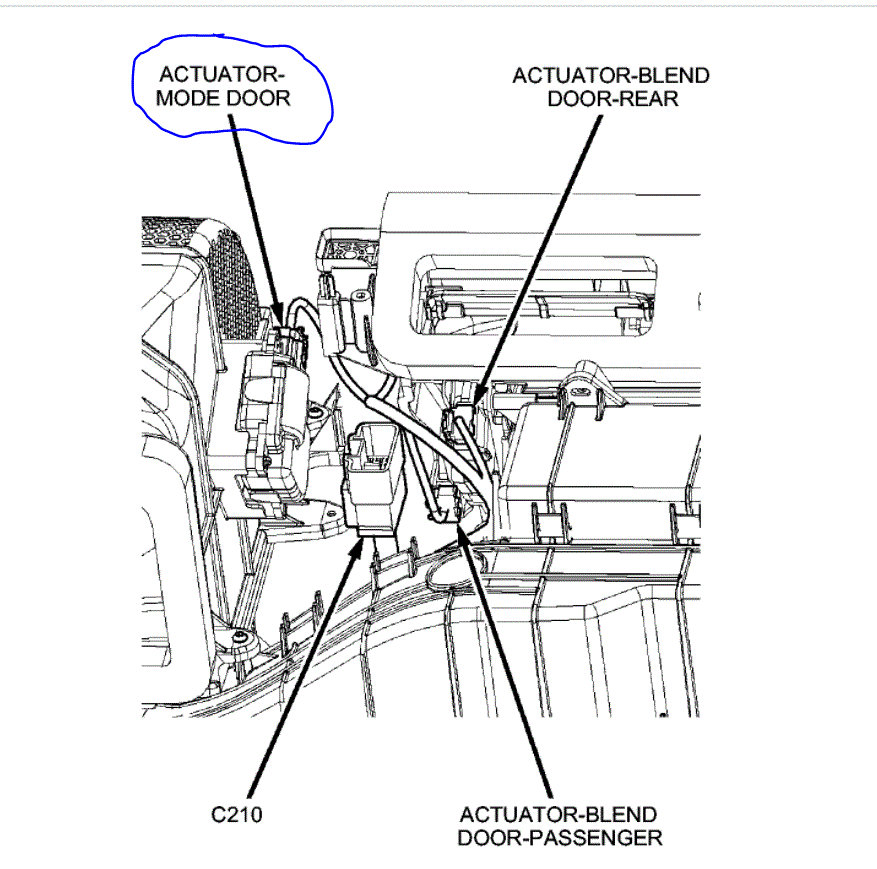

Whenever there is an airflow direction issue, it is usually related to a mode door actuator. That actuator moves a door in the HVAC system that changes the directions the air moves.
Now, I attached a pic below showing the actuator I am referring to, but I need to know two things before I suggest replacing it. First, does this vehicle have automatic or manual climate control? Next, when you change the airflow directions, for example, defroster to the floor, does it work?

When I choose defroster, 2 out of the 5 air slots provide warm air. When I change to floor, the passenger side works very well, just the driver's site not really. There's just a hint of air coming through.
I've got a manual climate control.

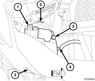

At this point, it sounds like it is related to the mode door or the mode door actuator. What I would suggest is to remove the mode door actuator and inspect it. There is a plastic gear on it that can fail. It may not be fully moving the door.
Here are the directions for removal. The attached pic correlates with the directions. Install will be the opposite.

pic 1
NOTE: LHD model shown. RHD model similar.
1. Disconnect and isolate the negative battery cable. See: Battery > Service and Repair
2. If equipped, remove the silencer from underneath the passenger side of the instrument panel. See: Dashboard / Instrument Panel > Service and Repair
3. Remove the lower glove box bin from the instrument panel. See: Glove Compartment > Service and Repair
4. Remove the lower trim panel (3) from the passenger side of the instrument panel to gain access to the mode door actuator (1).
5. Remove the two screws (3) that secure the mode door actuator to the bracket (2) located on the passenger side of the HVAC air distribution housing and remove the actuator from the bracket.
6. Disengage the red locking tab and disconnect the wire harness connector (4) from the mode door actuator and remove the actuator from the vehicle.
