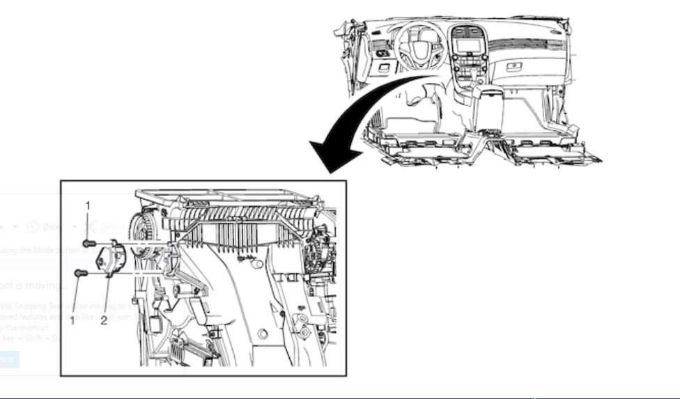

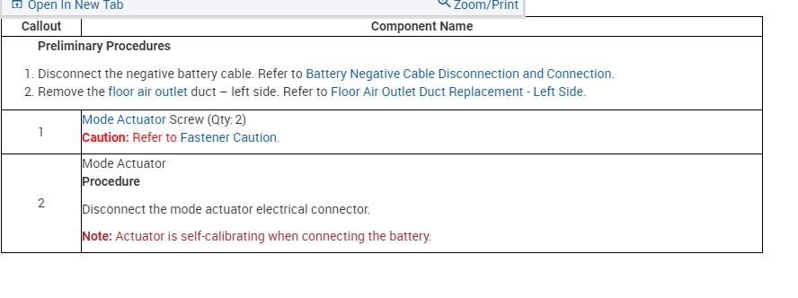

The HVAC system won’t send air to the windshield. It stays on the face. I was wondering where the location of the blend actuator that controls this is? Also where’s the temperature blend actuator? Thank you!
Dec 30, 2019 at 2:21 PM
Good morning,
I attached the procedure and a picture for you of the actuator for the mode door.
The blend door actuator is there as well.
