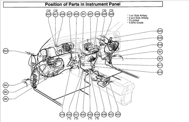

My climate control system is stuck in the dash vent position and will not shift. Should I replace the blend door actuator or is there a defrost actuator?
Feb 27, 2018 at 2:39 AM
  • 55,684 POSTS
Yes is does sounds like you have a defrost blend door actuator that is not working.
Here is a guide to help you see what you are in for when doing the job:

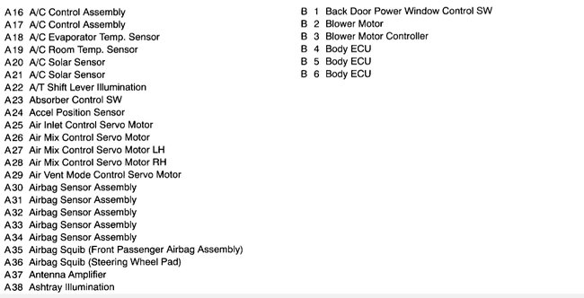

Here is the locations of all the blend door actuators for reference (below).
