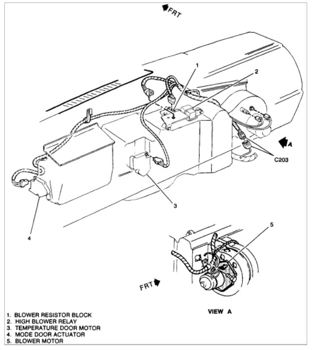

When i turn my defrost on, it works on all parts except it does not blow out the driver windshield. So the entire car defrosts except the part i need to see out to drive. When i do turn it on high it makes a high pitch whining. I do not think its the actuator but i do not know. It is not stuck in defrost either.

Do you get any air out of the drivers defrost at all? High whine sounds like a blocked duct. It is one piece so if leaves or similar got in there and blocked it you would need to take out the dash to get the duct work out. If you look into the duct can you see anything?

There is no air coming out of the drivers defrost at all. I looked in there and there seems to be nothing blocking it or covering it.

To me it sounds like the mode door actuator is not working but to be sure remove the actuator and then turn the system on and move the pivot back and forth to see if it makes a change and the defroster starts working.
Here isa guide to help see what I am talking about.
Here is the location for your truck (below)
