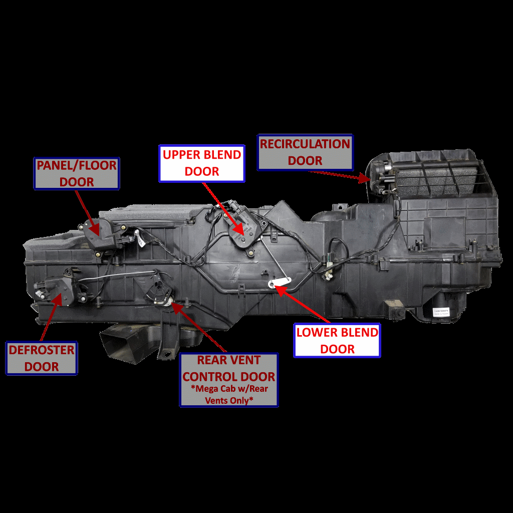

Got in my truck the other morning to find I have no defroster. The fan is blowing on all speeds, just cold air. Tried it on heater, same thing. Where should I start to look for the trouble first?

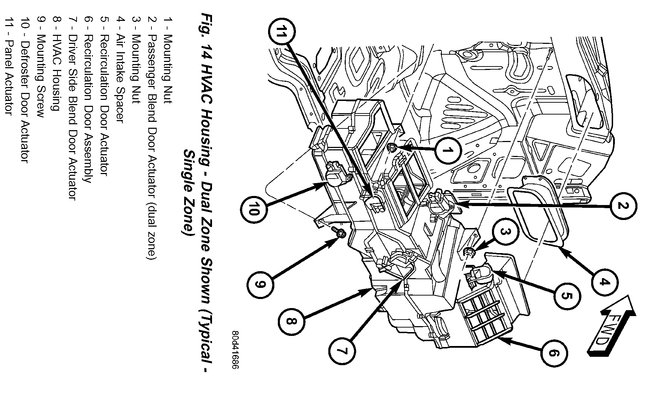

Just to confirm. Is the problem no heat, the inability to change air flow direction, or both? If it is heat, first confirm the engine coolant level is full. If this happened all at once, then suspect a bad blend air door. Take a look through this link:
If you suspect that is the issue, here are the directions specific to your vehicle for replacement. The attached pic 1 correlates with the directions.
The single zone heating and air conditioning system is equipped with a single blend door actuator. The dual zone system has two blend door actuators, one for the driver side blend air door and one for the passenger side blend air door. The same service procedures can be used for each of these actuators.
1. Disconnect and isolate the battery negative cable.
2. Remove the instrument panel assembly.
Fig. 14 HVAC Housing - Dual Zone Shown (Typical - Single Zone)
3. Disconnect the HVAC wire harness connector for the blend door actuator from the actuator connector receptacle..
4. Remove the screws that secure the blend door actuator to the distribution housing.
5. Remove the blend door actuator from the distribution housing.
INSTALLATION
1. Position the blend door actuator into the heater/air conditioner housing. If necessary rotate the actuator slightly to align the splines on the actuator output shaft with those in the blend air door linkage.
2. Install and tighten the three screws that secure the blend door actuator to the distribution housing. Tighten the screws to 2 Nm (17 in. lbs.).
3. Reconnect the HVAC wire harness connector for the blend door actuator to the actuator connector receptacle.
4. Install the instrument panel assembly.
5. Reconnect the battery negative cable.
6. Perform the heater-A/C control calibration procedure.

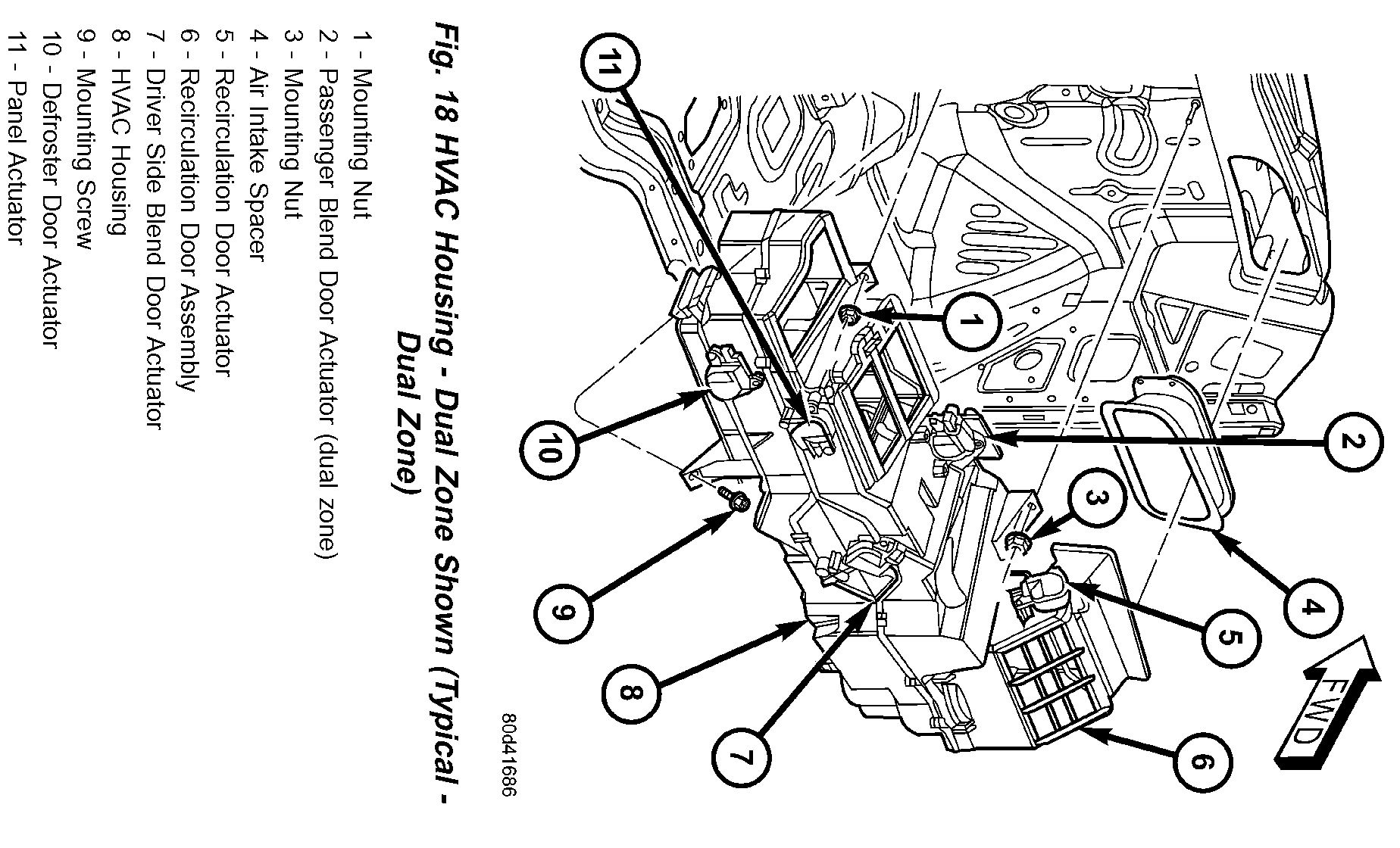

If there is also a problem with controlling air flow direction, then the issue is most likely related to a mode door actuator. This component is what is responsible for the flow direction.
3. Disconnect the electrical connector from the actuator (single or dual zone as required).
Fig. 18 HVAC Housing - Dual Zone Shown (Typical - Dual Zone)
4. Remove the two screws that secure the mode door actuators to the distribution housing. For single zone systems only lower actuator in present. For dual zone systems remove second actuator which is mounted on top of HVAC housing.
5. Remove the mode door actuators from the distribution housing.
INSTALLATION
1. Position the mode door actuators onto the heater/AC housing. If necessary, rotate the actuator slightly to align the splines on the actuator output shaft with those in the mode door linkage.
2. Install and tighten the two screws that secure the mode door actuators to the distribution housing. Tighten the screws to 2 Nm (17 in. lbs.).
3. Reconnect the HVAC wire harness connector for the mode door actuators to the actuator connector receptacle.

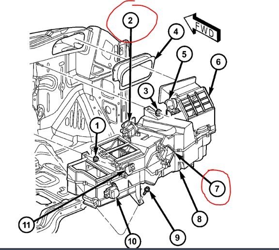

It happened all of a sudden, just no heat.I haven't used the heat since last year, but the A/C worked fine.If it is the blend door (single zone) which door would that be? Would that be the door #7 that needs repaired?
Apr 23, 2021 at 11:48 AM
  • 110,194 POSTS

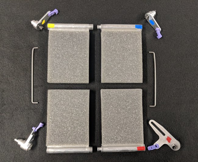

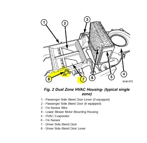

Vehicles equipped with single zone HVAC systems will only have one blend air door. It will be located in the same place but only one will be present. I attached a picture of it and highlighted the side it will most likely be on. If I'm wrong, it will just be on the opposite side.
However, are you getting air flow via the defroster?
Let me know if this helps.

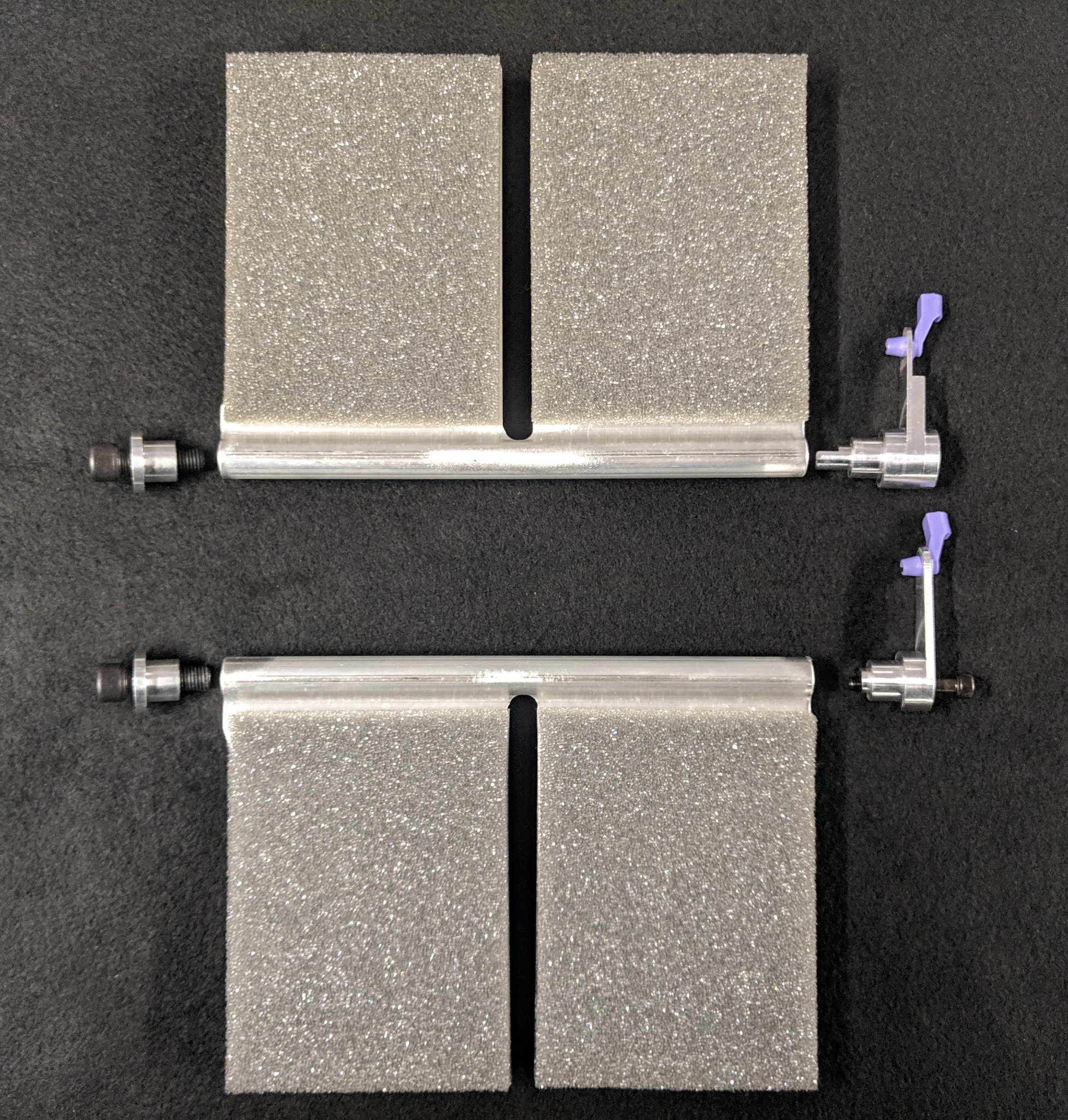

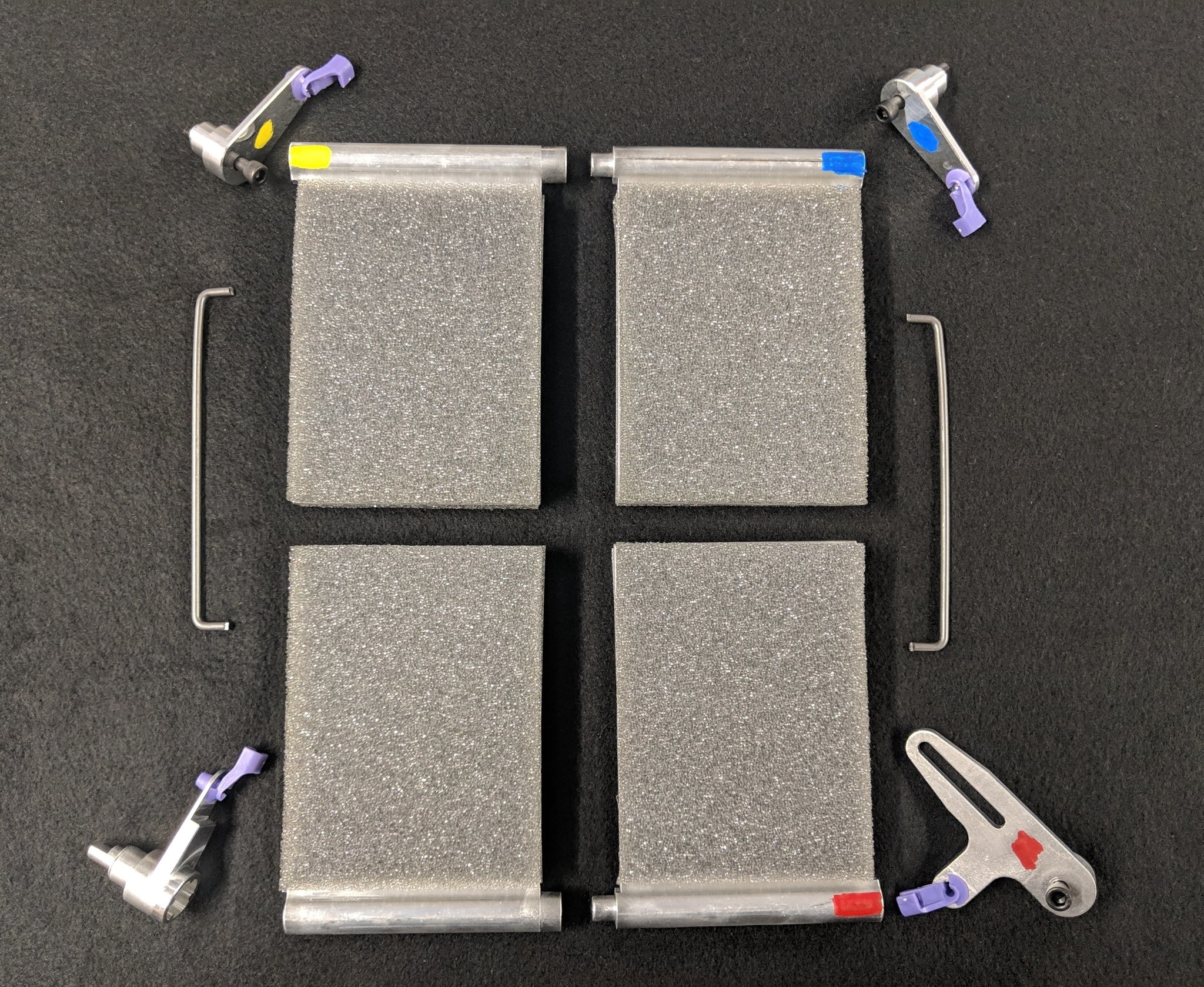

I am getting air to the defrost, cold air, doesn't work well on cold mornings! From my understanding,there is an upper and lower blend door that "clam shells" the heater core. correct?
  • 110,194 POSTS
With dual climate control, there are two. See the attached picture.

This is for a 2003 Ram. They say it is usually the upper door that fails and falls down and blocks the heat from coming in.
SPIKERDUDE39
  • 6 POSTS
The picture sent is a single zone.The first picture is the single zone doors, the second is for a dual zone.There seems to be four separate doors for the dual zone blend doors. I know I don't have dual zone because of the controller for the heating/cooling system.

  • 110,194 POSTS
Yes, that is correct. In the manual, it shows two actuators for single zone. One at the top and one at the bottom. Was it the lower one you already replaced?

  • 6 POSTS
There aren't 2 actuators for the single zone.The actuator can be seen in the photo above. The upper and lower doors are connected by a metal rod. The dual zone has a second actuator on the firewall side that the passenger can adjust the temperature separately from the driver, hence the separate doors for the dual zone. Sometime, the manuals aren't worth squat!

  • 110,194 POSTS
I'm not sure what you are asking. The pic I sent above shows two different actuators for a single zone system. I circled them both. Which of those were replaced?
