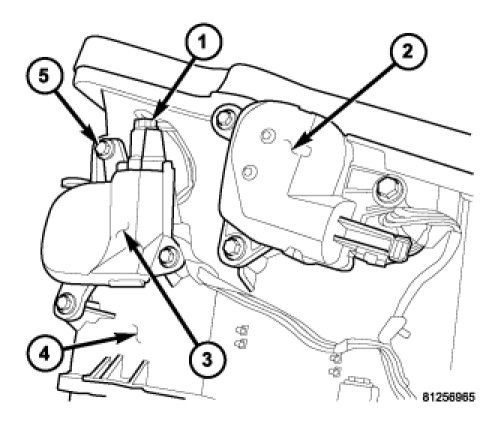

No air flow when set on defrost
2008 CHRYSLER ASPEN
200,000 MILES • 5.7L • V8
JERRYLEEEND
Hot air does come out dash vent and feet vent when selected to do so. Heater does have warm/hot flow of air except for the defrost setting.
Dec 1, 2019 at 5:55 PM
  • 110,194 POSTS
If you have no air flow from the defroster, most likely there is an issue with what is called the mode door actuator.
If you look at pic 1, it shows the actuator I am referring to. Also, here are the directions for removal and replacement of the actuator. The additional attached pics correlate with the directions.

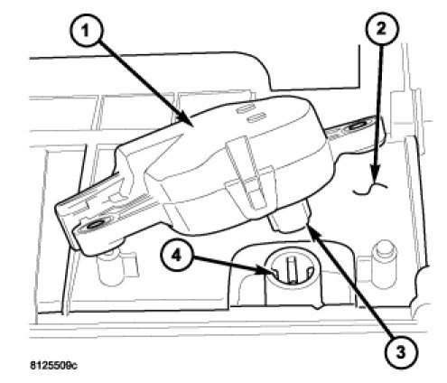

pic 2
1. Disconnect and isolate the negative battery cable.
2. Remove the screws (5) that secure the panel door actuator (2) and the floor/defrost door actuator (3) located on the driver side end of the HVAC housing (4) as required.
3. Disconnect the HVAC wire harness connector (1) from the panel door actuator and the floor/defrost door actuator as required.
4. Remove the mode door actuator(s) from the HVAC housing.

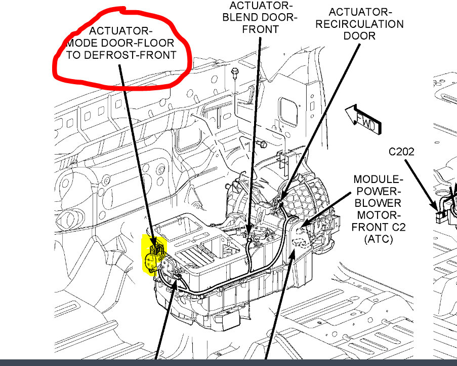

pic 3
1. Position the mode door actuator(s) (1) onto the driver side end of the HVAC housing as required. If necessary, rotate the actuator slightly to align the splines on the actuator output shaft with those in the mode-air door linkage.

Before just replacing the actuator, see if it moves when you adjust from floor to defrost. If it doesn't, replace it. Also, I hope I understood your post. At first you said there is no air flow through the defroster, but later in the post it almost seemed to be only temperature related. The directions are for air flow and not temp, so if I am wrong, let me know.
