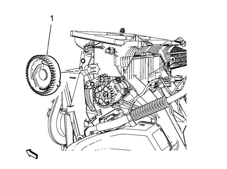

When I push defrost button the air still comes out the front vents. I found a broken gear on the floor. The gear is half of an oval shape. What part do I need to replace it with. My car is the LT model.
Nov 14, 2018 at 5:17 AM
Good evening.
There is a gear on the case that operates the defrost system. I attached a picture and the procedure for the gear replacement.
Mode Control Cam Replacement (Left Hand Drive)
Removal Procedure
1. Remove the brake, accelerator, and clutch pedal. Refer to Brake, Accelerator, and Clutch Pedal Replacement (Left Hand Drive) See: Brake Pedal Assy > Removal and Replacement > Brake, Accelerator, and Clutch Pedal Replacement (Left Hand Drive).
2. Remove the mode control cam actuator. Refer to Mode Control Cam Actuator Replacement See: Air Door Actuator / Motor, HVAC > Removal and Replacement > Mode Control Cam Actuator Replacement
3. Remove mode control cam (1).
