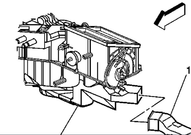

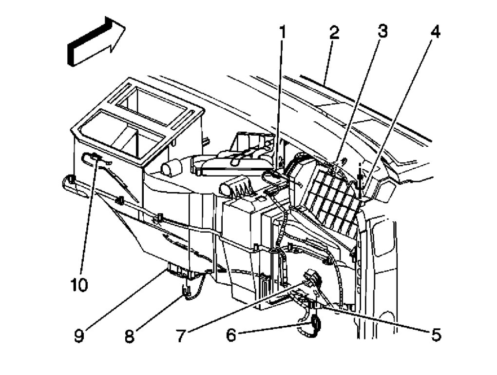

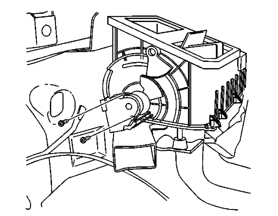

Heat will not blow out defrost stays blowing out dash vents.
Feb 11, 2021 at 8:44 AM
Good afternoon,
You have a mode door actuator that changes the direction of the air flow when you command different directions.
https://www.2carpros.com/articles/air-vents-stay-in-the-defrost-position
I attached the procedure and some pictures for you.
REMOVAL PROCEDURE
1. Remove the floor air outlet duct extension (1) from the floor duct (2).
2. Disconnect the electrical connection at the mode actuator (10).
3. Remove the mode actuator mounting screws from the HVAC module.
4. Remove the mode actuator as an assembly with the actuator cam.
