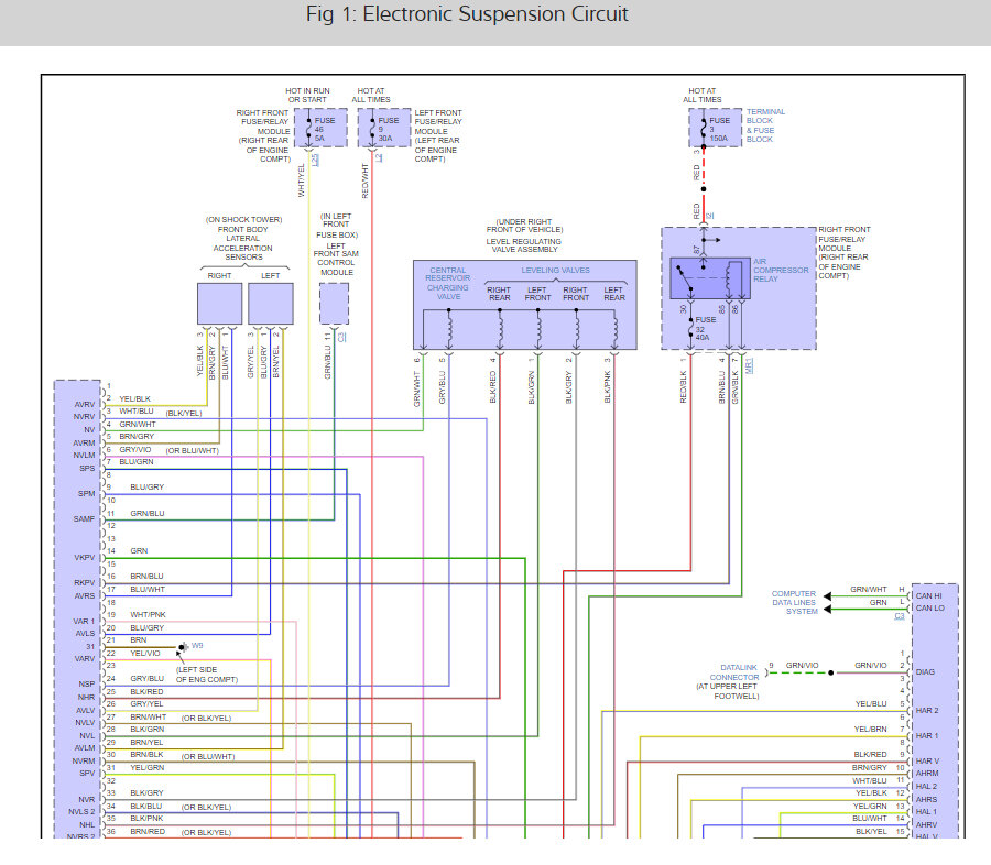

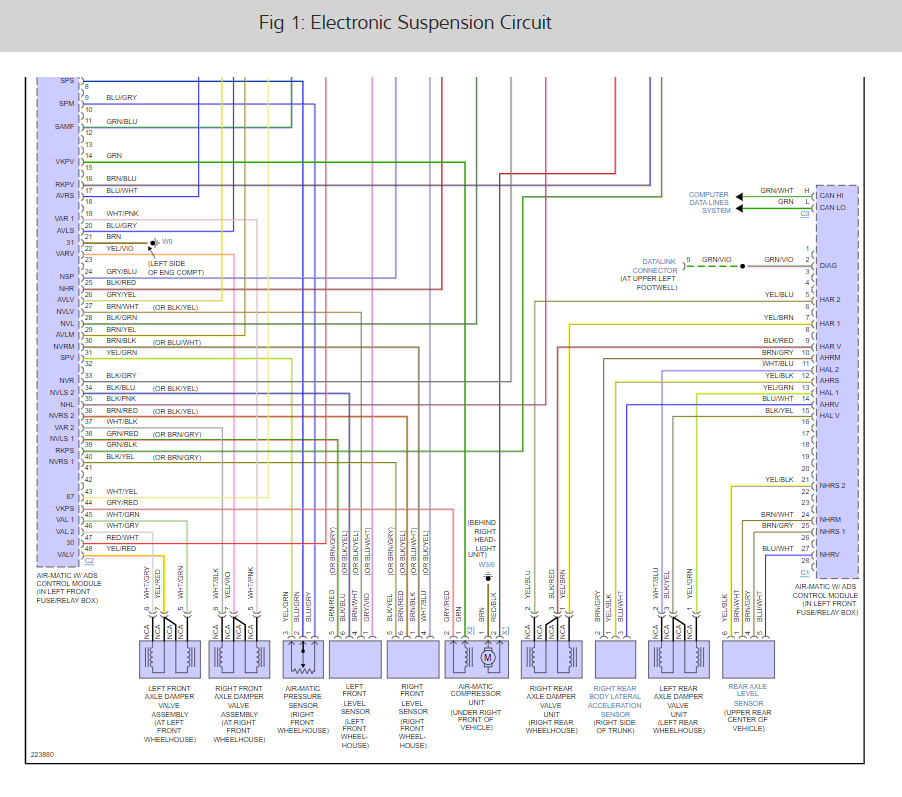

The front right airmatic strut will not inflate. I have replaced the strut and the compressor and air valve block. I have also replaced the height leveling sensor. The strut remains deflated.
Help! Michael
Nov 3, 2022 at 10:24 AM
  • 55,331 POSTS

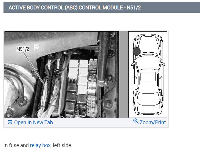

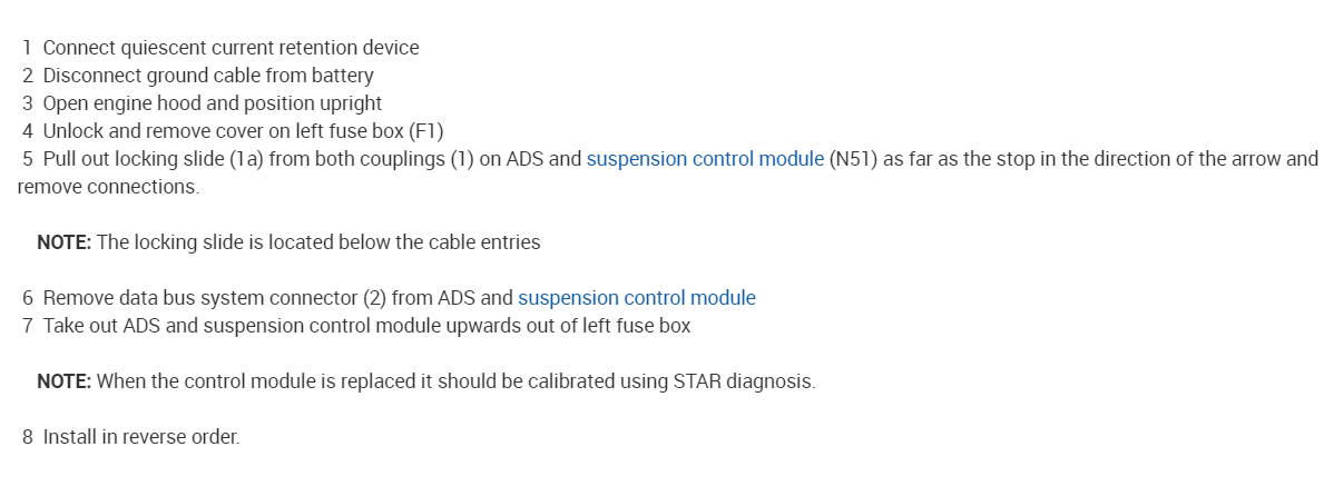

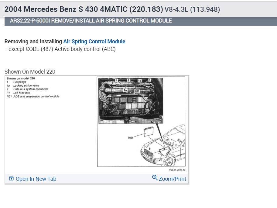

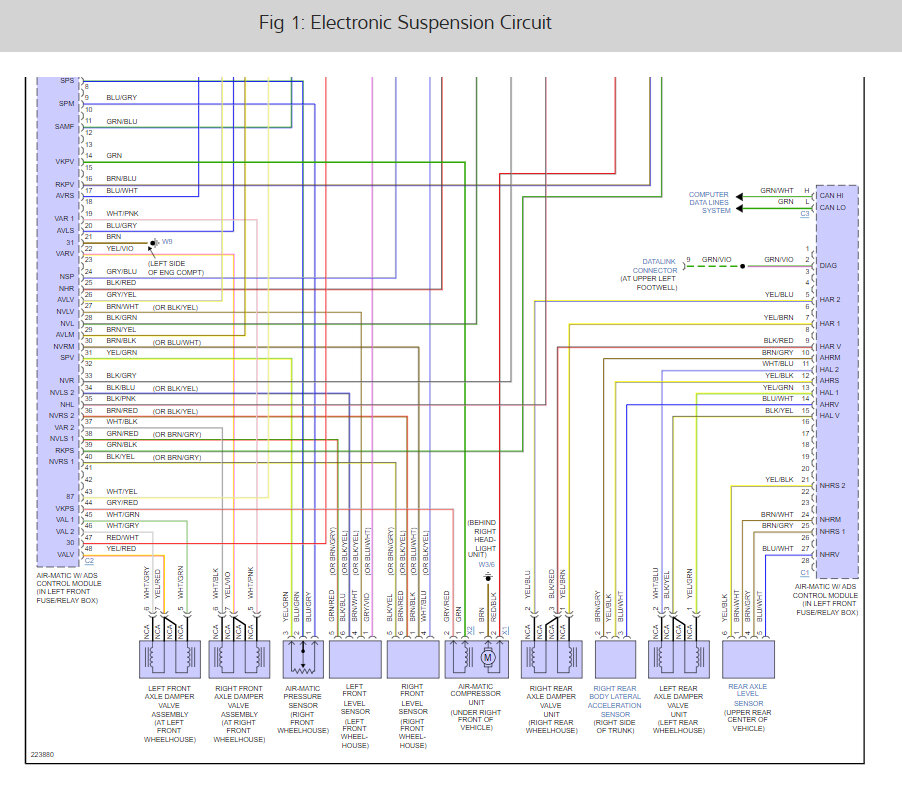

I would check the connection between the strut and the Airmatic control module, here is a guide to help you and the wiring diagrams for the system so you can see how it works and which wires to test. If the connections are good, I suggest replacing the control unit.
I have included the Airmatic control module replacement instructions just in case. Check out the images (below). Let us know what happens and please upload pictures or videos of the problem.

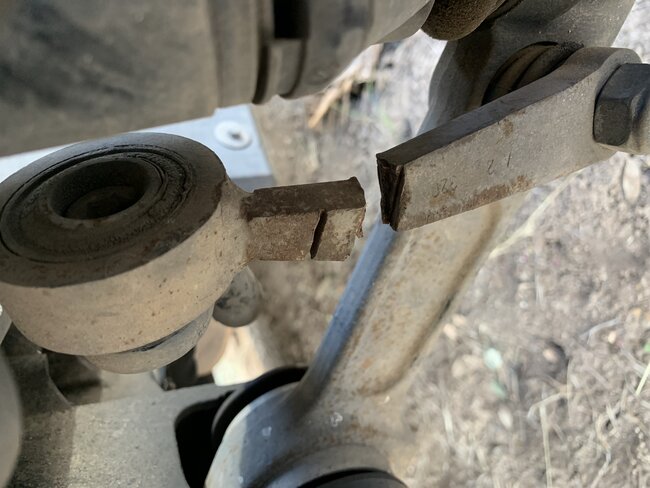

I have found something that might contribute to my situation.
Nov 4, 2022 at 12:03 PM
  • 55,331 POSTS
Wow, I have never seen that, it looks like someone tried to cut it. This will account for the uneven stance of the car, good find.
