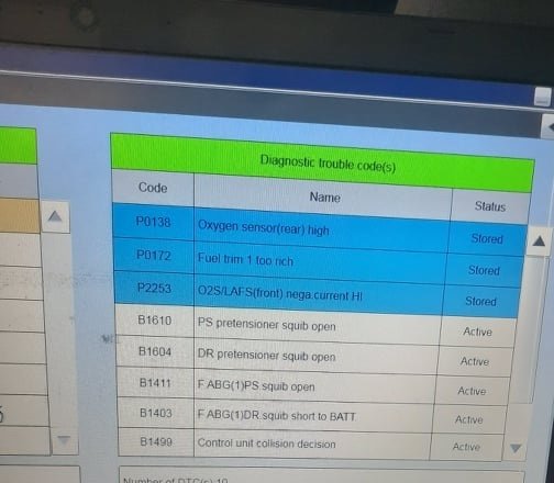

may is ask if the new oxygen sensor installed was defective. as per using diagnostic tool, the status for the following code is "Stored": P0138, P0172, P2253.

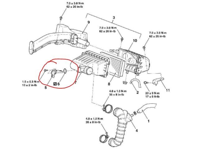

The other 2 codes are related to running rich. The most common issue is the mass air flow sensor.
https://www.2carpros.com/articles/how-a-mass-air-flow-sensor-works-maf
https://www.2carpros.com/articles/how-to-replace-a-mass-air-flow-sensor-maf

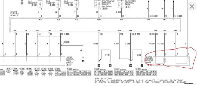

DTC P0138: Heated Oxygen Sensor (rear) Circuit High Voltage
CIRCUIT OPERATION
A voltage corresponding to the oxygen concentration in the exhaust gas is sent to the ECM terminal O2RL from the output terminal of the heated oxygen sensor (rear).
Ground terminal of the heated oxygen sensor (rear) is grounded with ECM terminal ORLE.
The ECM applies an offset voltage of 0.5 volt to ground terminal of the heated oxygen sensor (rear).

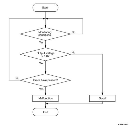

DTC SET CONDITIONS
Logic Flow Chart
Check Conditions
More than 2 seconds have passed since the engine starting sequence was completed.
Heated oxygen sensor offset voltage is between 0.4 and 0.6 volt.
Judgment Criterion
Heated oxygen sensor (rear) output voltage is more than 1.8 volts for 2 seconds.

TROUBLESHOOTING HINTS (The most likely causes for this code to be stored are:)
Short circuit in heated oxygen sensor (rear) output line.
Connector damage.
ECM failed.

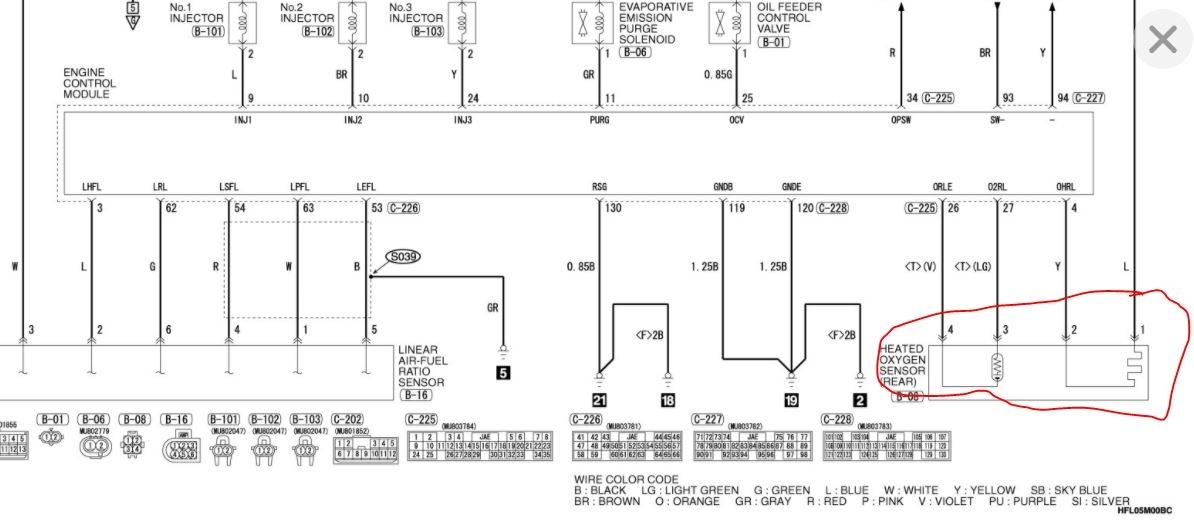

STEP 2. Check of short circuit to power supply in O2RL line between heated oxygen sensor (rear) connector and ECM connector.
Q. Is the harness wire in good condition?
YES Go to Step 3.
NO Repair the connector(s) or wiring harness. Then go to Step 4.

Jan 21, 2021 at 5:28 PM
ELDINE SULIVA MOLINA
  • 6 POSTS

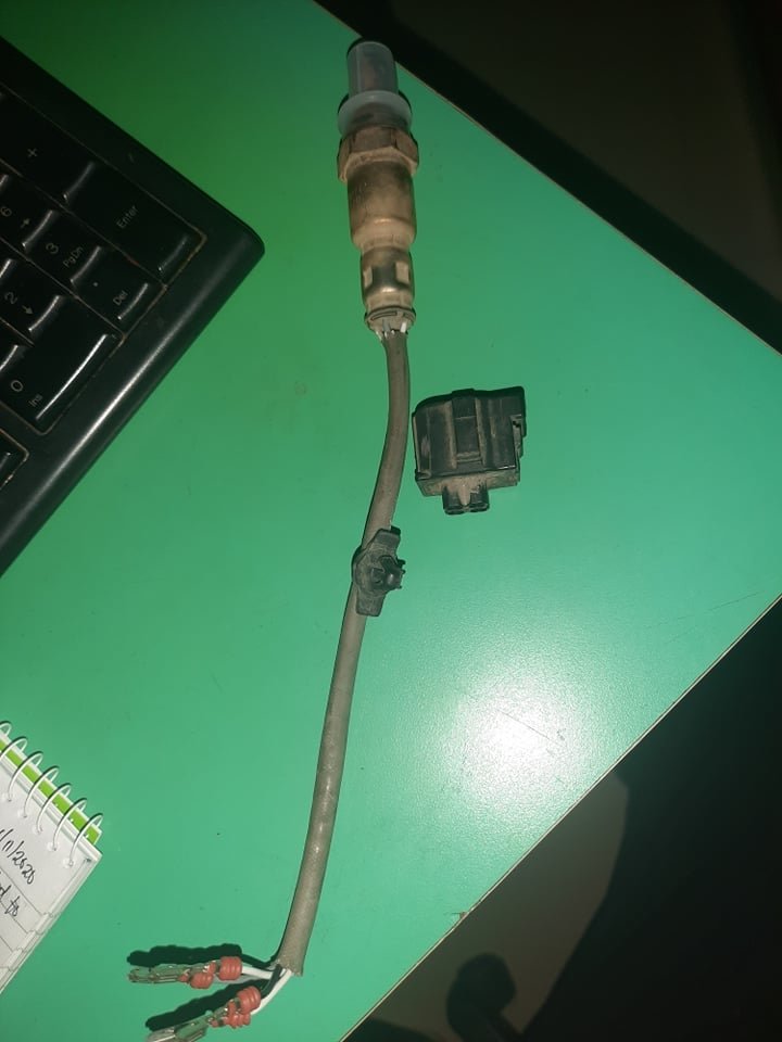

Thanks for this info sir. We don't know if the oxygen sensor was likely the original since we are not able to monitor it while they are replacing the sensor (installed date: October 15, 2020), but the issue returns after several weeks (3rd week of November). As per mechanic (Mitsubishi dealer), they advise us to drain the remaining gas (unleaded) since they spectating that maybe in the fuel line is the problem. also they recommended to replace the existing fuel filter. i was worried since the status of the 3 codes was "stored" and they say that it is okay.
Jan 21, 2021 at 11:44 PM
Stored means inactive. The codes were present and active at one time but now are inactive.
Is the check engine light currently on?
Jan 22, 2021 at 2:54 AM

Yes, currently the check engine light is on, but sometimes, it's off randomly, as per experience of using this car, it jerks when the engine is hot.
Jan 22, 2021 at 4:48 PM
What are the current codes and did you replace the O2 sensor?
Jan 22, 2021 at 5:01 PM
  • 6 POSTS

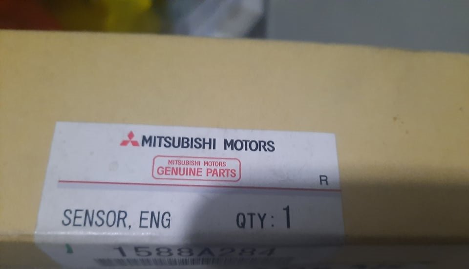

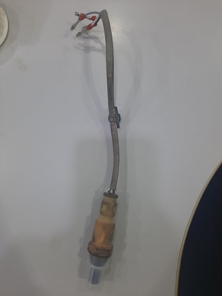

Yes, they replace the oxygen sensor, see the image attached sir for reference.
Jan 22, 2021 at 5:12 PM
Okay, I see the connector is not on the sensor which leads me to believe you had a universal sensor installed. The new sensor should have a connector already attached and ready to the plugin.
The codes are inactive at the moment. You have airbag codes that are active and that is why the light is on. We need to start a new question to address those codes as I can only address one system at a time per question.
Jan 22, 2021 at 5:39 PM
  • 6 POSTS
Sir i just forgot to take the picture, the connector of the oxygen sensor was included on the box. they just removed it from the wires. i will upload another picture with the oxygen sensor and its connector. I was just wondering sir if the newly installed oxygen sensor is defective since the problem is the same before we replace the old one. Thanks Sir!
Jan 22, 2021 at 6:44 PM
With the codes inactive, my opinion is no, the codes are gone at the moment.
Your issue is with the airbag codes for the light.
