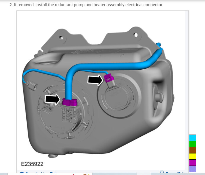

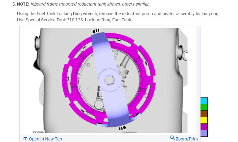

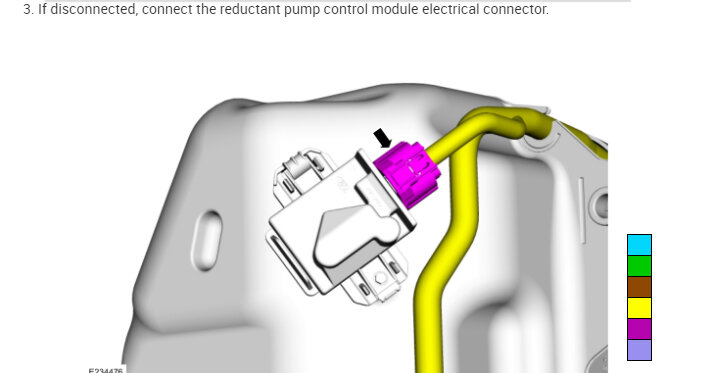

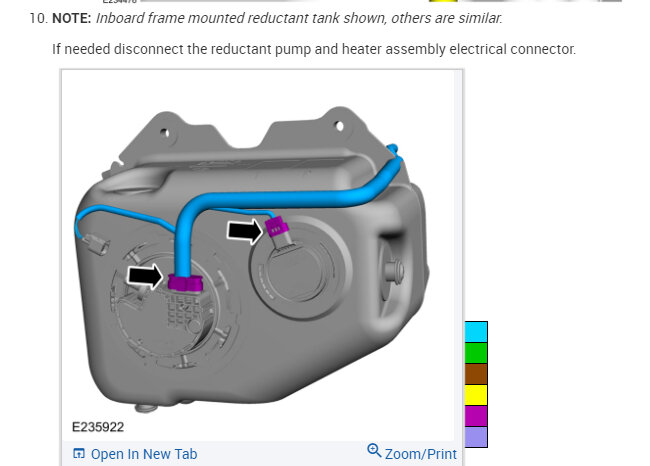

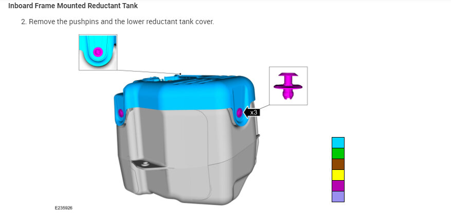

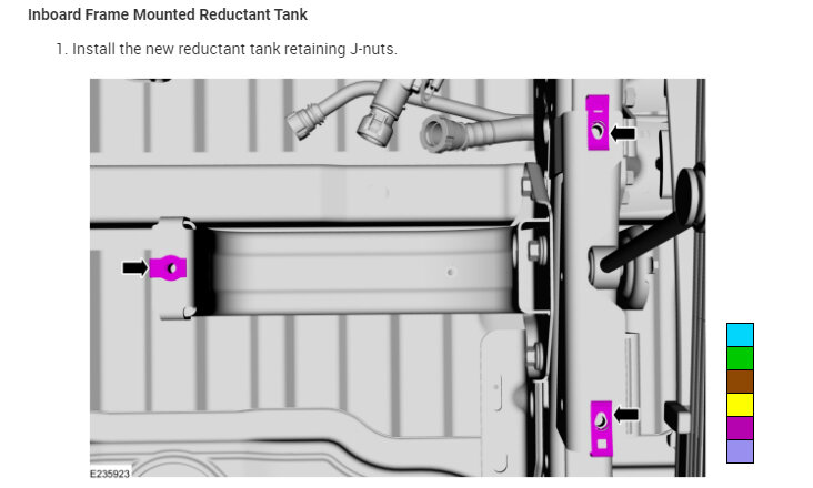

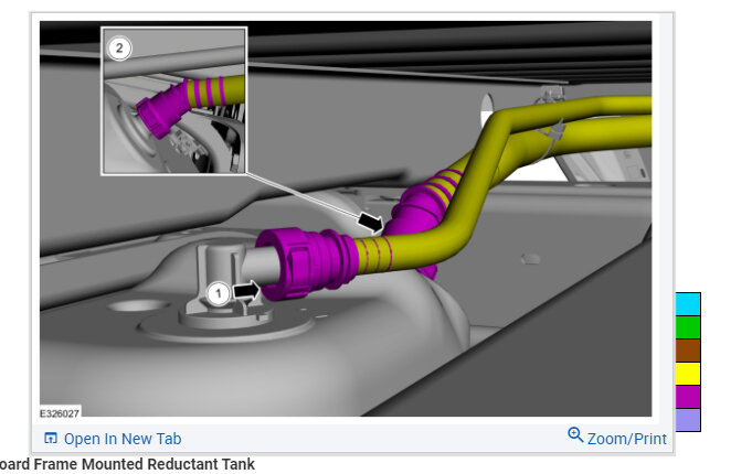

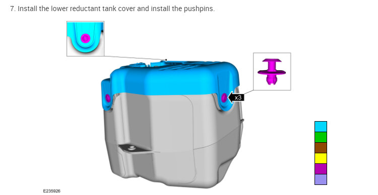

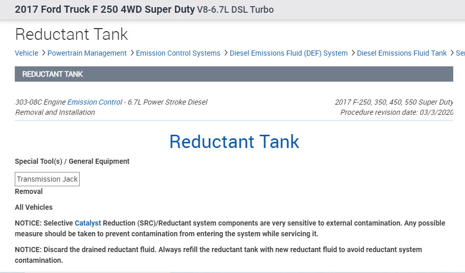

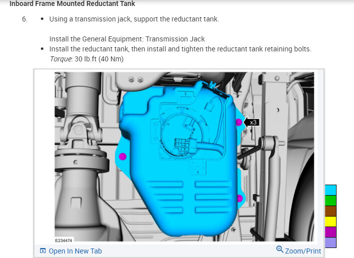

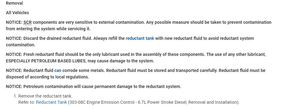

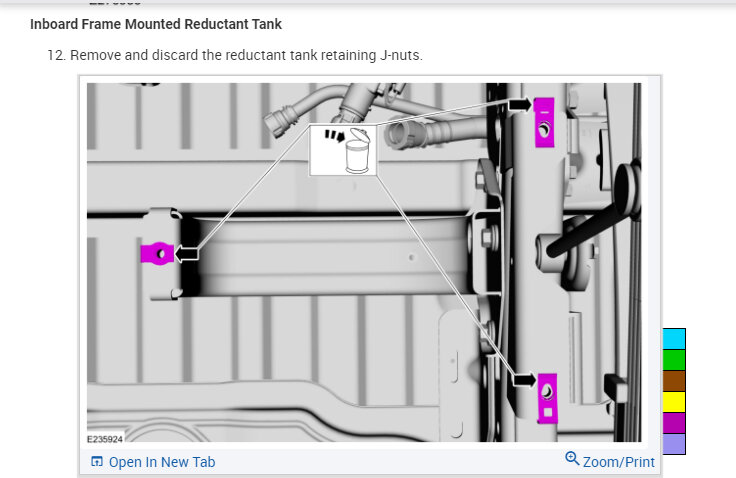

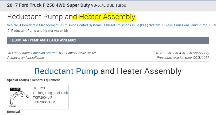

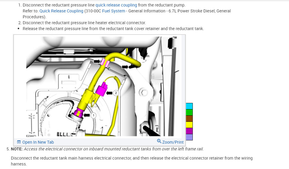

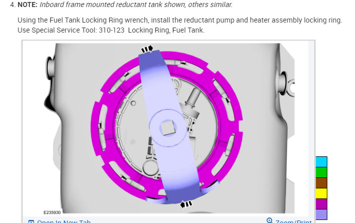

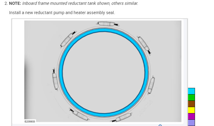

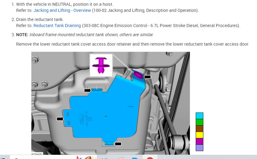

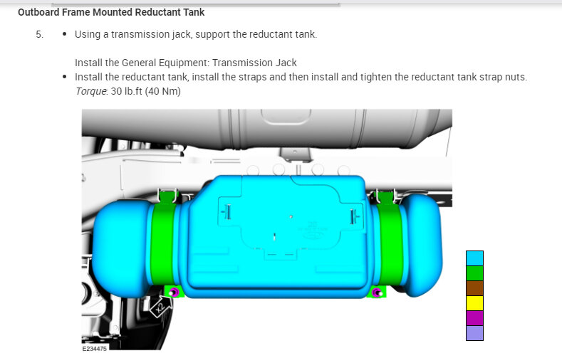

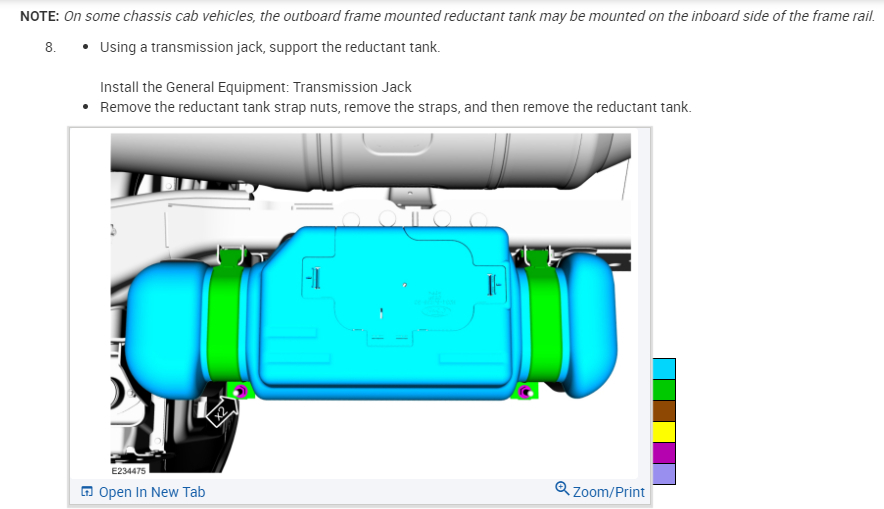

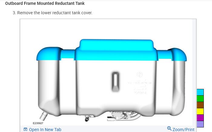

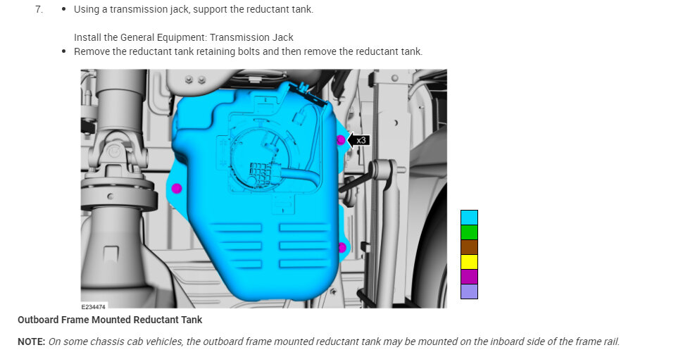

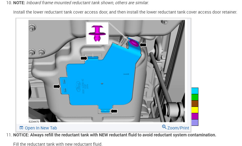

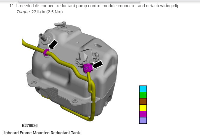

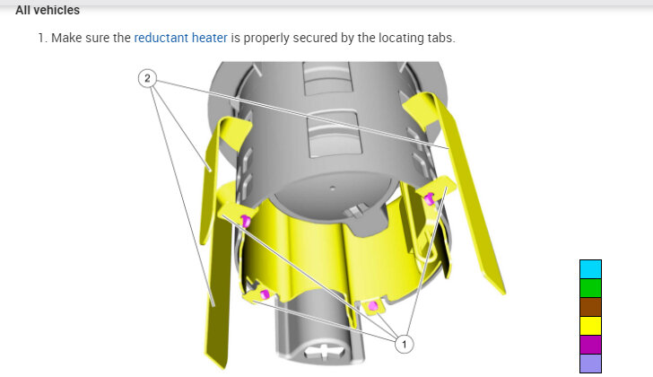

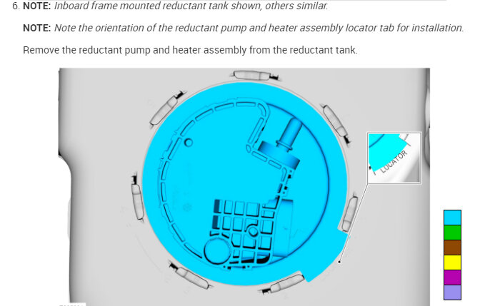

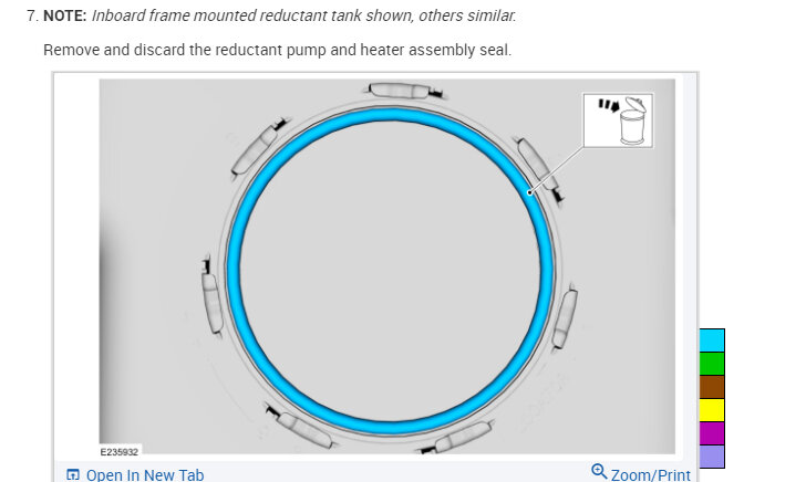

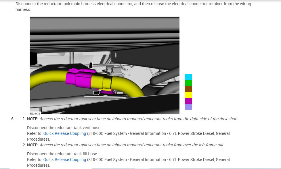

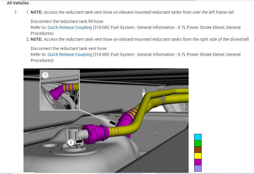

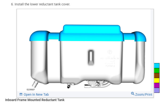

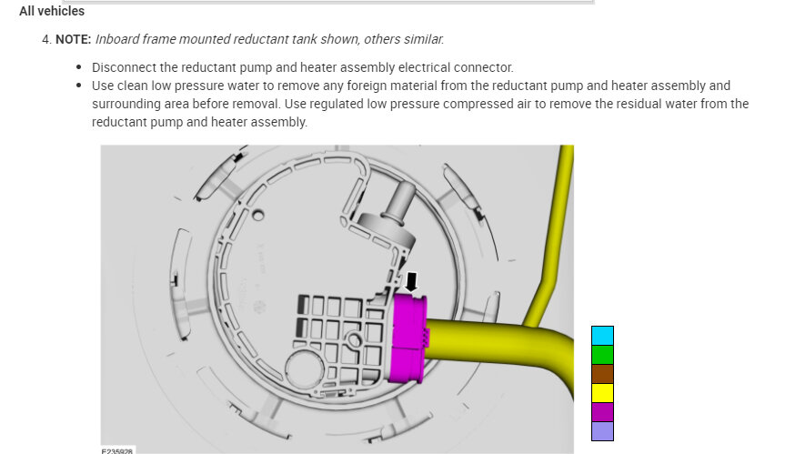

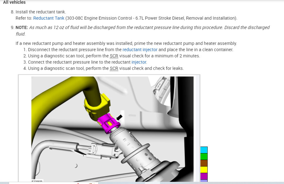

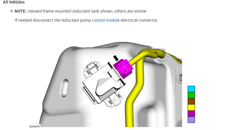

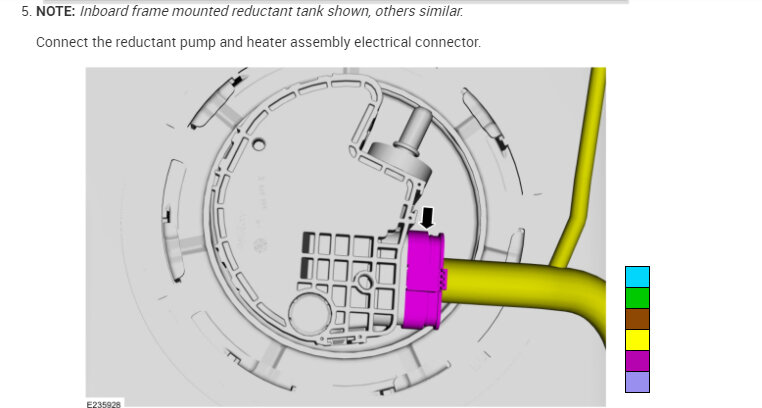

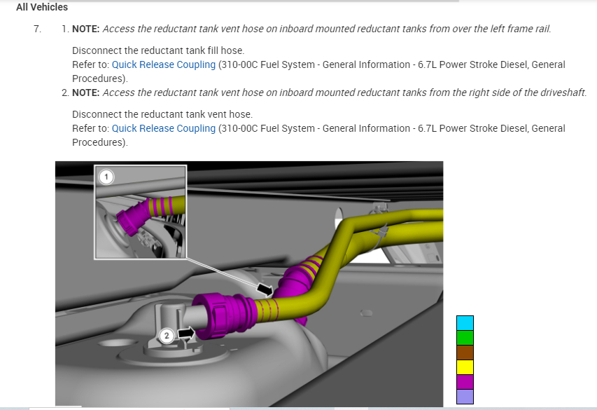

I need guidance on removal of DEF tank and replacement of the DEF heater.
Apr 27, 2023 at 5:19 AM
  • 110,248 POSTS

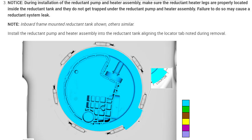

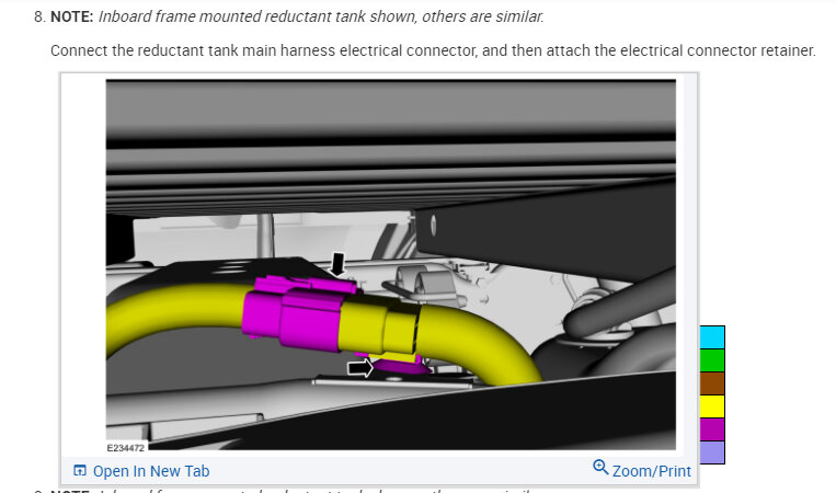

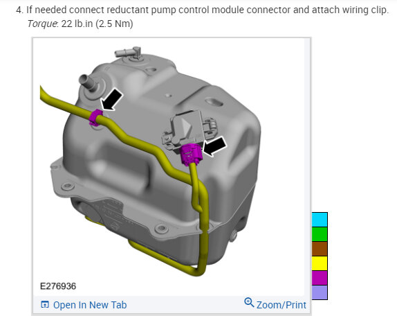

On these vehicles, the tank can be in two places. The directions I attached show both. Some of the steps won't be relevant for you based on what you have.
Also, the heater replacement is also listed. Many of the steps will already have been done by removing the tank.
Take a look through them and let me know if they help.
Take care.,
